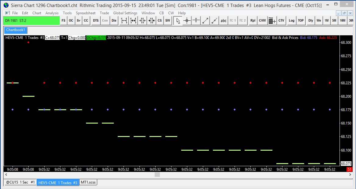

I notice that sometimes in my SC charts the price of the market's "last" closed trade falls outside of the Bid/Ask spread.
For example, in attached screenshot "1.jpg" you'll see that:
-The Ask Price (red dots) is 69.225
-The Bid Price (Blue dots) is 68.175
-The "last" closed trade price (dashes) is 68.075

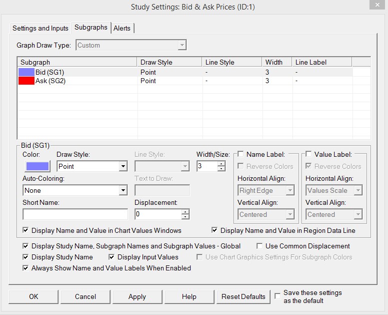

Screenshots "2.jpg" and "3.jpg" show the settings I used to make this chart.
Any idea why this is happening?

Perhaps I'm wrong, but I don't see how it would be possible for a trade to close for a lower price then the best bid price that exists at the time of the trade's closing (which is why I figured this was a technical issue).
Are you saying it is not a technical issue?

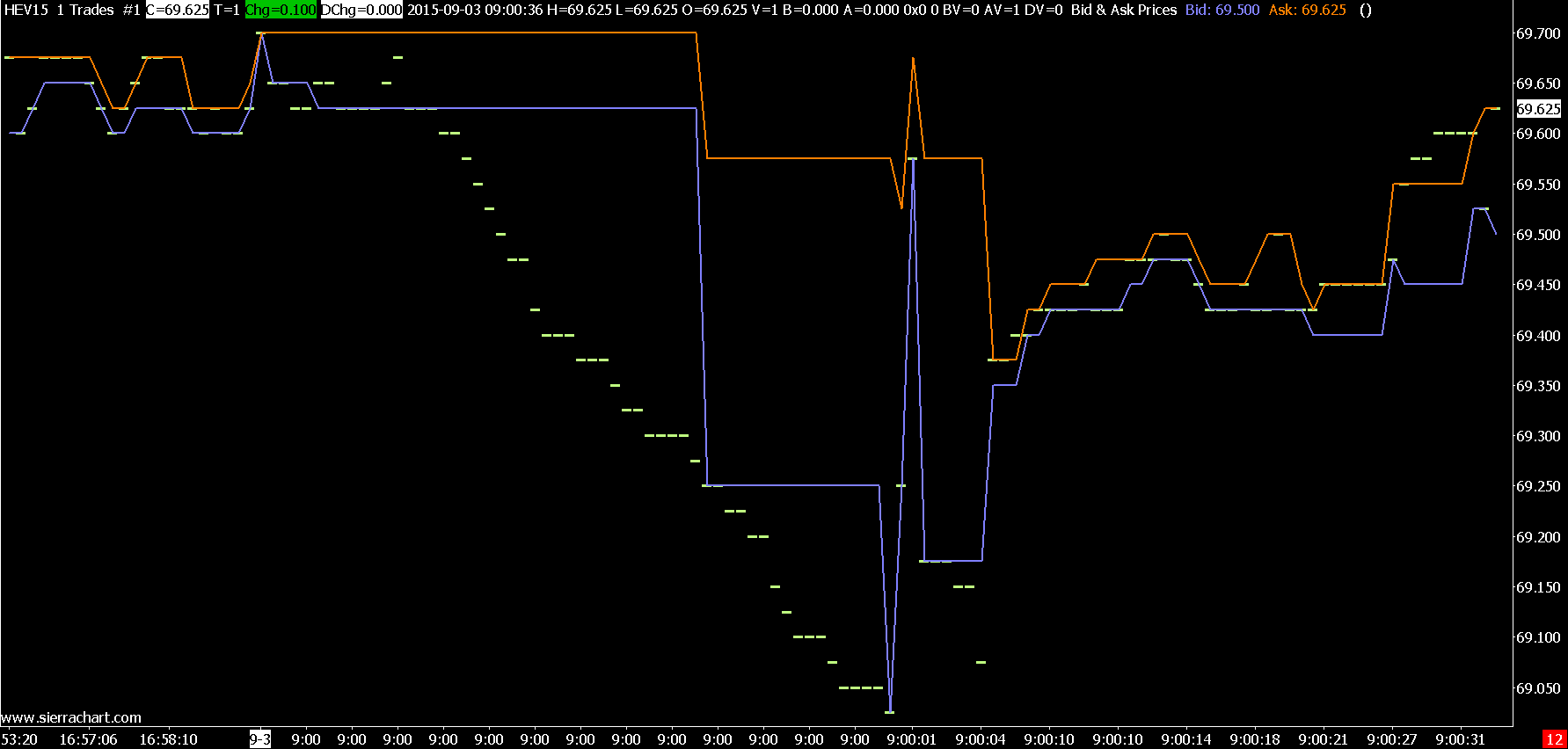

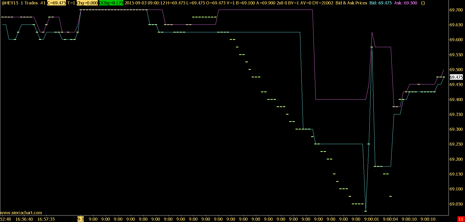

For comparison purposes, we are attaching a chart from IQ Feed for this particular contract:
http://www.sierrachart.com/image.php?l=1442381640233.png
You can see the last trade price in many instances is outside of the bid and ask range.
No need to apologize, we realized you did not know it was a technical issue. It is just that from our perspective, we can get very bogged down chasing after all the different data "issues" that get brought up. We can only focus on the genuine ones that we have control over.

We still see the same thing even with our own processing of the CME FIX Multicast market data feed:
http://www.sierrachart.com/image.php?l=1442635604394.png
While we do not want to speculate on the reason, most likely there is a good reason why we see this. When there is a market order taking out many levels of the bid or ask depth, the new best bid and ask are not transmitted until all of those trades are transmitted first. So this is the result that you get.
The CME should know this.
So why is it that we can give me an answer which is probably correct, and they cannot answer it? Does not make any sense.
