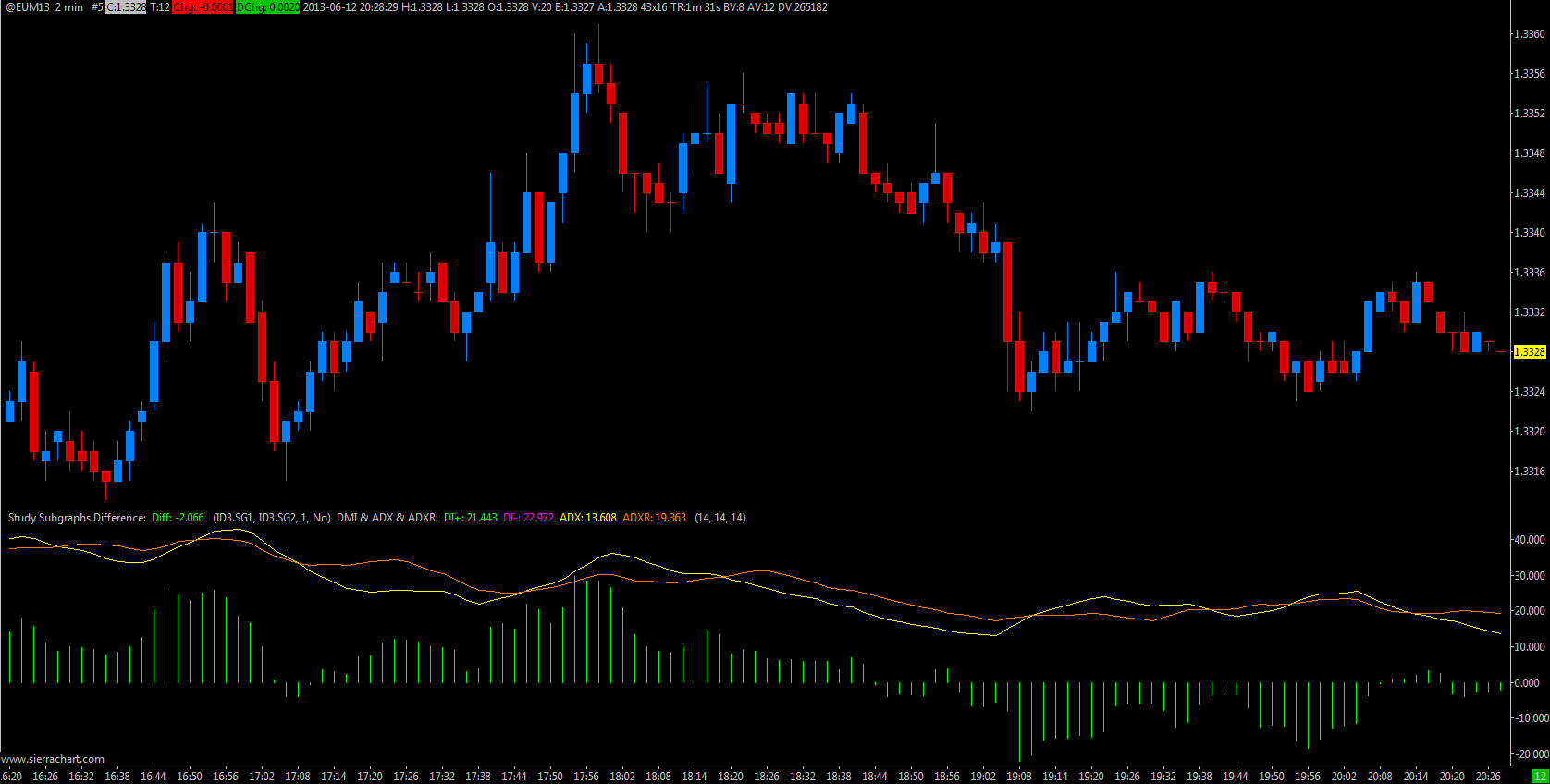

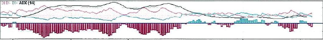

Is it possible to see the DMI or DMI +ADX in histogram, please
imageDMI.JPG / V - Attached On 2013-06-12 18:02:56 UTC - Size: 42.32 KB - 864 views
[2013-06-12 18:10:47]
Yes. This can be done. The histogram is a difference between DI + and DI -.
Use the study Study Subgraphs Difference. Here is the documentation:
http://www.sierrachart.com/index.php?l=doc/doc_TechnicalStudiesReference.html#s185

ok thanks it's done but i can not changed colors like green for DI+ and red for DI-
http://www.sierrachart.com/image.php?l=1371061741204.png
[2013-06-12 19:17:50]
Sawtooth - Posts: 4354
Set the Auto-Coloring to Based on +/-
[2013-06-12 19:35:33]
TradingMarketProfile - Posts: 120
ok it works thanks
