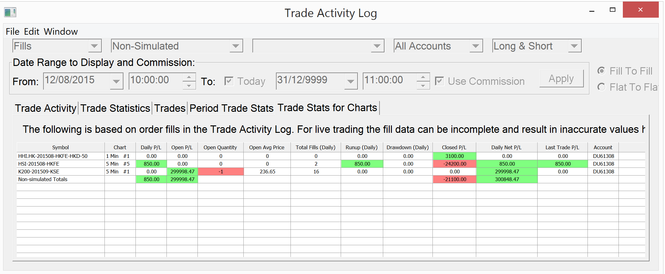

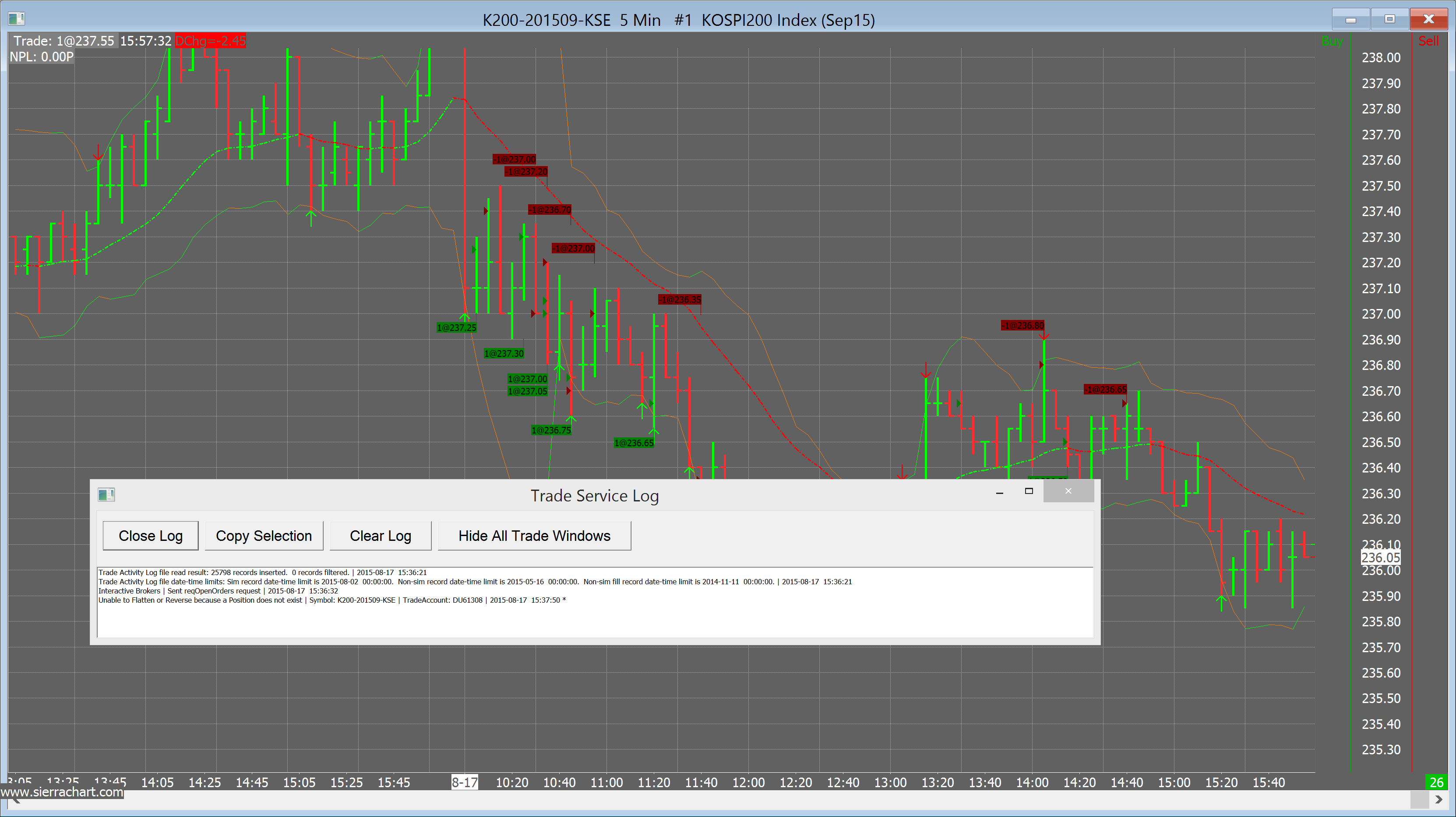

[2015-08-17 06:14:42]
amue - Posts: 8
http://www.sierrachart.com/image.php?l=1439791060828.png
I attached/uploaded 2 images:
a) SC-Desktop with Trade Service Log
b) Trade Activity Log
on the Desktop image you can see that I tried to close a position (K200-201509-KSE) and got an error msg ("Unable to Flatten ...") which is correct, on the IB side there
is no open position
on the Trade Activity Log image you can see that there is still an open short position
imageTradeActivityLog.png / V - Attached On 2015-08-17 06:04:27 UTC - Size: 82.35 KB - 469 views
[2015-08-17 06:46:10]
Where you see the incorrect position is the Trade Stats for Charts tab. Usually that tab will not be reporting correct Position data.
Once again refer to the documentation here about this:
https://www.sierrachart.com/index.php?page=doc/doc_TradeStatusWindows.html#IncorrectlyReportedTradePosition
Specifically refer to step number 6.
Date Time Of Last Edit: 2015-08-17 06:47:05

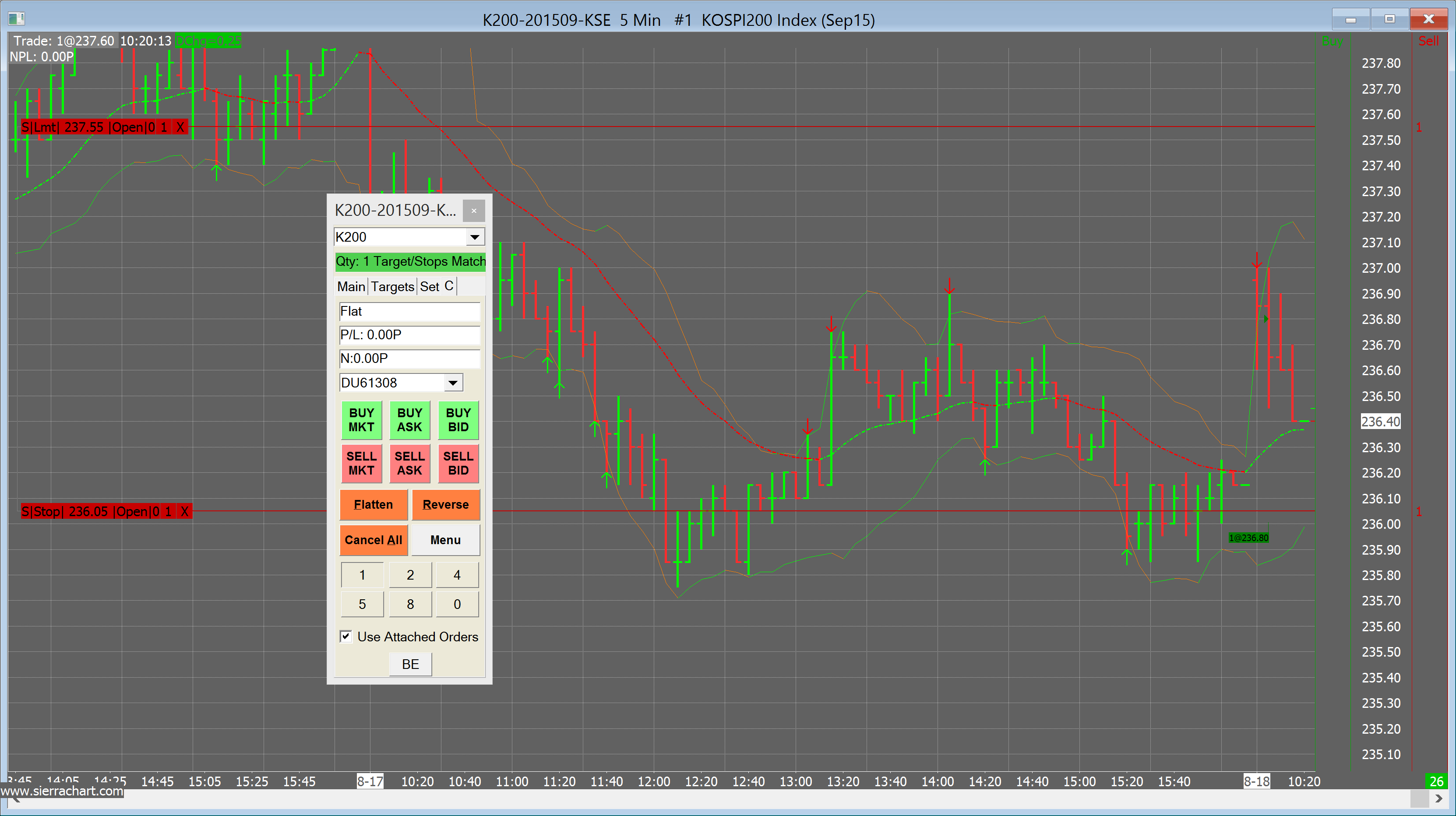

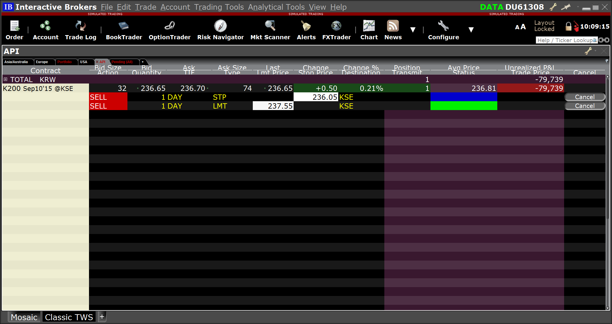

[2015-08-18 00:25:43]
amue - Posts: 8
http://www.sierrachart.com/image.php?l=1439857217234.png
I uploaded/attached 2 files:
a) tws.png which shows an open long K200-201509-KSE position
b) a SC screenshot which shows a stopLoss and a target line but no position line;
the trade windows shows "Flat"
"Orders and Positions" show all 3 orders with the correct status and symbol
imagetws.png / V - Attached On 2015-08-18 00:21:32 UTC - Size: 117.67 KB - 461 views
[2015-08-18 00:45:56]
There is still some detail you are overlooking.
We need to see a screenshot of the Trade >> Trade Orders and Positions >> Positions tab. Something is either not right there or there is some setting that is not correct.
Whatever the problem, it is documented here:
When locating the Trade Position on the Positions tab you must find a match by comparing both the Trade Account and Symbol.

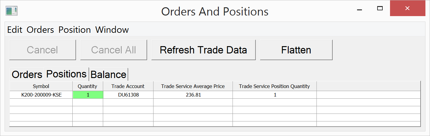

[2015-08-18 01:09:22]
amue - Posts: 8
attached is the "OrdersAndPosition" image
I never used simulated orders and I started up the tws and sc this morning (Australian time); the position you are looking at is the first and only activity so far
imageOrdersAndPositions.png / V - Attached On 2015-08-18 01:04:34 UTC - Size: 24.41 KB - 445 views
[2015-08-18 01:19:56]
Does the symbol look correct? It does not look correct to us. Notice the year is 2000.
[2015-08-18 01:40:14]
amue - Posts: 8
you are right the year is 2000
in my previous email I referred to the Orders tab where the symbol is correct (I wrote of 3 orders) - sorry
is the fact that the year is 2000 prove that the problem is on the IB side?
[2015-08-18 03:33:53]
It is on the Interactive Brokers side and we have communicated this to them:
We have a user trading the following market:
K200-201509-KSE
This is the symbol, expiration, and exchange.
When TWS API sends a position() event, the "expiry" field which should be in the format YYYYMM, is returned as 200009.
So you can see the year is incorrect.
