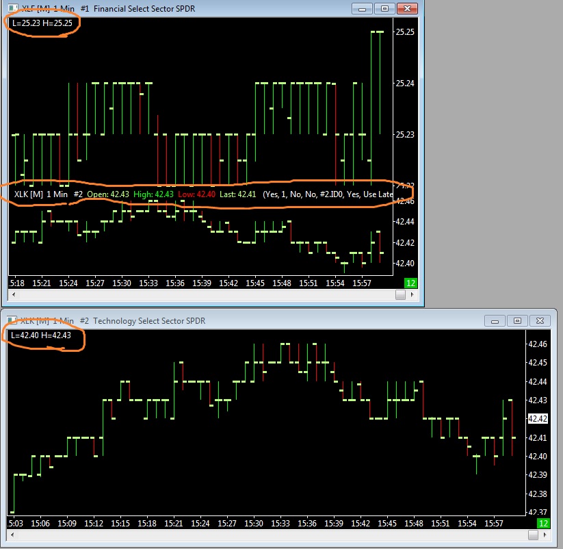

I want the custom name and the removal of all the extra data points to carry over to the overlayed chart. on the single chart of the XLK it shows up correct but not when overlayed to the "Financials" chart
imagesierra.jpg / V - Attached On 2015-08-14 01:45:03 UTC - Size: 58.11 KB - 468 views

The custom Title Bar Name does not copy over with the Study/Price Overlay Study. This is not supported.
For the other question, refer to the documentation here for this:
https://www.sierrachart.com/index.php?page=doc/helpdetails67.html#HidingStudyNamesValuesVWRDL
What do you mean by this:
Please be specific.

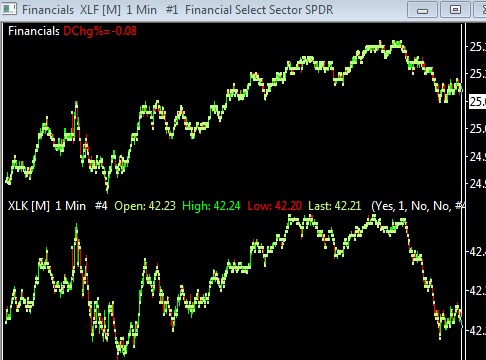

I attached another picture,
In the XLK Chart I did Global Settings --> Custom Chart header, and removed everything except the Hi and Lo. when that chart is then study/price overlayed onto the XLF chart, I still have all those values that i removed from the XLK chart.
does this clarify what im trying to do? id like to get rid of all that extra data in the header for the overlayed chart.
imageuppp.jpg / V - Attached On 2015-08-14 20:33:30 UTC - Size: 151.2 KB - 492 views

What you want to do in post #4 is not supported when overlaying the main price graph from another chart.
We are working on adding this capability but it is not going to be ready until the end of next week.

No not yet. We have a lot of other higher priorities at this time.
We may not get to this for a while yet. We should not have given a time previously.
