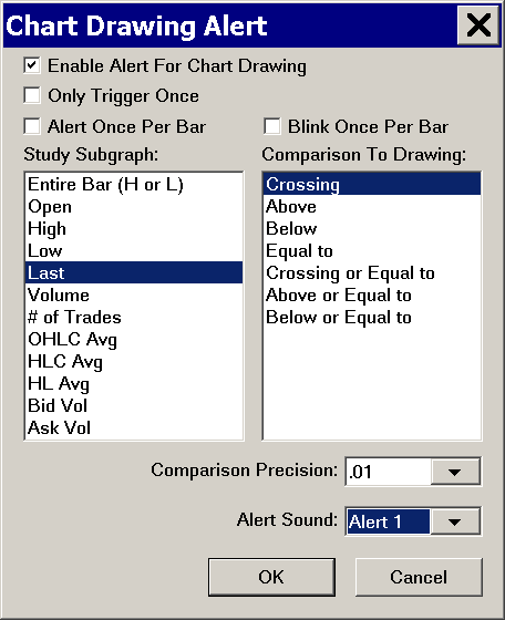

I cannot get the alerts or the change color feature to work.
Eg on a 3 min chart I have an extending rectangle on the 6E future drawn at say 1.0875 to 1.0890.
If price is currently at 1.0870 and then goes up to 1.0876 I would like the rectangle to change color (eg to TC2 as I have set it) and an alert to be fired.
For the alert I have used the subgraph value Last and I have tried each of "crossing", "crossing or equal to" and "equal to" but nothing ever happens.
What am I doing wrong ?
Thanks.
PS this looks an incredibly useful feature if I could ever get it to work

[2015-08-06 11:50:06]
Acro - Posts: 459
I don't quite understand the answer here.
Can I just check per my question above if I have an extending rectangle at 1.98750 to 1.0890 with current price at 1.0870 what type of value alert SYNTAX should I use (the alert is ON - I have enabled it both via right click and alternately by Manage Chart Drawings).
- ie should it be "crossing", "crossing or equal" etc etc.
The alert is active but is not being triggered.
Because it is a rectangle and not a line it is not crystal clear to me the alert formula syntax to be used.
If price is currently under the rectangle and I want to notified when it touches or enters the rectangle I had assumed "crossing or equal to" was the correct syntax.
However, I get confused because crossing could also mean that price has to cross the entire lower and upper boundary to be triggered.
This is not explained clearly in the documentation and I cannot get the alert to trigger.
That is the only reason I am asking the question.
[2015-08-06 17:20:25]
Refer to the attached Chart Drawing Alert settings for this.
Here is an example:
Chart Drawing Alert: XAUUSD 1 Min #32, Rectangle, Last (1090.76) Crossing from above line #5 (1092.15) | Alert: Alert 1
In the case of a rectangle drawing which has a top and bottom, both the top and bottom of the rectangle are checked separately.

[2015-08-16 01:44:38]
Acro - Posts: 459
Thank you.
I have finally figured out why my alerts never work.
It was simply because by default I had my extending rectangles set as DOUBLE EXTEND.
This meant that Sierra believed that the alert criteria had already triggered (in the past) so it would not trigger again.
It's a shame as I prefer the visual appearance of the "band" given by double extend but at least I now know how to trigger a rectangle alert
