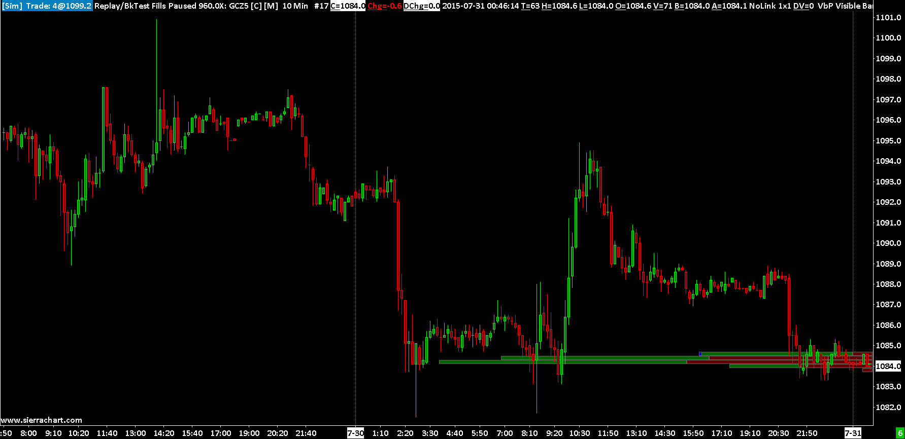

We have tested "From Session Start Time to End" and the Volume Profile is consistently 50% of the Window Width when we set the Maximum Volume Bar Width Type to Window Width and Maximum Volume Bar Width Percentage set to 50.
Here is a chart image:
http://www.sierrachart.com/image.php?l=14383979737.png
Using these settings, do you still see a problem?
