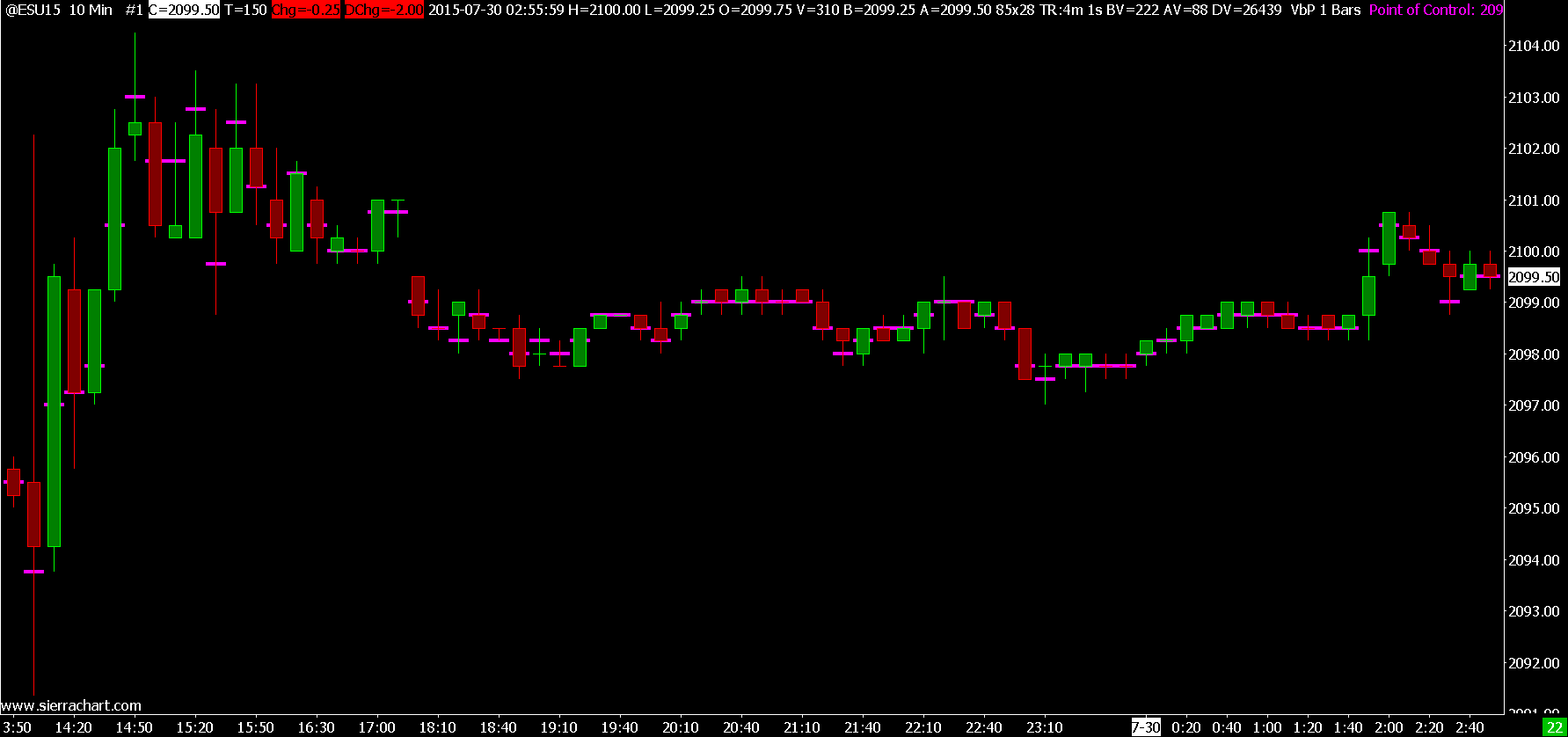

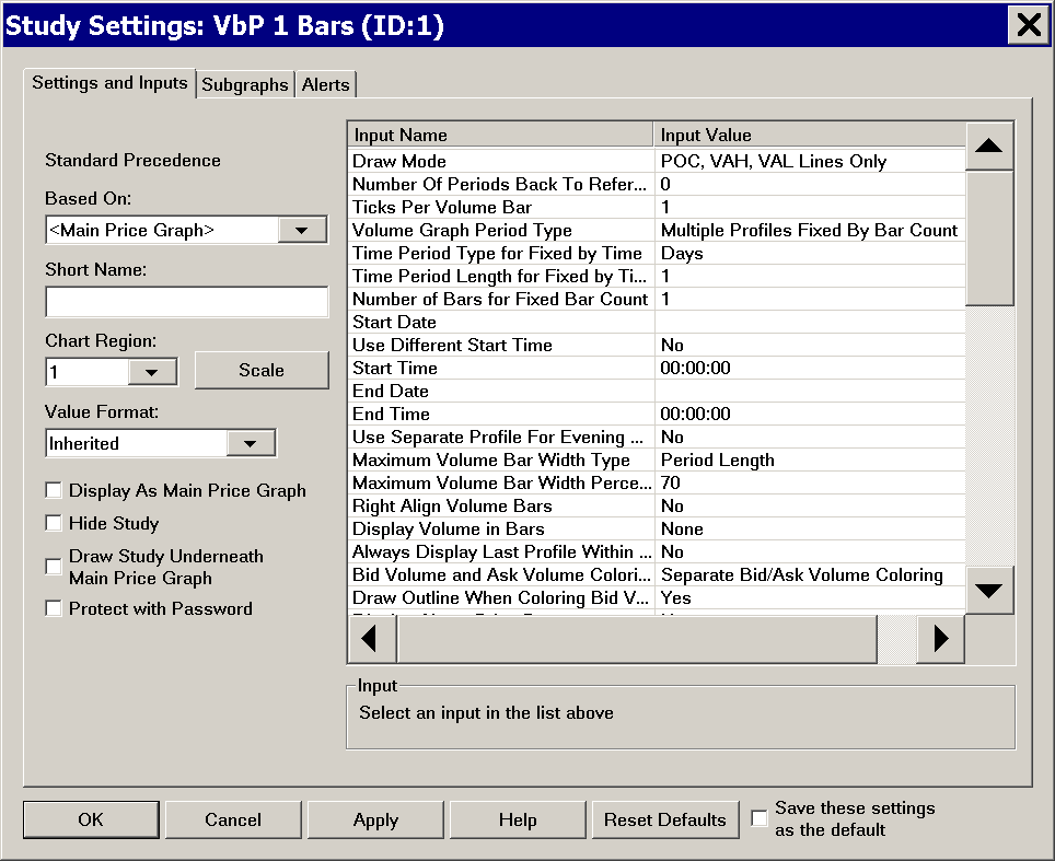

We thought this could not be done with any of the standard studies but it can be with the Volume by Price study.
Here is an image of the chart:
http://www.sierrachart.com/image.php?l=1438239367869.png
Refer to the attachment for the settings.
Only the Point of Control Subgraph is set to be visible and uses a Dash Draw Style.
