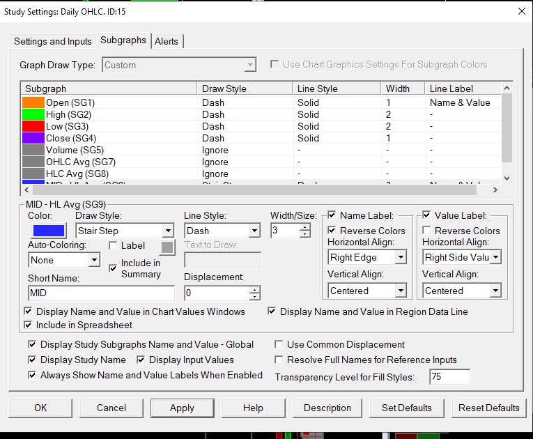

[2021-04-19 17:00:03]
sjk - Posts: 43
Thank you but it is not working. Probably something very simple that I am not doing but I cannot figure it out.
I think I attached a file of the settings.
imageCapture.JPG / V - Attached On 2021-04-19 16:57:27 UTC - Size: 111.77 KB - 413 views
[2021-04-19 18:03:08]
Set the Draw Style to Dash, not Stair Step.
We are assuming that you are not wanting to see the transition lines as it goes from one day to the next.

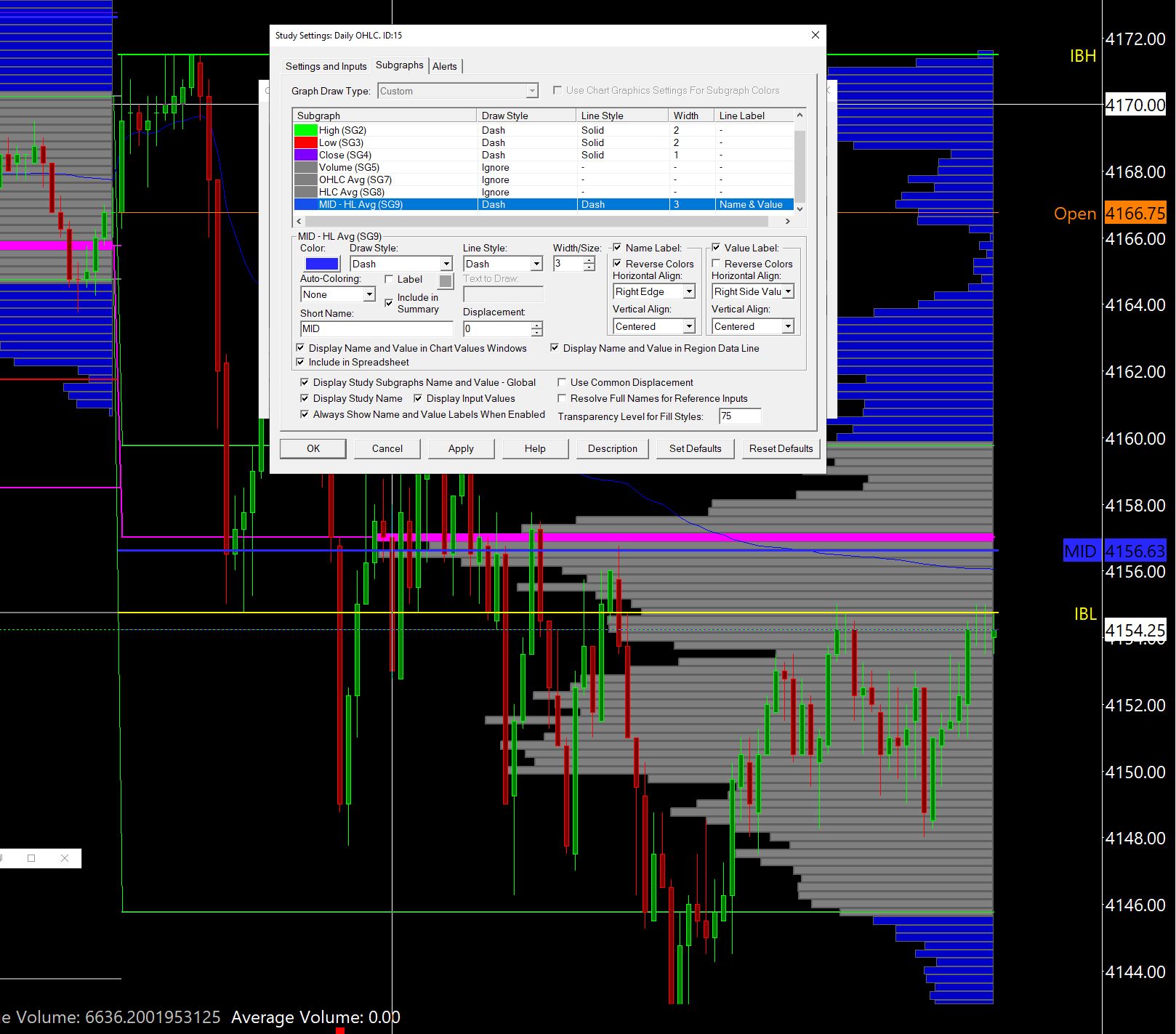

[2021-04-19 18:33:57]
sjk - Posts: 43
Not seeing the transition lines from one day to the next would be ideal. But what matters to me most is being able to examine the day and see where the line was at every time of the day. That is what I cannot seem to achieve. What am I missing?
Thank you again.
imageCapture.JPG / V - Attached On 2021-04-19 18:33:26 UTC - Size: 328.28 KB - 349 views
[2021-04-19 19:30:40]
So you want to see how the lines develop over the course of the day? If that is what you want, then refer to the information for Graph High Low Historically and Graph Open Close Historically in this section:
Daily OHLC: Inputs
[2021-04-19 19:37:46]
sjk - Posts: 43
THANK YOU, THANK YOU. I must not have explained what I wanted to do very well.
