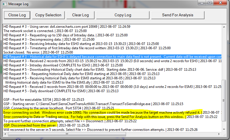

Ronin - Posts: 35
Since the new TransAct version I'm having connection issues (problem connecting at first to the server)
I've checked this issues with them but they don't see any problem on their side
The problem is that I'm able to get updates on the Transact orders DOM but on the event log im getting connection errors
log attached
Thank you
imagesierra connection.PNG / V - Attached On 2013-06-07 08:35:20 UTC - Size: 73.81 KB - 952 views
[2013-06-07 10:04:14]
You simply need to allow the TransAct bridge program access through the firewall on your system. Please refer to this section here:
https://www.sierrachart.com/index.php?l=doc/TransAct.php#BridgeConnectionError
What version of Sierra Chart are you running?

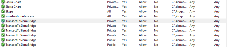

Ronin - Posts: 35
I'm using the latest versions of both - 5.5.1 on TransAct and 984 on Sierra
sometimes it manages to connect but most of the time not. today for example I couldn't connect at all, only after disabling windows firewall
I've added the transact bridge to windows firewall and disabled my anti virus firewall just to make sure but it didnt help , only if I turn Off the firewall it helps.
Do I need to add/edit a rule on win firewall? (see attached)
Trade2day1 - If I enter it the second/third... time its the same - did u change anything?
thank you for ur replies guys

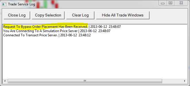

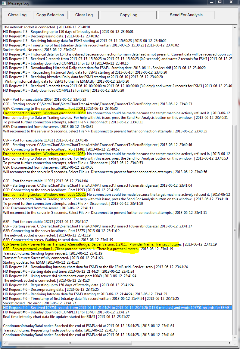

Ronin - Posts: 35
Yesterday I updated to the newest versions (5.5.3 and 985) but the problem still exists
Its the same as before , if I leave it open to try to reconnect it manages to do so after several attempts , same for the old version - after several attempts Its connecting
please see attached logs
what does "Request to bypass order placement has been received" mean?
Date Time Of Last Edit: 2013-06-12 20:51:25

[2013-06-12 23:37:26]
We have reported this issue to TransAct.

[2013-06-17 07:47:41]
Ronin - Posts: 35
No change on 5.5.4 & 988 as well...
[2013-06-17 08:06:58]
If you are still receiving error code 10061 when connecting to TransAct, then this is going to be due to a firewall on your system.
If you are running any firewall program other than the Windows firewall, we recommend uninstalling it. In our experiencing disabling them sometimes does not help and they will still block the connection. This is why they need to be uninstalled.
In the latest version the Windows firewall should not be blocking the connection.
Date Time Of Last Edit: 2013-06-17 08:08:46
