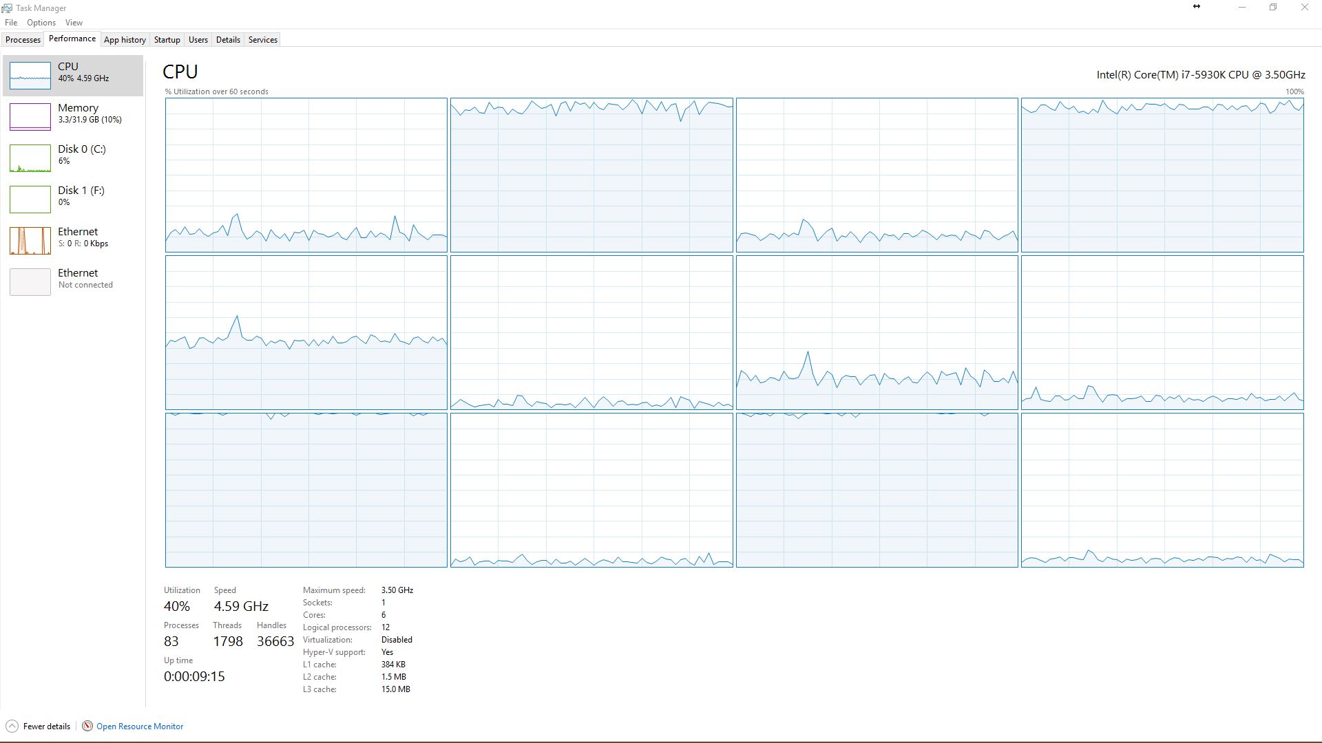

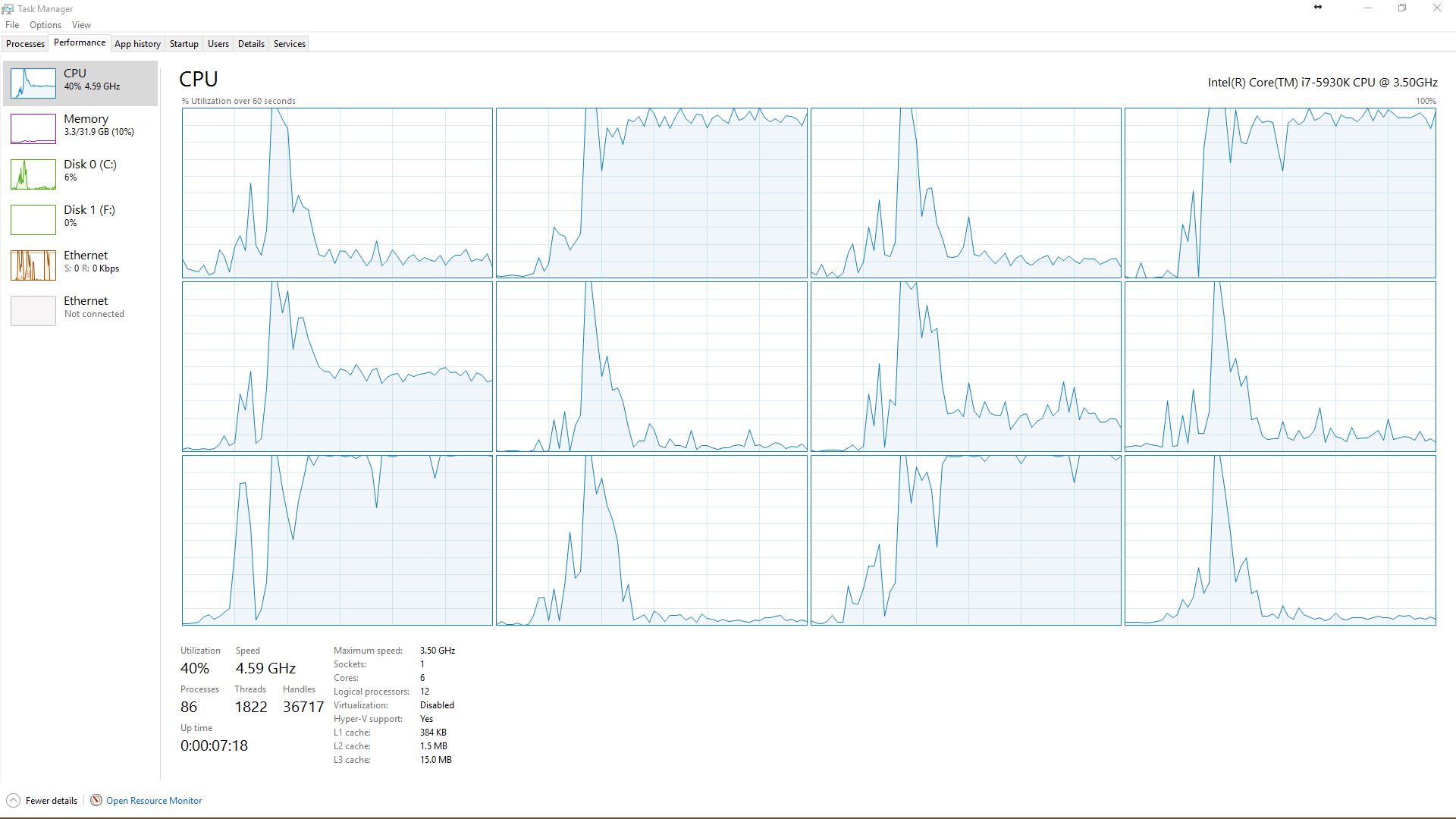

Hi all,
Since I commented earlier and I was looking to upgrade my trading computer, I thought I can put in my 2 cents now - as I just replaced my old (Intel Core 2 Quad Q6700 based) trading computer with a new computer. Key specifications are as follows:
CPU: Intel Core i7-5930K 3.5GHz overclocked to 4.6GHz
Cooling: Corsair H100i GTX liquid CPU cooler
RAM: 32GB of DDR4-2133
SSD: Samsung 850 EVO 1 TB
Sierra Chart instances: 4 instances are loaded together with an IB trading platform (I am using the 1392 pre-release version of Sierra Chart)
Takeaway:
1. The overclocking helps a little and noticeably slightly faster chart loading vs. no overclocking.
2. In an ideal condition, with an ambient temperature about 21°C and with some tweaking of the fan speed profiles, etc., the CPU would briefly spikes up to about 75°C and then settles down at around 61°C.
3. As per the attached screen shot of CPU loading at "launch" of all 4 instances, all 6 cores (the other 6 cores are virtual cores - which is why there are 12 charts) are max out for about a minute while the charts loads (chart is of 1 minute interval).
4. As per the attached screen shot of CPU loading when "running" normally of all 4 instances, 2 cores were almost at zero load, 1 core at about 15-20% load (browser?), 1 core at 50% (probably IB platform?), and finally 2 cores at close to max out at 100%.
Comment for Sierra Chart engineering:
If you are ever going to make Sierra Chart work with multiple cores, please spread out the loading a bit if you can so the cores operating are not constantly maxed out at close to 100%. Just a thought and not a requirement.
image20160402 Computer load at chart running 1.JPG / V - Attached On 2016-04-03 03:36:32 UTC - Size: 198.65 KB - 982 views
image20160402 Computer load at chart launch 1.JPG / V - Attached On 2016-04-03 03:37:12 UTC - Size: 216.07 KB - 1118 views
[2016-04-03 07:43:26]
