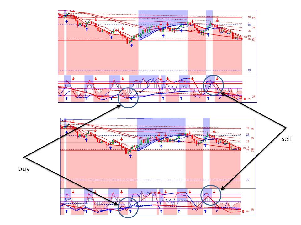

[2013-06-14 16:47:02]
teowinner - Posts: 16
Hi guys,
I had been trading with Infinity future for more than 5 years and had been using sierra charts until now....I am using a different account to post.
I want to bring out one saying " a good mechanic can tune up a F1 formula car but he cannot be good on the race track, that is why only F1 driver will able to and they can tell u what problem they face when trial run on the track...."
I want to show u guys the great differences from using the circular vs the normal. The unnecessary noise being clean out showing a true value line and accurate cross overs for entries and exits.
It also clearly identify the trend above or below and sideway market during that period of time.
Just for illustration, see the arrow on the 2 chart, does it tell u something when 3 lines cross over!! confirm up or down movement 100% no question ask..
There are 4 time frames being overlay onto the lowest for entry and exit in this chart.
I would like you guys to help add in the "RECALCULATE" option on the Overlay/price study at interval of 1 min automatically .
Hope this can be solved at your earliest convenience and thanks!
imagecircularvsnormal.jpg / V - Attached On 2013-06-14 16:46:40 UTC - Size: 96.98 KB - 1044 views
[2013-06-14 18:09:52]
There is no chance ever we would add this option. It would create too much of a CPU load, cause problems and it would only be trying to support something which is technically correct.
This is exactly the kind of thing that we will stay away from. It only creates problems for us.

[2013-06-16 03:57:30]
hi Trade2day1,
I had created the keyboard shortcut keys and right click shortcut to refresh this "Recalculate".....
try imagine you click it every 1 min while you is actively trading at market opens, can you concentrate??
This signal is very very important to entry and exit at the right moment without any lag when using this setup, this is the differences if you use the standard setup, lags 1-2 bars....price had moved already...see the attached last put up highlight in circle....
