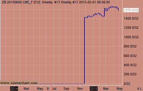

[2015-05-02 23:19:05]
MMX - Posts: 123
Here's the image of the 30 Year.
http://www.sierrachart.com/image.php?l=1430606197931.png
Up until yesterday I had no idea the look back period was limited to 5 years. FWIW, I did enjoy comparing the 2008 collapse in Crude to the 2014 collapse (good thing I looked at it in Dec), but the small enjoyment IS NOT worth a 48% increase in my monthly bill. Personally, I think it was real chickensh** for you to limit things to 5 years, even if it is something that might affect me only once every year or two. Just a paying customer here giving you some feedback, you all do want feedback, right?
In all of the years I've been with Sierra I've never hit the download limit, I knew one was in place to limit excessive downloads, but it never affected me. Has that number been recently lowered as well? What is the limit?
[2015-05-03 00:24:28]
This simply is not making sense because if you are re-downloading the data the data should be correct. We do not see a problem:
http://www.sierrachart.com/image.php?l=1430612288494.png
We will contact you on Monday to look into the problem. We tried calling now but the connection was not good.
Because we have increased the download limit per day on your account, to 1600 you really should not have hit the limit with the few symbols you are working with. Your account now also has access to 10 year Continuous Futures Contract charts.
One of the main reasons for the limit, is because there are a lot of download requests to create continuous futures contract charts, and if we allow too many requests per symbol, it can cause the user to hit the daily limit too soon just because they use an excessive number of years. In our experience, users sometimes will use very large numbers like 30 years which makes a lot of unnecessary requests and cause them to hit the daily download limit for no reason. We have to pay for these queries from a third-party database. They are not free. Nevertheless, we will look into increasing the limits. We know the limits are not a perfect solution, but generally they are not a problem.
Also thinking about this some more, if you are using another copy of Sierra Chart, that has its own new limit for the day. Which would double the number of queries. So we are not even sure the limit has anything to do with this. In so many cases, when there are problems like these and we contact the user and we re-download the data ourselves following the proper procedure, the problem is gone. We can look into this tomorrow as well.
Date Time Of Last Edit: 2015-05-03 00:27:48

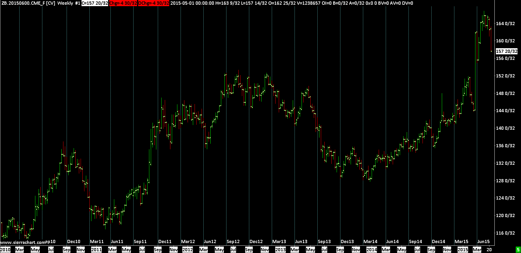

[2015-05-03 16:51:55]
MMX - Posts: 123
All Continuous Weekly contracts are now displaying properly for the time period I care about. I just copied the properly performing files of TF, NQ, and ZB from the second copy of Sierra and pasted them into the Data folder of the first copy of Sierra. The "multiplier distortion" is still there, but instead of starting in Oct 2014 it's now located at the end of 2009 for the TF and ZB and Mar 2012 for NQ. All 3 of these charts were downloaded with 2000 in the Days To Load box, and NQ chose to stop in 2012 rather than 2009, which is fine with me, I'm only displaying 2 years of data in all of my weekly charts anyway.
It was not a limit problem that was causing yesterday's totally blank NQ chart, it was choosing the wrong Edit command. All day yesterday and this morning as well I was using the Edit/Delete All Data And Download command in my attempts to get NQ to populate the chart, ending in failure every time. Then I tried Edit/Download Data - Historical Chart
and it populated instantly.
There is a good thing that came out of this, because of your posting about limits I did some reading yesterday in Sierra Help and learned that I need to delete about 90% of my Data folder (it's embarrassingly huge) and I'm going to stop loading up 3 or 4 Chartbooks that have 30 to 40 charts each (long story) at start-up.

[2015-05-03 22:01:04]
MMX - Posts: 123
I just now went to my second copy of Sierra, deleted all of the NQ files, created a new NQ file, put 2000 in the Days To Load box (just like I did this morning) and now the NQ weekly is exactly like the other 4, starting in Dec 09.
I appreciate the remote assistance offer but there's really no point in it. Two weeks from now when the package 5 trial runs out (I'm going to stay with package 3), the 5 year limit is going to have my weekly charts beginning in May 2010, this is 6 months past the Dec 09 mismatched pricing point of TF, NQ, and ZB.
