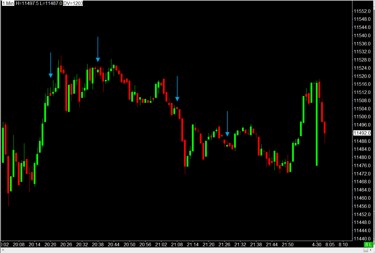

After download the current version 1251(before 1241) sometimes I get wrong colors for the outlines
imageCandle Colors.png / V - Attached On 2015-04-30 06:23:29 UTC - Size: 29.09 KB - 574 views

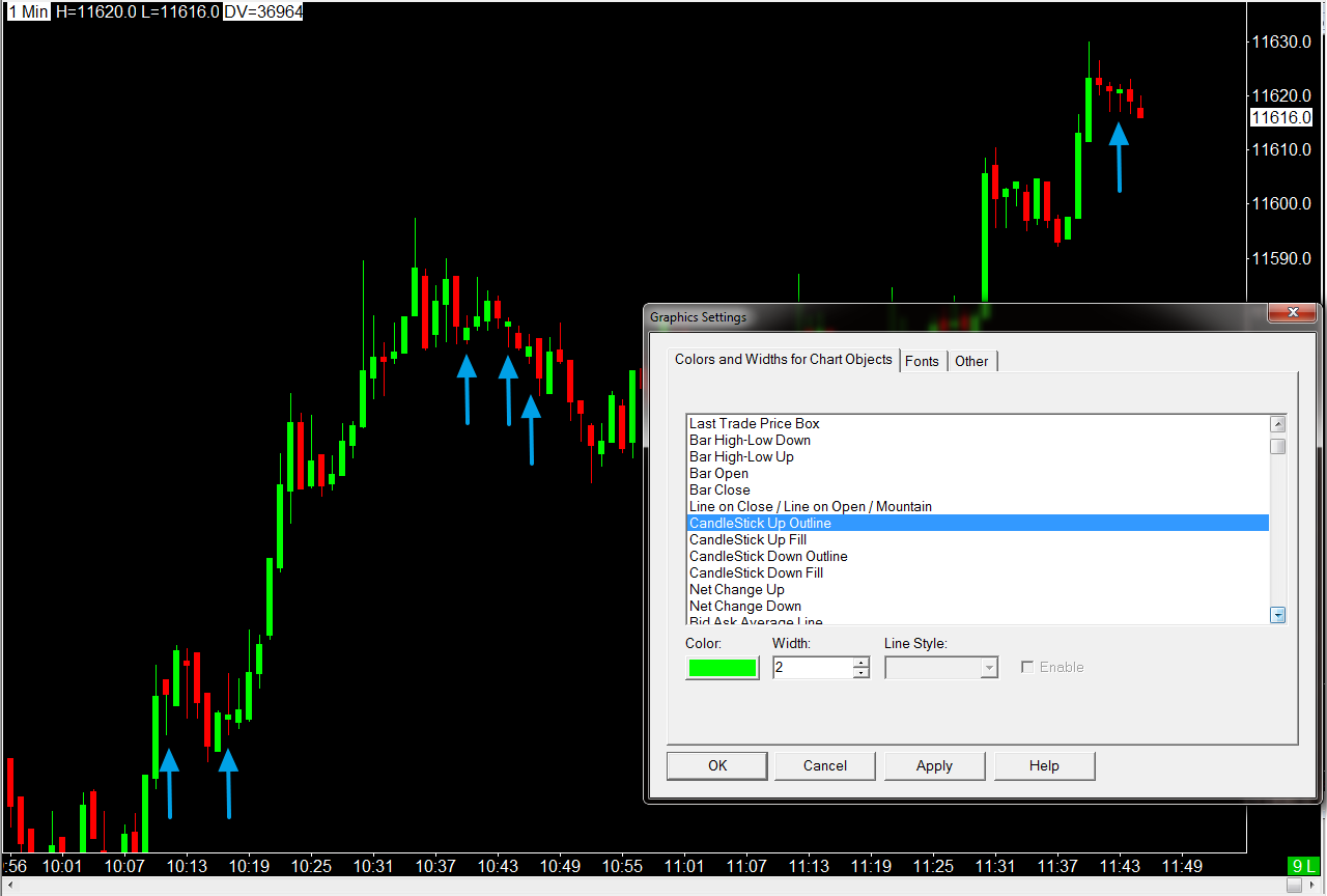

I didn't change anything in the graphics setting and how (or where) is it possible that some candles are with different colors and lot of others are correct. I can't imagine that there is a way for a setup like this.

You need to enable this option in Global Settings >> Graphics Settings:
Color Candlestick High-Low Using the Outline Colors

First question: How to set enable?
As you can see in the attached file the color for "CandleStick Up Outline" is set on "green" but some of up/ bullish candles in the chart have a red outline. The outlines are not permanent red or green.
I am astonished about the fact that the colors of the outlines are only sometimes wrong.
imageCandle Colors example II.png / V - Attached On 2015-05-04 09:50:13 UTC - Size: 55.76 KB - 471 views

This option is on the "Other" tab of the Graphics Settings window.
