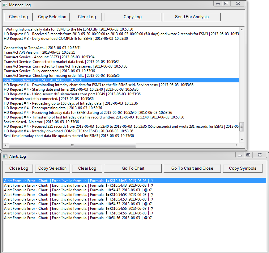

I'm having issues sometimes after duplicating some charts and trying to move their tabs to a different position (if I duplicate a chart for example its being first located at the most right side of the charts tabs, I want to move it to a different desired location) - what I noticed is that u have some kind of a bug that sometimes if I move the tab to a different position the tab that is being located at the most left - its name is being changed to the name of the tab that I was trying to move.
every time it happened I exited the software without saving it on purpose - I was afraid that it might affect it
then after re entering the software it was ok
This time I did save the chartbook, after re entering the software all of my graphs on that chartbook were gone!!
How do I recover the graphs?? I've spend huge amount of hours planning them, Please advise how to solve it
Thanks.
Msg & alert logs are attached
imagesierra.PNG / V - Attached On 2013-06-03 08:08:54 UTC - Size: 75.03 KB - 986 views

Fortunately I was able to recover a less updated file of the same chartbook , I was using the software Recuva to recover the file - I deeply recommend using it to try recover the corrupt/edited files
What I noticed about the symptoms of this bug is that if u duplicate a chart and then change its bar period to a different one such as reversal/rekno etc. and then try to move its tab to the left side (not necessarily the most left one) it wont move it and wont activate the red mark of the tab location and also might change the first (most left) tab to this current tab - and when this happens it corrupts its chartbook.
