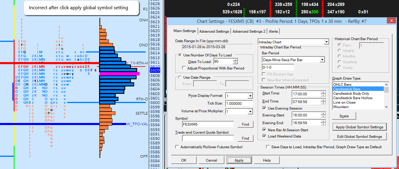

I'm currently in Brisbane time zone - GMT +10 and trading Eurex product.
Today is Europe Daylight saving time begin. When I adjust my session time start from 18:00 to 17:00, the historical intraday chart all changed and it show incorrectly.

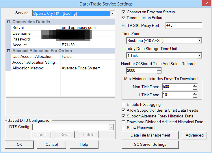

My Data/Trade Service Settings I choice Brisbane +10

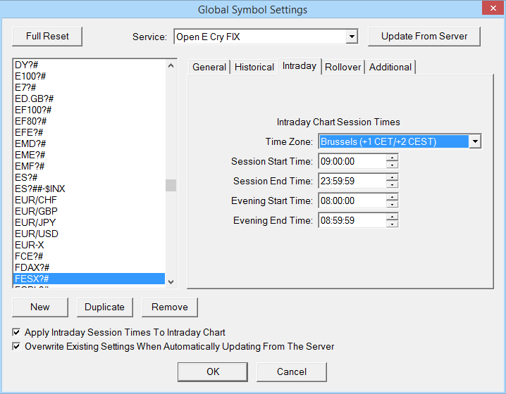

Global Symbol Setting time zone is Brussels +1 CET, session start 9:00:00, end 23:59:59. Evening start 8:00:00 - evening end 8:59:59
I use Apply Global symbol setting for my chart
p/s: As Europe day light saving begin, the correct time session start is 17:00, before DST the session started at 18:00 in my time zone.

[2015-03-30 06:00:33]
There are two things you need to do:
1. Update Sierra Chart the latest prerelease so that the Session Times in Global Symbol Settings will be properly applied when using a different time zone in the chart itself. Here are the instructions:
http://www.sierrachart.com/index.php?page=doc/download.php#FastUpdate
2. Set the chart time zone to Central European Time:
http://www.sierrachart.com/index.php?page=doc/doc_TimeZone.html#DifferentTimeZoneForCharts
Both of these must be done. It is imperative, that the chart uses the Central European Time zone. Otherwise, inherently you will have problems with session times which control the start of the trading day.
[2015-03-30 06:41:59]
JingIt - Posts: 44
Look alright now but sierra chart time doesn't meet on my time zone, will this be fixed in up coming version??

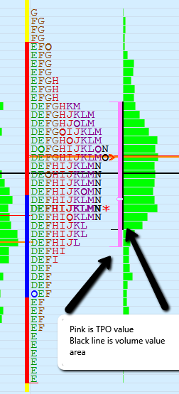

One feature I would like to request is can Sierrachart team adds vertical value line for TPO study. The mix value vertical line will help me have better view of value of market profile and volume profile. I have attached an example screenshot

[2015-03-30 07:22:54]
This is an impossibility because your time zone daylight savings time rules, if any, do not match central European Time.
The Value Area identification is accomplished by highlighting the back of the letters or drawing horizontal lines to the right.
