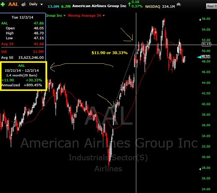

Can you please add the feature which allows us to add a calculator to the Crosshair tool to save switching back and forth.
I've attached a pic which illustrates. This would save many extra unnecessary clicks. Thanks:)
imagetool request.jpg / V - Attached On 2015-03-04 23:11:37 UTC - Size: 96.25 KB - 817 views
[2015-03-05 00:12:37]
User623839 - Posts: 108
The way it works in TC2000 is to press and hold the mouse button at the position you want to start measuring then drag to the end position to measure. When you release the button the measurement disappears also.
Date Time Of Last Edit: 2015-03-05 00:12:56

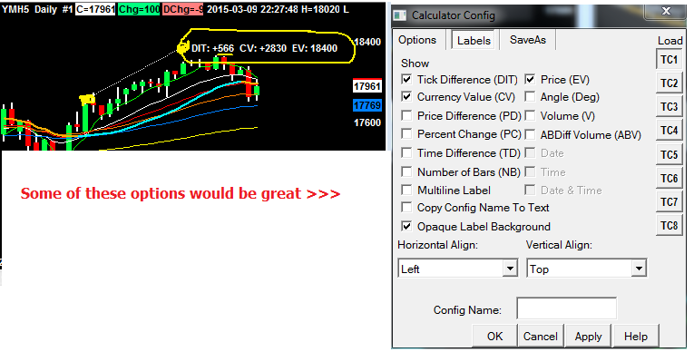

[2015-03-10 02:32:26]
That is sooo close to perfect! However.... with the calculator tool I can see the ticks or points and I'm not seeing this option with the in the Chart Values Window.
I use it to display the ticks versus always doing the math in my head. We are so close. Thanks for your help:)
Date Time Of Last Edit: 2015-03-10 02:38:15
imagerequest.png / V - Attached On 2015-03-10 02:37:51 UTC - Size: 44.58 KB - 643 views
[2015-03-10 02:41:05]
I see the values in the Chart Values Window, only when I select the calculator tool, but the whole idea is to not have to switch between the crosshair tool and the calculator tool.Just always have the tick value present with the crosshair only. Hopefully that makes sense

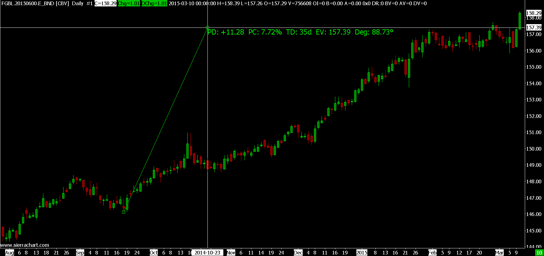

[2015-03-10 03:30:56]
I guess what I'm asking, per my first message, is an integration between the calculator tool and the crosshair. I don't think it does this. Using the crosshair I want to left click> drag mouse> as it calculates the ticks or percentage. I've attached one final pic
imageexample59.png / V - Attached On 2015-03-10 03:30:29 UTC - Size: 117.58 KB - 726 views
[2015-03-10 16:48:20]
Yes, this is supported:
http://www.sierrachart.com/image.php?l=142600607536.png
[2015-03-10 23:55:08]
Sweet.. That's awesome. I must be overlooking some things. I'll do some more reading. Thanks a bunch!
