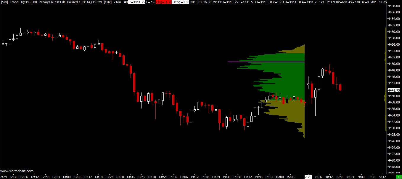

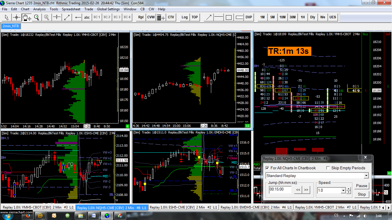

Good morning,
just recently I started having problems with Volume By Price study. Once the charts start “moving” (live feed or replay), the volume bars start retracting until they make an even line on the right side of the chart. As seen on this video: https://vimeo.com/120757568
If I refresh the study or make any change to it (like hide it and then enable it back again) it starts OK, but then the volume bars retract again.
I am not aware of making any changes to the study settings.
Thank you for your help.
Josef
[2015-02-27 02:28:25]
This is quite unusual.
We do not need to see a video.
[2015-02-27 02:45:17]
AC95097 - Posts: 5
Here it is.
http://www.sierrachart.com/image.php?l=1425005080842.png
[2015-02-27 02:55:04]
Post an image of only one chart Only containing the Volume by Price study.
And let us know what the Volume Graph Period Type input is set to for the volume by price study.
[2015-02-27 03:03:15]
AC95097 - Posts: 5
http://www.sierrachart.com/image.php?l=1425005997980.png
Volume Graph Period Type: Multiple Profiles Fixed By Time
