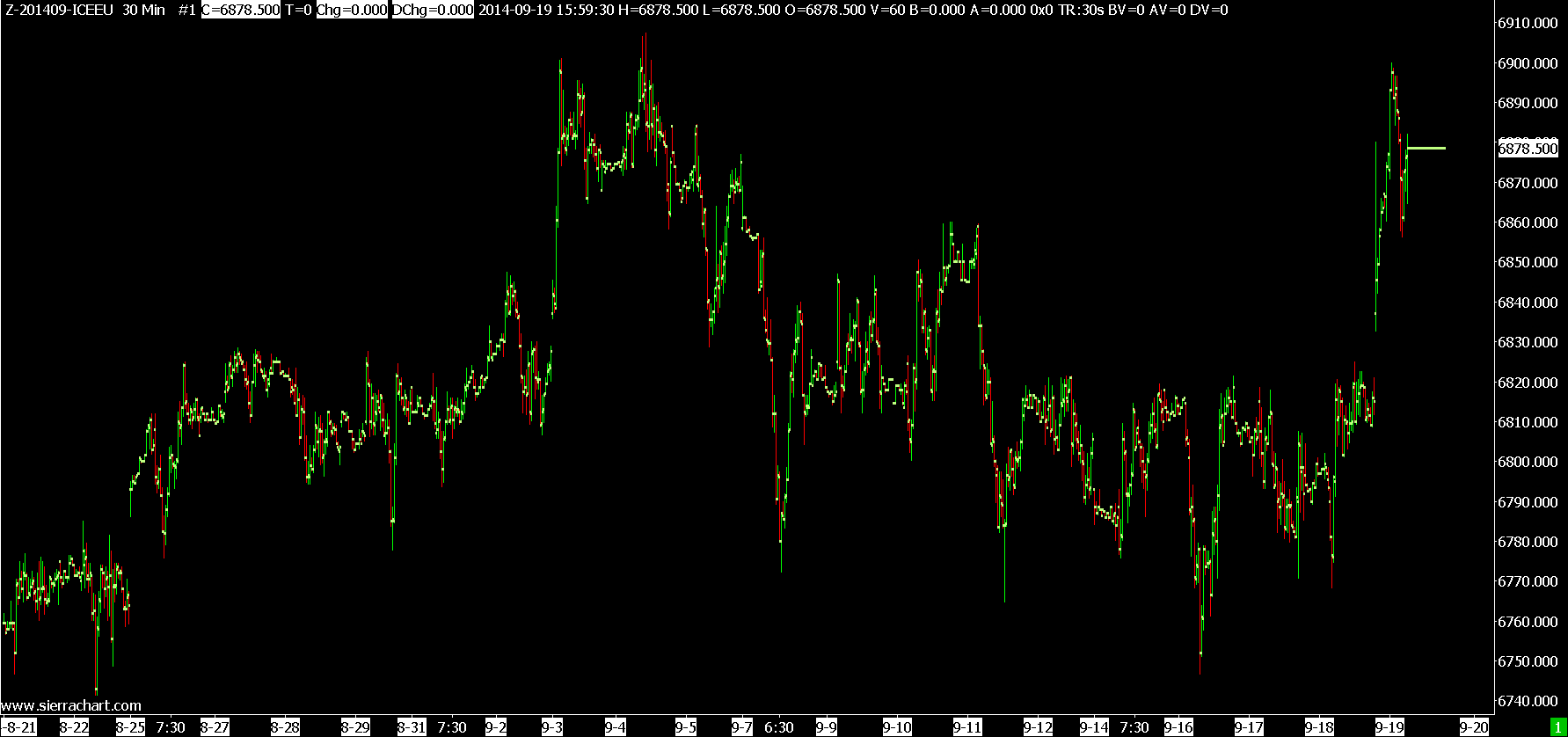

[2015-02-10 20:21:11]
This is some of the data that we see when we open the chart data file:
http://www.sierrachart.com/image.php?l=142359960280.png
Do you only see a blank chart when opening that file?
Also, Sierra Chart will not connect to data feed if the data file contains data unless the data is being filtered out by the Session Times.

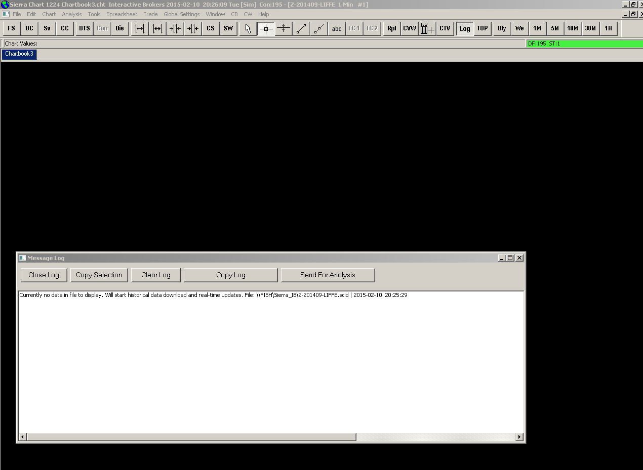

User24804 - Posts: 19
Yes a blank screen if disconnected and a symbol not found msg from IB if connected
My Pic attached
Thanks for your pic, that's roughly what I would expect to see
BTW
SC ver 1224 on W7 64bit
imageSC2.PNG / V - Attached On 2015-02-10 20:31:23 UTC - Size: 34.19 KB - 529 views

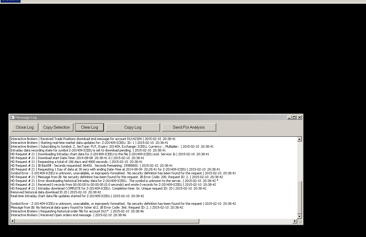

[2015-02-10 20:48:28]
Sorry for that pic, You will note that the file name includes LIFFE instead of ICEEU.
Actually both files are identical except in name.
ICE made a takeover of the LIFFE exchange about then and we had to rename a lot of files. I have the same difficulty with the slightly older LIFFE files which of course are not recognised by IB due to name change.
A new pic attached and a log file of the attempt to open an intraday file.
Note that SC was "Disconnected" when the "open file" command was given
There are a few mins left of todays ICEEU session ending 2100 UTC
Martin
imageSC3.PNG / V - Attached On 2015-02-10 20:45:01 UTC - Size: 46.73 KB - 586 views
attachmentSierralog1.txt - Attached On 2015-02-10 20:45:19 UTC - Size: 4.49 KB - 1026 views
[2015-02-11 09:00:45]
You should see some data for sure. Refer to this documentation here to check the session times:
https://www.sierrachart.com/index.php?page=doc/doc_HistoricalIntradayData.html#h7.3
In regards to the historical data downloading, we need to do an update to symbol settings to minimize that.
[2015-02-11 09:10:34]
Rename the chart data file using this format:
Z-######-ICEEU-GBP-1000
To avoid an excessive amount of historical data downloading.

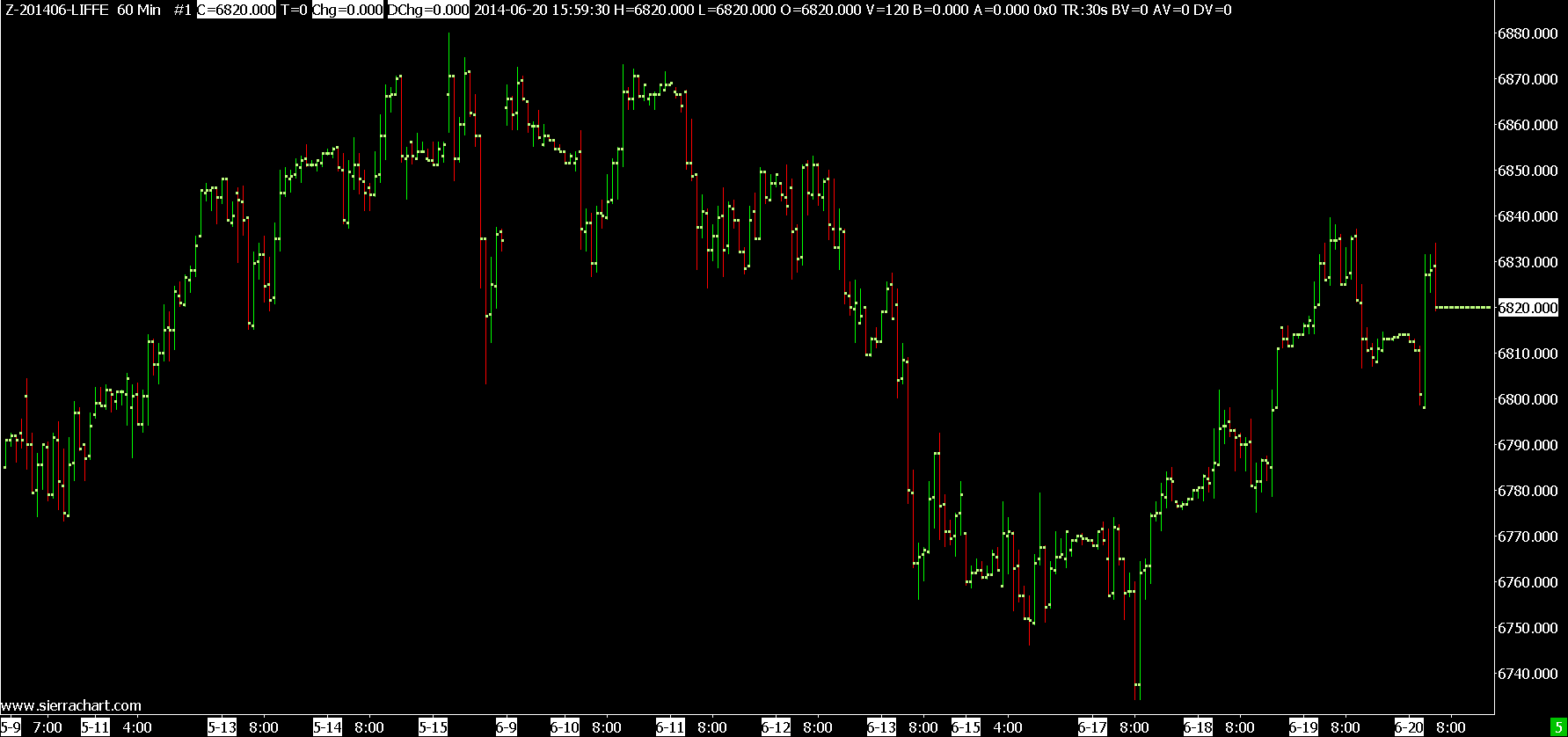

[2015-02-12 09:55:37]
There seem to be inconsistencies with this symbol system and behaviour.
I have succeeded in opening the expired scid file Z-291409-ICEEU when re-named Z-201409-ICEEU-GBP-1000.
However when calling for a new chart of the current front month from IB which is Z-201503 by using the full name Z-201503-ICEEU-GBP-1000 we are unsuccessful - see log attached
A subsequent request for Z-201503-ICEEU was accepted but the download is still on-going after circa 30 mins.
I will continue to explore the original query regarding expired contracts offline which is not satisfactorily resolved.
SC won't open OLD saved scid files and immediately makes calls to IB - why can't it read data SC created?
Is there some lack of backward data compatibility in the latest version?
I not in some cases, when a file appears to be opened but not displayed an F5 enquiry for properties shows that the date range of the file is "unknown"
An example is attatched
Private File
attachmentZ-201406-LIFFE.scid - Attached On 2015-02-12 09:55:24 UTC - Size: 7.77 MB - 632 views
[2015-02-12 19:58:35]
One of the problems is you need to reduce the Maximum Number of Historical Intraday Days to Download. Refer to this section here:
https://www.sierrachart.com/index.php?page=doc/IB.php#SlowDownloading
When we open your attached file, it displays:
http://www.sierrachart.com/image.php?l=1423771062696.png
The only reason why a file could not be opened and display nothing has to do with the Session Times and we already gave you information about that, or the file could not be read:
Error Messages When Opening Files
