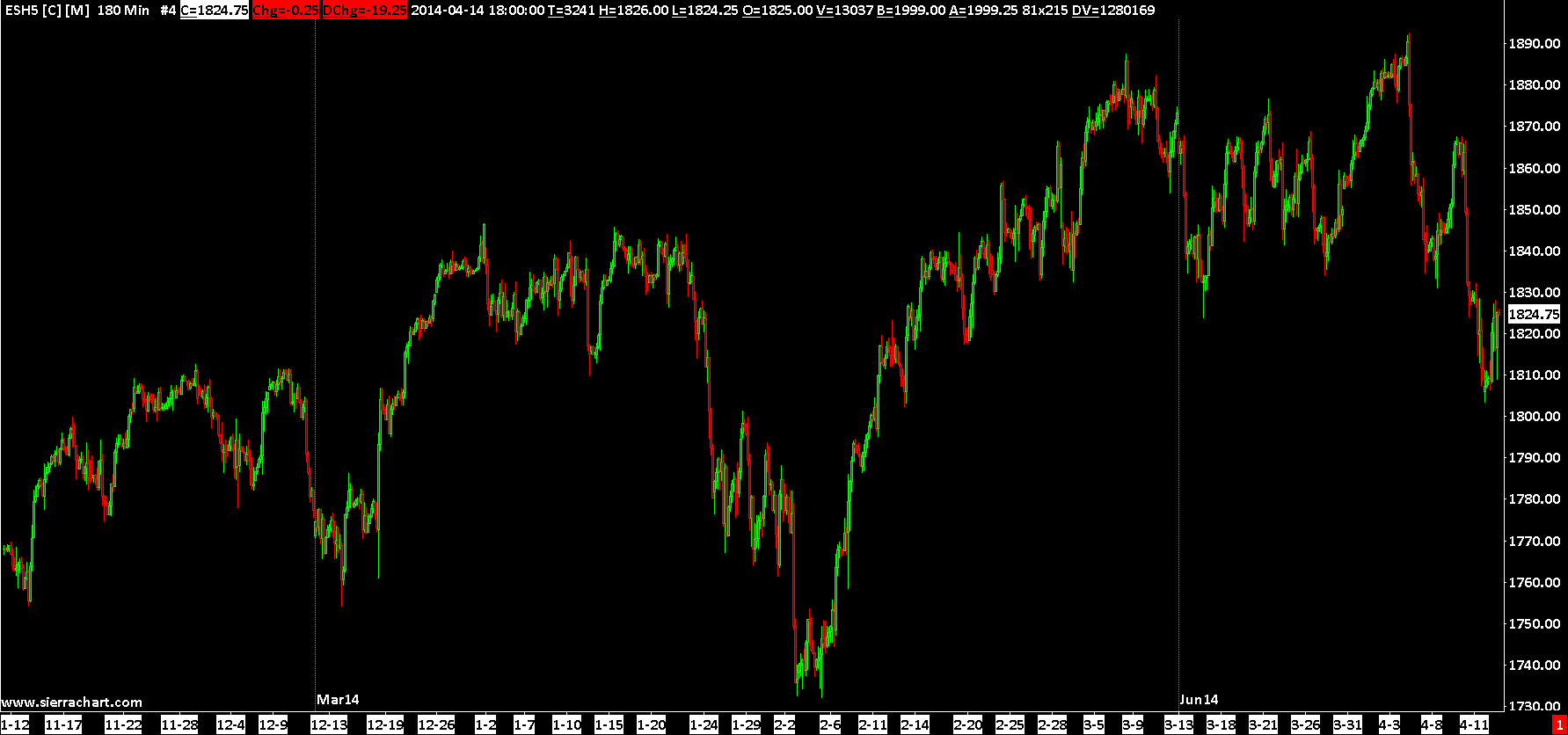

[2015-01-30 17:58:08]
CMG - Posts: 179
I followed all your instructions a day still there is a gap in their I fo, what do we do?
http://www.sierrachart.com/image.php?l=1422640448705.png
[2015-01-30 18:19:58]
Either the procedure given was not exactly followed, or for some reason it did not work properly. Therefore, follow the procedure here to delete the Intraday data files:
http://www.sierrachart.com/index.php?page=doc/doc_ContinuousFuturesContractCharts.html#ReDownloadingByDeletingFiles
Also, the chart is correct for us for that time period:
http://www.sierrachart.com/image.php?l=1422641885420.png
Date Time Of Last Edit: 2015-01-30 18:21:25
