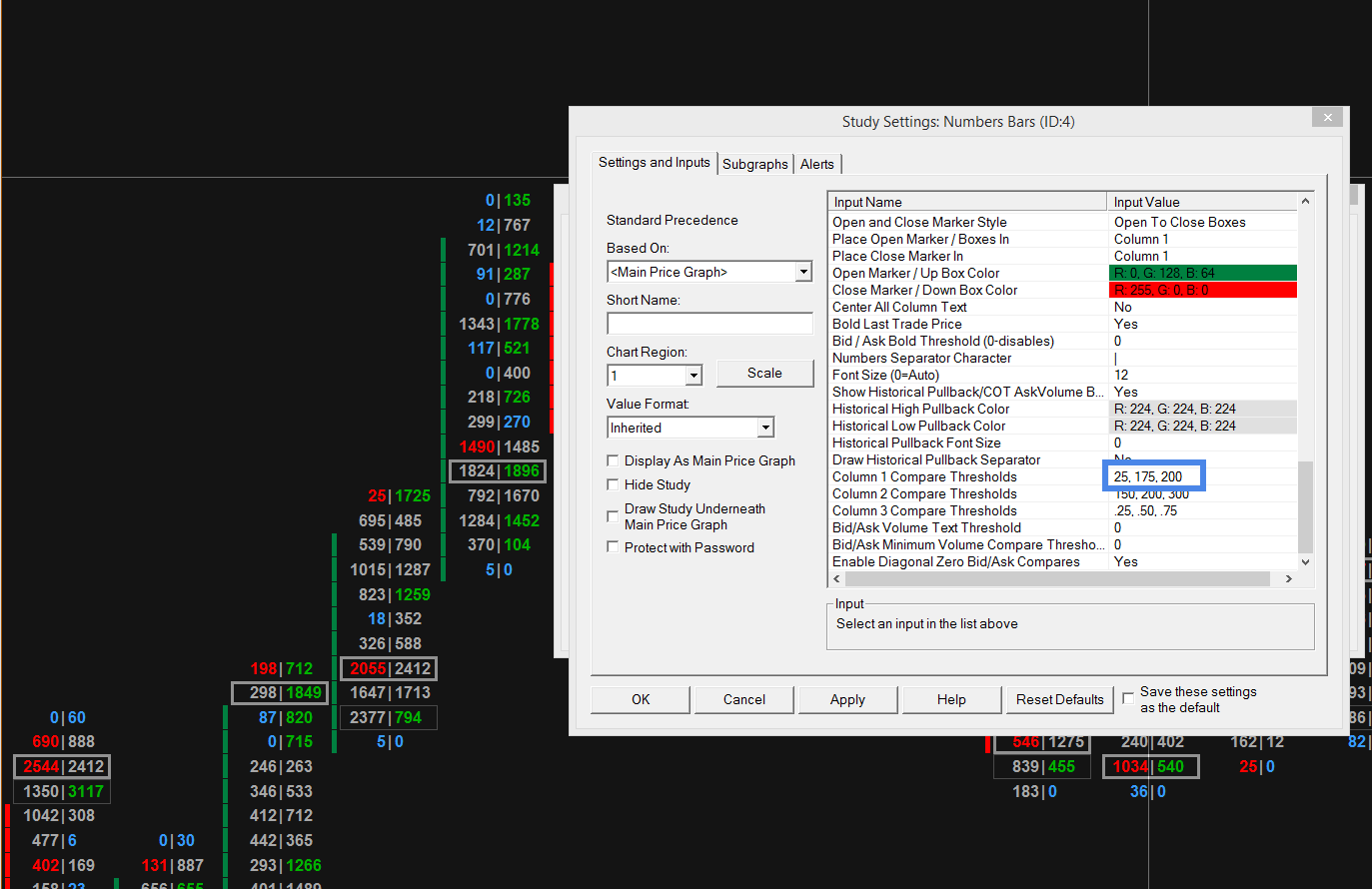

[2015-09-24 08:35:52]
User31732 - Posts: 32
Hello, User60287.
You can do this if you set up first threshold less than 100 and play with colors.
Hope this help.
Date Time Of Last Edit: 2015-09-24 08:41:24
