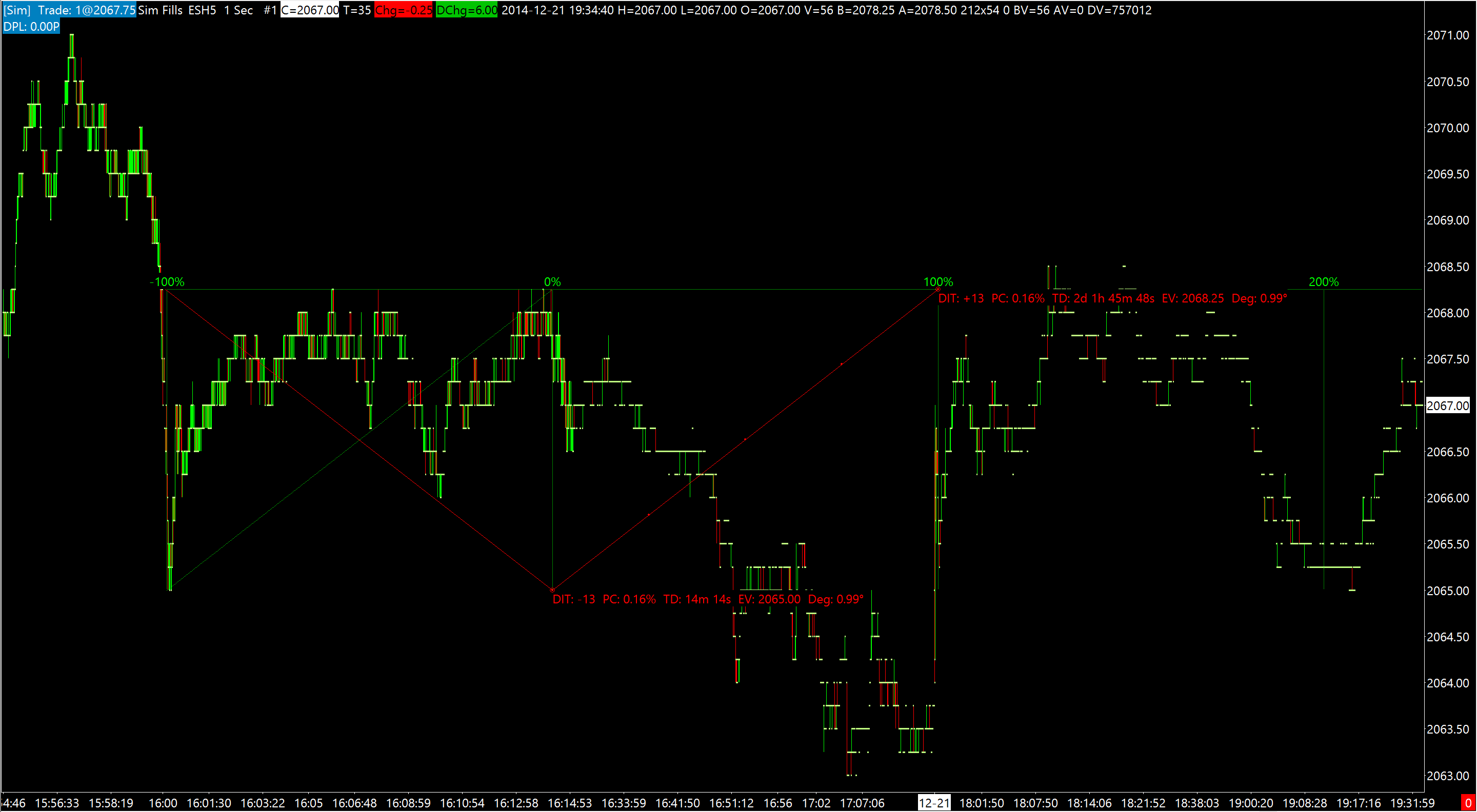

dem_z - Posts: 14
-100% to 0% should equal 0% to +100%
but the duration of the former is 14m 14s,
and the duration of the latter is 2d 45m 48s
This chart is on ES, 1 second
imageScreenshot 2014-12-23 16.08.31.png / V - Attached On 2014-12-23 21:09:57 UTC - Size: 182.17 KB - 520 views
[2014-12-24 21:02:54]
In the configuration for this drawing tool, there is the Time Analysis Based On setting which controls this. You need to set it to Time.
