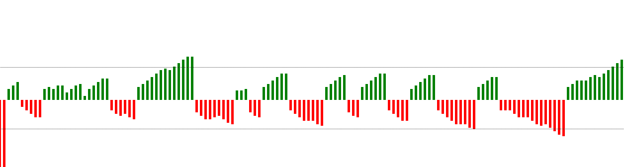

If I use "Bar", then Sierra will only chart the bar to draw above the "0 line". From my understanding, with a histogram, the (+ value) bars will be greater then "0 line" and the (- value) bars will be less then the "0 Line".
ie. Can i create a histogram with the study "Volume" to look like the attached sample, ty

[2014-12-08 08:36:35]
Yes. This will work. When a Subgraph value at a particular chart column is negative, the line will go from 0 down to that negative value.

[2014-12-08 17:42:08]
Actually, we realize what you want to do.
Here is the source code which will accomplish this:

[2014-12-08 18:47:47]
User93757 - Posts: 61
Yes, this is the result i was suggesting. I understand the concept of pos & neg numbers. I guess what i am suggesting (not sure if it can be done) is to have a general setting in the studies or some type of overlay which can distinguish the difference between two colors (ie. green/red --> (sc.Close[sc.Index] >= sc.Open[sc.Index]))..
And therefore draw positive and negative colored bars, based on this idea (histogram). If it can be done, i believe it could be very useful on a lot of the current studies out there.
Thanks for entertaining the idea. I can always learn a bit of code to modify the current studies but i thought a lot of users would like such a feature; or not :) ty
