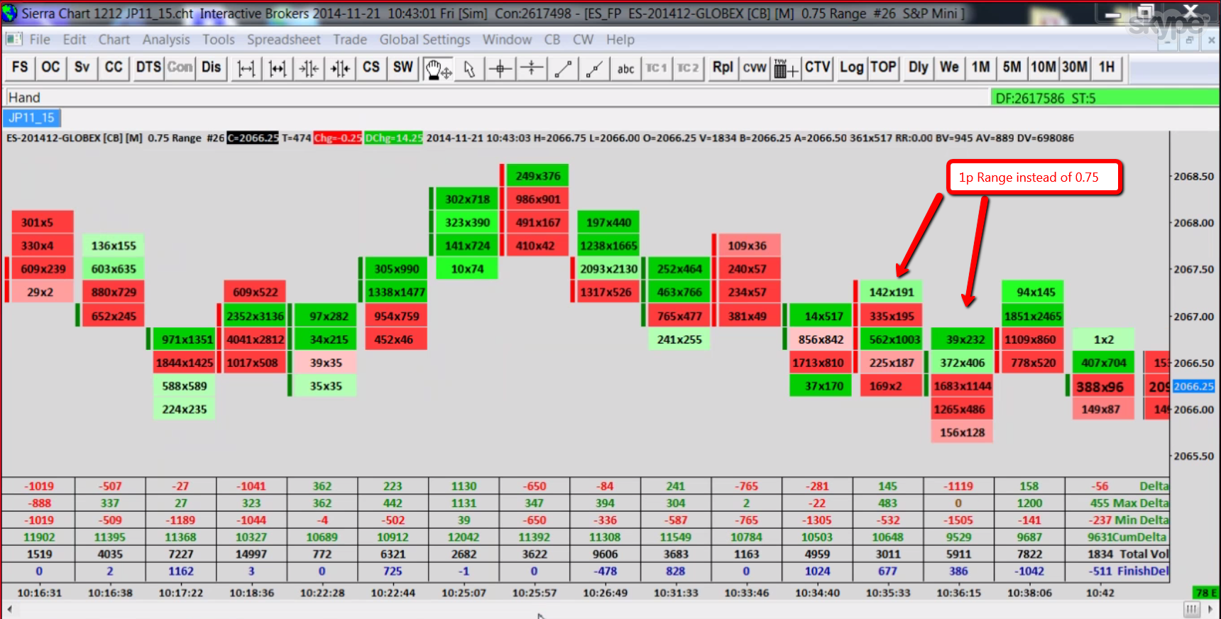

Range chart .75 range acting weird
View Count: 1318
[2014-11-21 16:14:05]
User60873 - Posts: 4
see image...please number of cells wrong
image3TickRangeFP.png / V - Attached On 2014-11-21 16:12:51 UTC - Size: 990.38 KB - 514 views
[2014-11-21 17:55:49]
The most likely explanation is that range bars are manipulated bars and they do not represent 100% accurate price movement. You need to be aware of this.
The Numbers Bars study will reveal all of the prices traded at within a particular chart column without the manipulation.
We would suspect that once you remove the Numbers Bars study from the chart, the Range bars will not exceed your setting.
So the simple answer is what you see is not what you expect, then do not use Range bars.
This is marked as a User Discussion and we cannot comment on it further.
Date Time Of Last Edit: 2014-11-21 18:05:11
[2014-11-21 18:04:02]
The only other thing we would add to this is make sure there is a tick by tick data configuration:
[2014-11-21 18:57:16]
This solved the problem..Thanks
