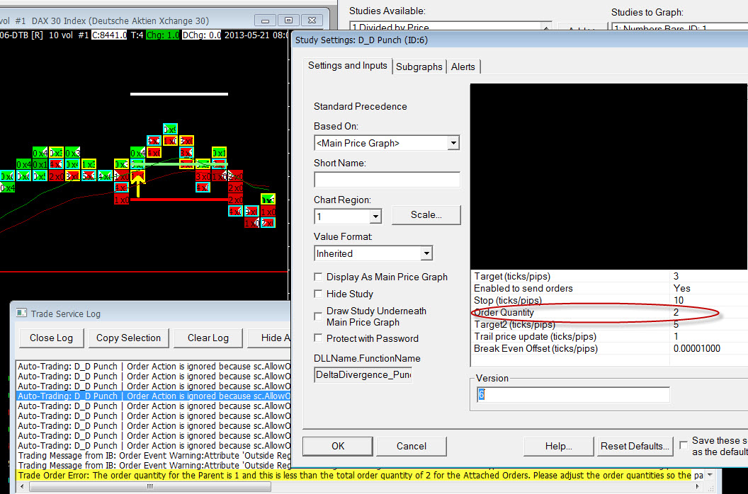

[2013-05-21 12:14:21]
User32496 - Posts: 26
here is the settings of the study set for 2 and the error msg on the log
imageparent issue order.jpg / V - Attached On 2013-05-21 12:13:51 UTC - Size: 309.6 KB - 982 views
[2013-05-21 18:37:03]
We have thoroughly tested this and could not duplicate the issue.
