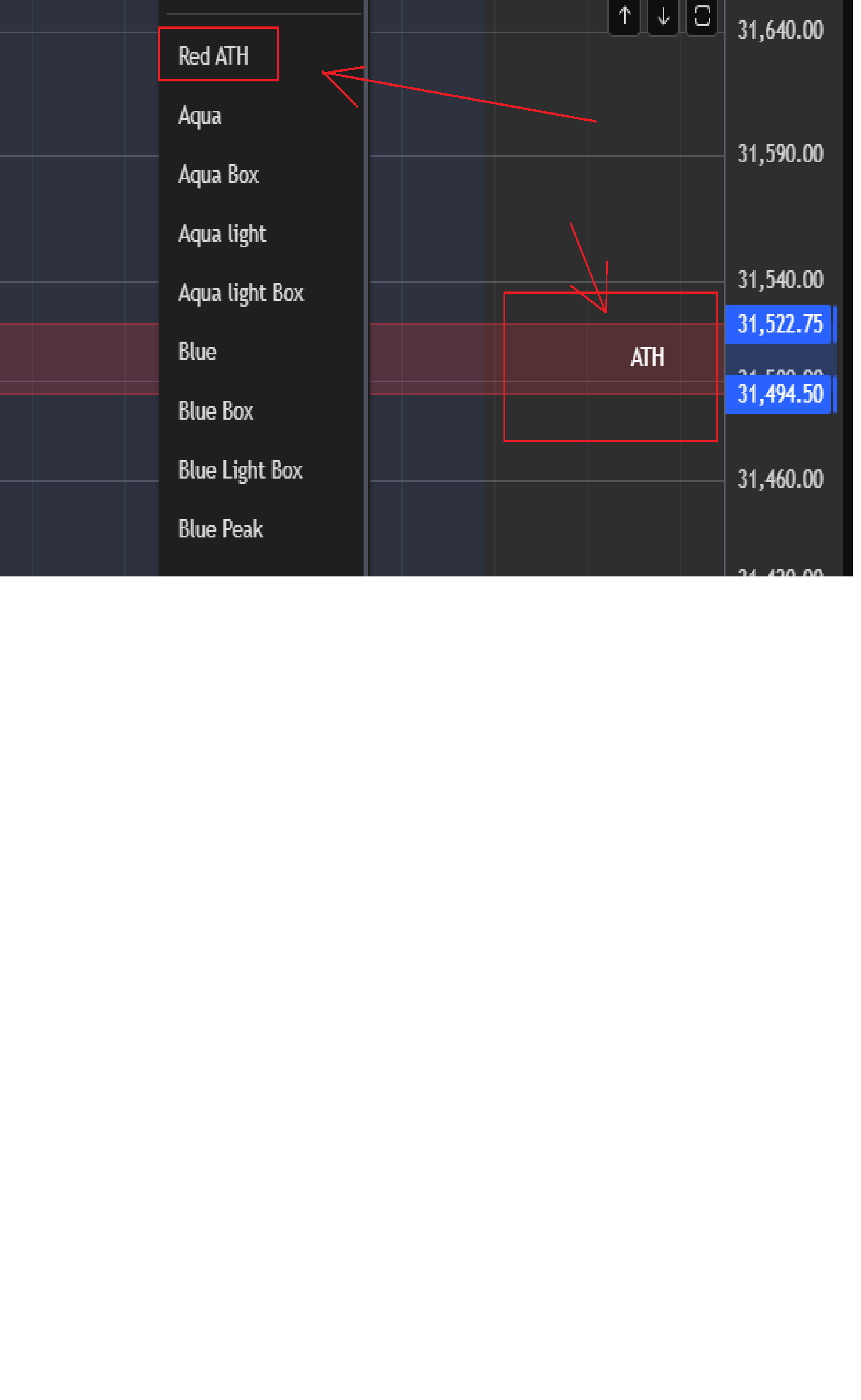

Does anybody know if we could make a template of different TEXT
on my morning zones & levels I like to input some TEXT "Codes" of mine to
let me know what's going on at that Zone or Level, later on in the day
I mean you could make a "template of different Text" on Tradingview for each drawing you use !!!
Sierra Chart is so much better in customizing everything
I was wondering if, anybody knows how to save different template of text on the drawings??? I just can't find them
I mean it's a pain in the butt, to have to write/input 10 - 15 different things every morning
imageTradingview Red rectangle ATH template.png / V - Attached On 2026-10-11 01:45:50 UTC - Size: 243.73 KB - 75 views
