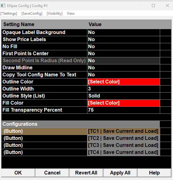

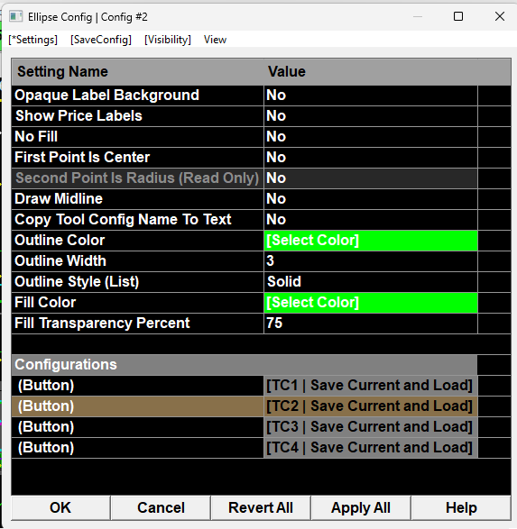

I have created two different configurations for the Ellipse drawing tool TC1 and TC2 (refer to picture).
I would like to assign a separate keyboard shortcut to each configuration, so I can activate Ellipse TC1 or Ellipse TC2 directly with a single keyboard shortcut.
Could you please explain how to do this in Sierra Chart?

imageellipse TC2.png / V - Attached On 2026-10-09 21:38:21 UTC - Size: 49.81 KB - 49 views
imageellipse TC1.png / V - Attached On 2026-10-09 21:38:27 UTC - Size: 31.58 KB - 46 views

John - SC Support - Posts: 48643
Follow the instructions at the following link. You first need to create the Control Bar setup for the drawing and configuration and then you can assign the Keyboard Shortcut to that setup.
The Control Bar button does not need to be displayed, you just need to set it up first to establish the drawing and configuration.
Chart Drawing Tools: Creating Control Bar Buttons which Select Drawing Tool and Drawing Tool Configuration in One Step
