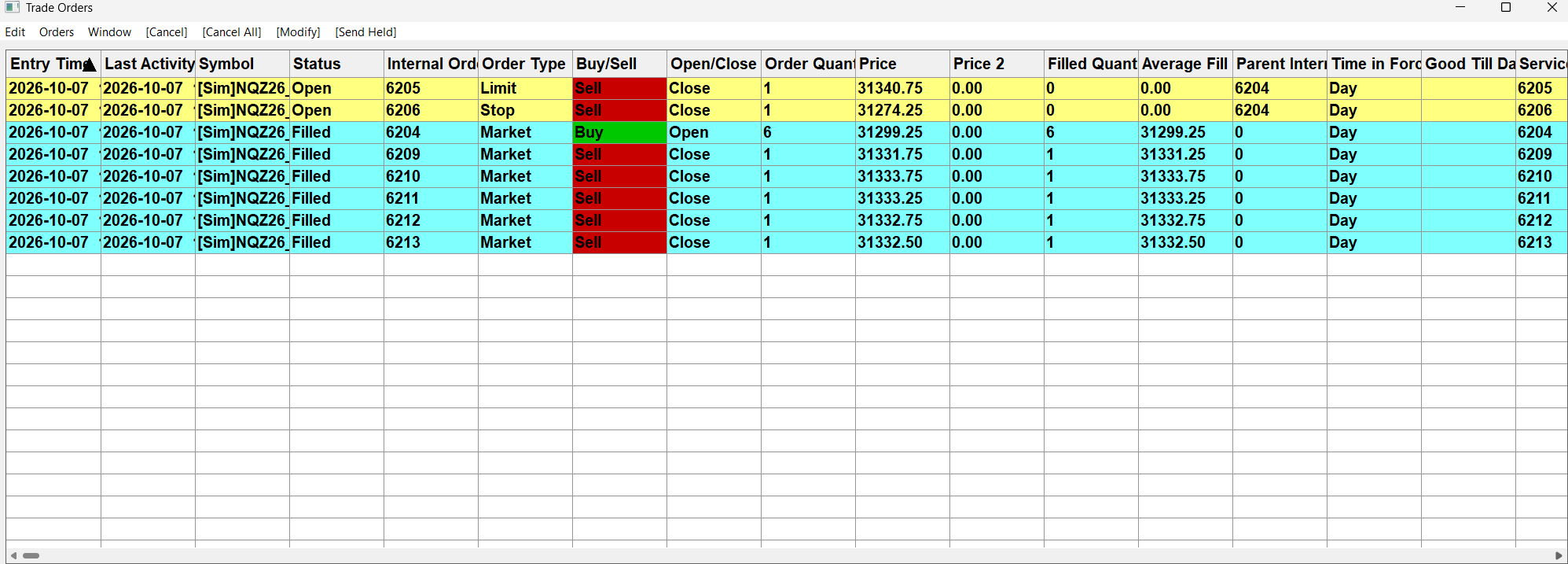

The problem is that during Replay, the price appears to move through the TP/SL levels on the chart, and I am not always sure whether the order is actually being triggered correctly.
For example:
Position:
Buy 4 @ 31317.25
Attached orders:
Take Profit: Sell Limit @ 31333.00
Stop Loss: Sell Stop @ 31302.50
In the Trade Orders window I can see that the TP was eventually filled:
Order Type: Limit
Buy/Sell: Sell
Open/Close: Close
Quantity: 4
Order Price: 31333.00
Filled Quantity: 4
Average Fill Price: 31340.75
Status: Filled
The Stop order was then canceled, which appears correct because the position had already been closed by the TP.
However, on the chart it looks as though the price moves through the order line before the fill occurs.
I am testing this on a 1-minute chart during Replay.
I would like to know:
1. What is the correct Sierra Chart setting for accurately testing Attached Orders during Replay?
2. Should "Always Simulate Bid and Ask Prices During Replay" be enabled?
3. Should "Allow Simulated Resting Limit Order to Fill at Better Price" be enabled or disabled for realistic Replay testing?
4. Why can a Sell Limit order at 31333.00 receive an Average Fill of 31340.75?
5. Is there any other Replay or Trade Simulation setting that affects when Attached Stop and Limit orders are triggered?
I would like the Replay behavior to accurately simulate whether the market actually reaches my TP or SL level.
Thank you.
imagetraders orders.png / V - Attached On 2026-10-07 15:47:09 UTC - Size: 67.35 KB - 44 views

Refer to the following for the general answers to your questions:
Trade Simulation: How Orders are Filled
You may want to use our "Simulated Futures Trading Service" instead of the built-in Trade Simulation mode. It is going to be a bit more realistic in the fills. Refer to the following:
