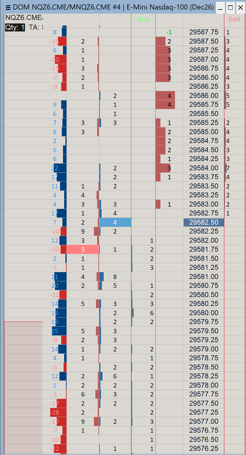

On NQZ6.CME, the Bid Market Depth Pulling/Stacking column values and volume bars intermittently go blank and reappear at price levels throughout the depth (not just the best bid), independent of best bid/ask price changes. Reproducible with no combine increment set.
The Ask Market Depth Pulling/Stacking column on the same DOM does not show this exact behavior but a slightly different one.
The volume bars on ask, shrink to a smaller size and then back to the correct size. Now I know this is very plausible as the size of the volume bars are relative, but I have noticed this even when the values/numbers on the ask pull/stack are not changing for some time
The same behavior is not present on ES on the same install/version.
I have attached an image for your reference, snapshot at that exact moment when the bid values disappear.

imageNQ DOM.PNG / V - Attached On 2026-09-17 11:35:32 UTC - Size: 107.3 KB - 65 views

I think I have found out what is triggering it. I reconstructed the DOM from scratch.
It is combine tick increment (Aplogies for the incorrect information I gave regarding this at the start).
The moment I do combine tick increment this "blinking" issue starts with the pull stack. Otherwise, the pull stack works fine.
Even a combine tick increment of 1 causes it to break.
I have set:
Apply combine increment in ticks to other market data columns >> Yes
Chart DOM volume bars fill combined price level >> yes
