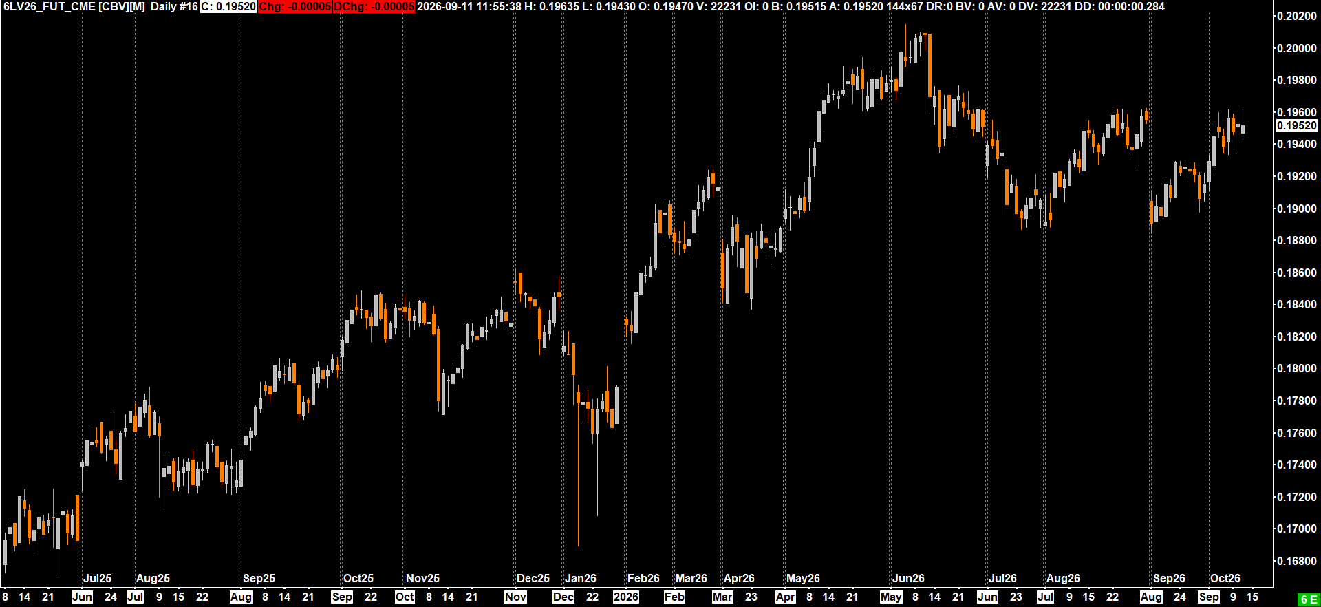

Hello, I hope you are well. Hopefully the image is attached. This is not exhaustive but more to demonstrate the potential issue, if in fact there is an issue. From the attachment starting in Feb'26 the last bar is 27/2/26 and next bar is 13/3/26 - hence there is a gap. March to April, April to May all okay. Then the end of May 29/5/26 next bar is 12/6/26 - hence there is a gap. June into July okay. Then the end of July the last bar is 31/7/26 the next bar is 14/8/26. Is this correct, as looking at all the other 6's, 6A, 6B,....,6S, they all seem to be okay. Thank you. https://www.sierrachart.com/image.php?Image=1789134583145.png |

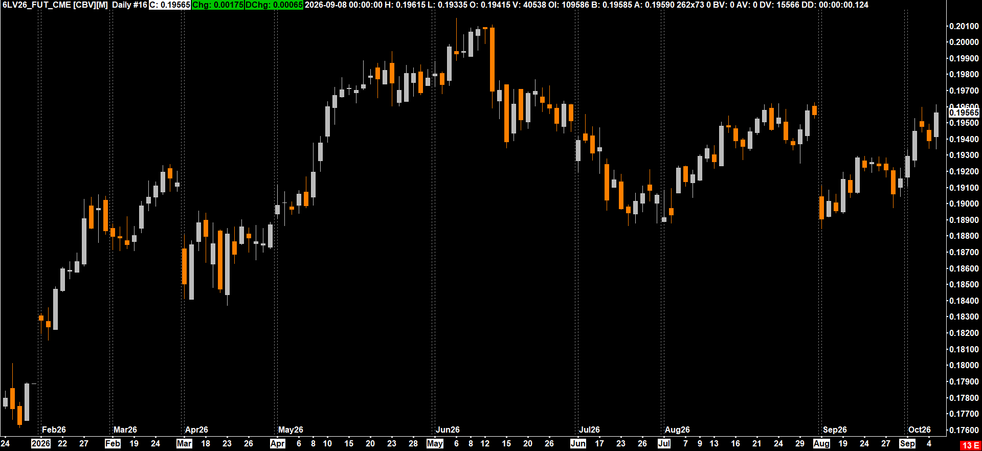

We are not seeing those gaps. Attached is an image of what we see for the historical daily data. We also looked at the Intraday data for this, just to be certain, and that does not show any gaps either. Please follow these instructions to redownload the data for the chart. Please select all the contracts to redownload them all to ensure you have all the data. Continuous Futures Contract Charts: Re-Downloading Continuous Futures Contract Data For the most reliable, advanced, and zero cost futures order routing, use the Teton service: Sierra Chart Teton Futures Order Routing |

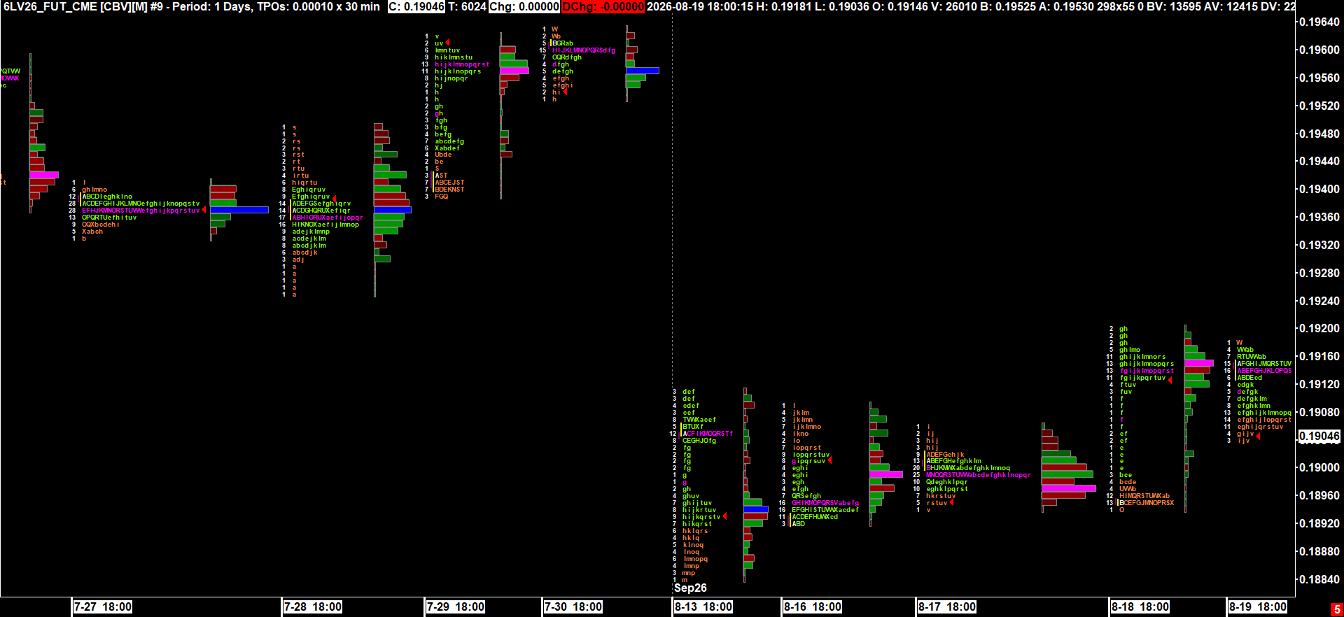

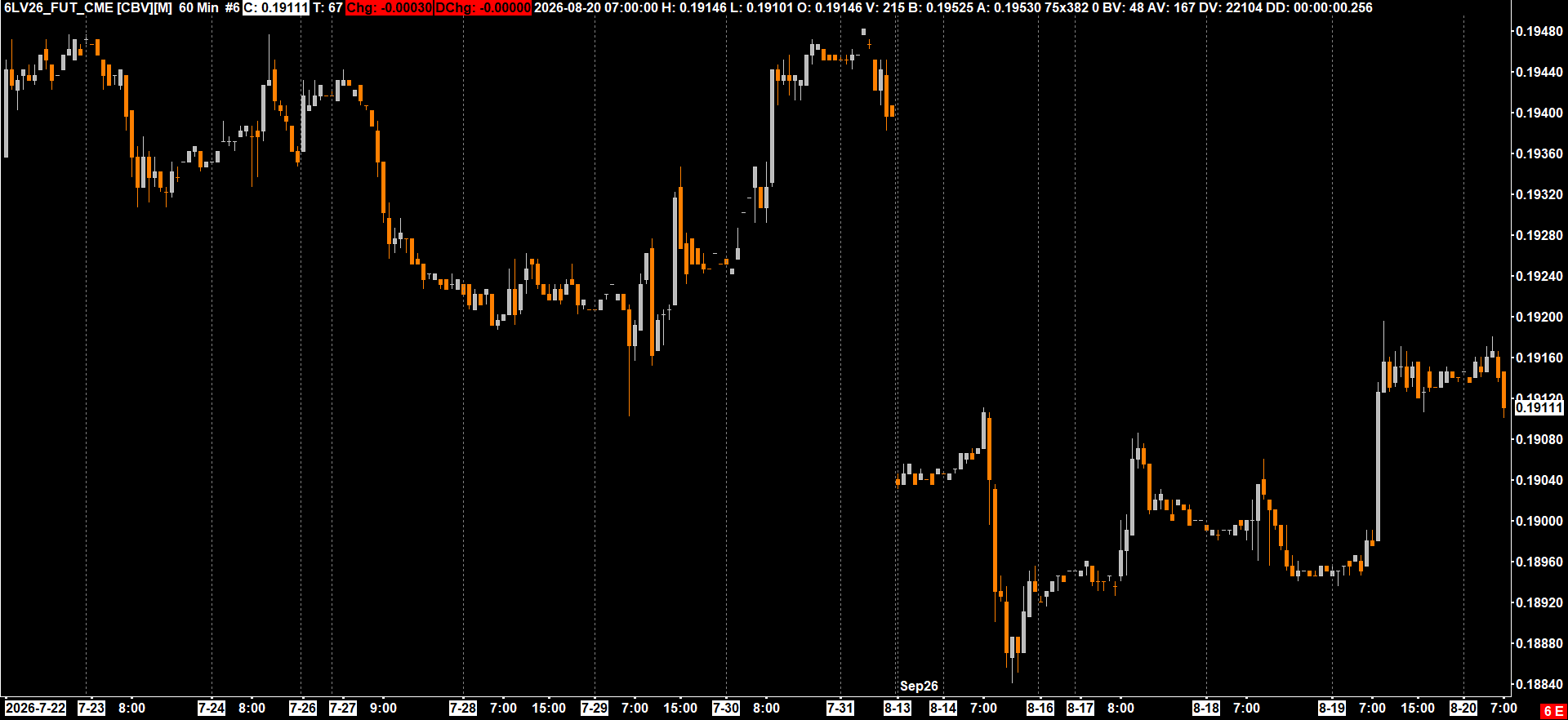

Hi John, Thanks for the reply, unfortunately the suggested remedy has not worked. I am not sure if it makes a difference, though the version was updated to the most recent one several days ago. That said 6L was not in use at that time, so from my end I cannot confirm if that has caused an issue. Please note I have also attached a TPO chart and also a 60m chart to show the results, there is also no change on the daily (historical) chart. Please note I have only included the July-Aug gap in the TPO and 60m charts to zoom in on the potential issue, noting the other dates as mentioned in the original message are as before, also noting this seems to stretch back several years after looking at the historical chart. Please advise - thank you. https://www.sierrachart.com/image.php?Image=1789141830510.png https://www.sierrachart.com/image.php?Image=1789142032589.png https://www.sierrachart.com/image.php?Image=1789142247352.png |
