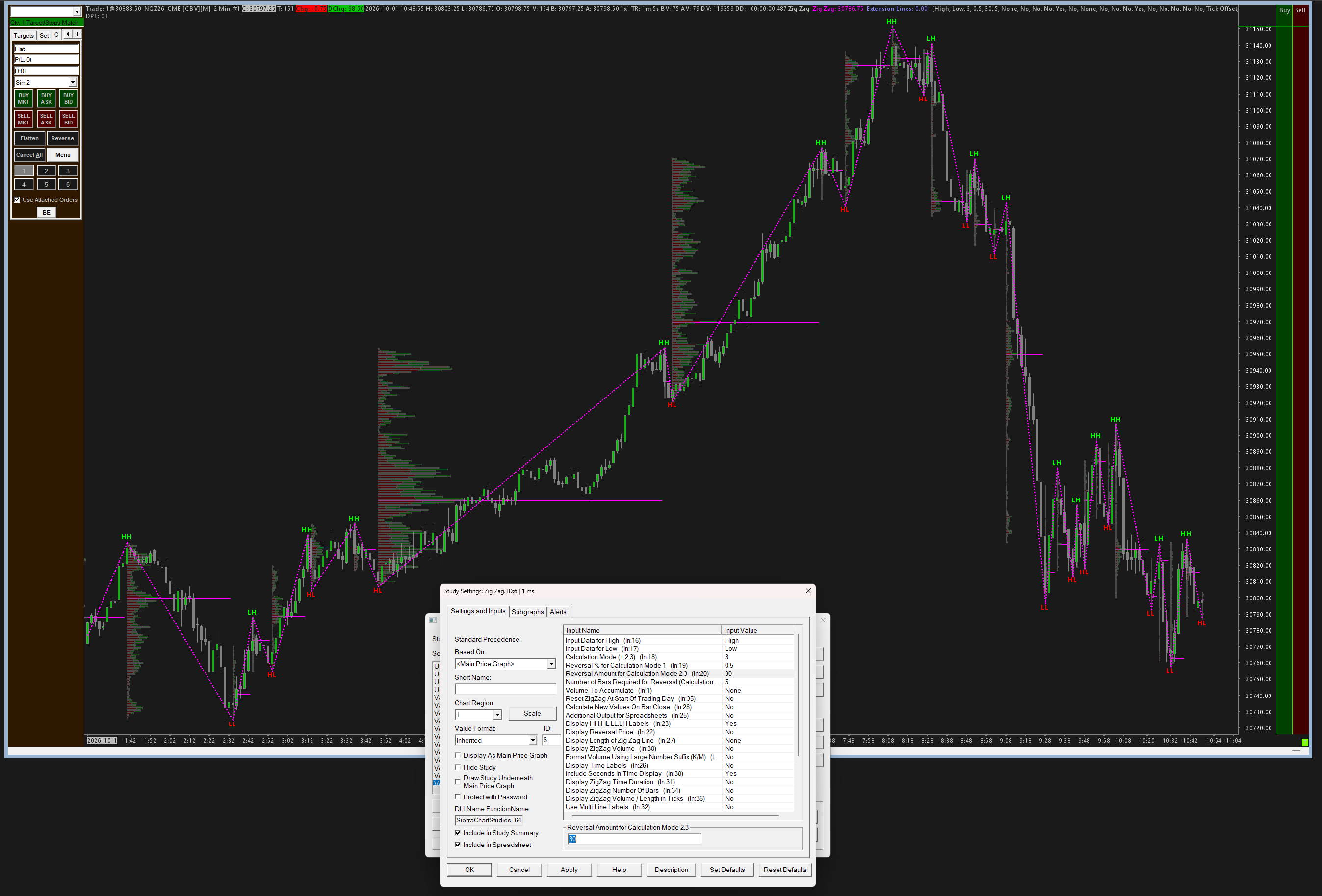

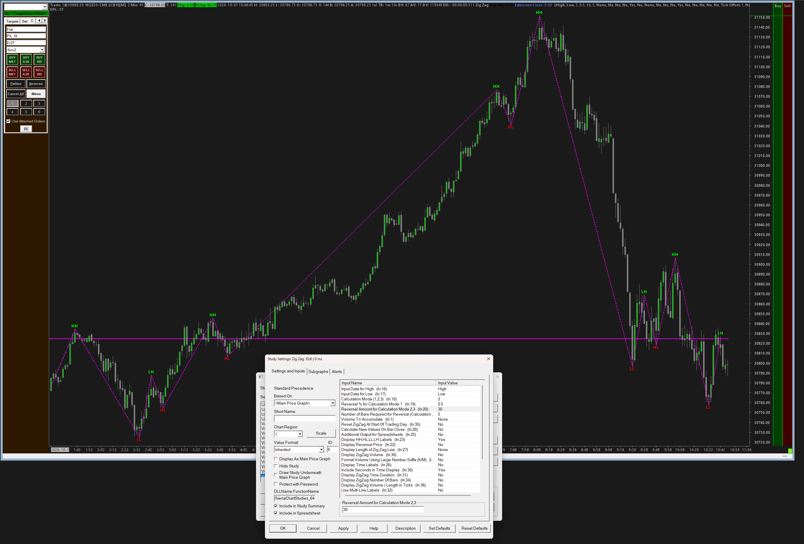

[2026-10-01 08:58:10]
User937213 - Posts: 6
Setting Number of Days to Calculate to 0 does not fix it.
The problem appears when I use a higher Reversal Amount for Calculation Mode 2/3. Last time, a Reversal Amount of 25 worked and 30 did not. Now values below 60 work, and anything above that does not.
I normally use Calculation Mode 2, but with Mode 2 nothing works at all, even though it worked fine at first. I don't know what changed.
imageScreenshot 2026-10-01 104626.png / V - Attached On 2026-10-01 08:49:57 UTC - Size: 162.85 KB - 24 views
imageScreenshot 2026-10-01 104655.png / V - Attached On 2026-10-01 08:50:02 UTC - Size: 181.33 KB - 20 views
imageScreenshot 2026-10-01 104849.png / V - Attached On 2026-10-01 08:50:07 UTC - Size: 206.04 KB - 19 views

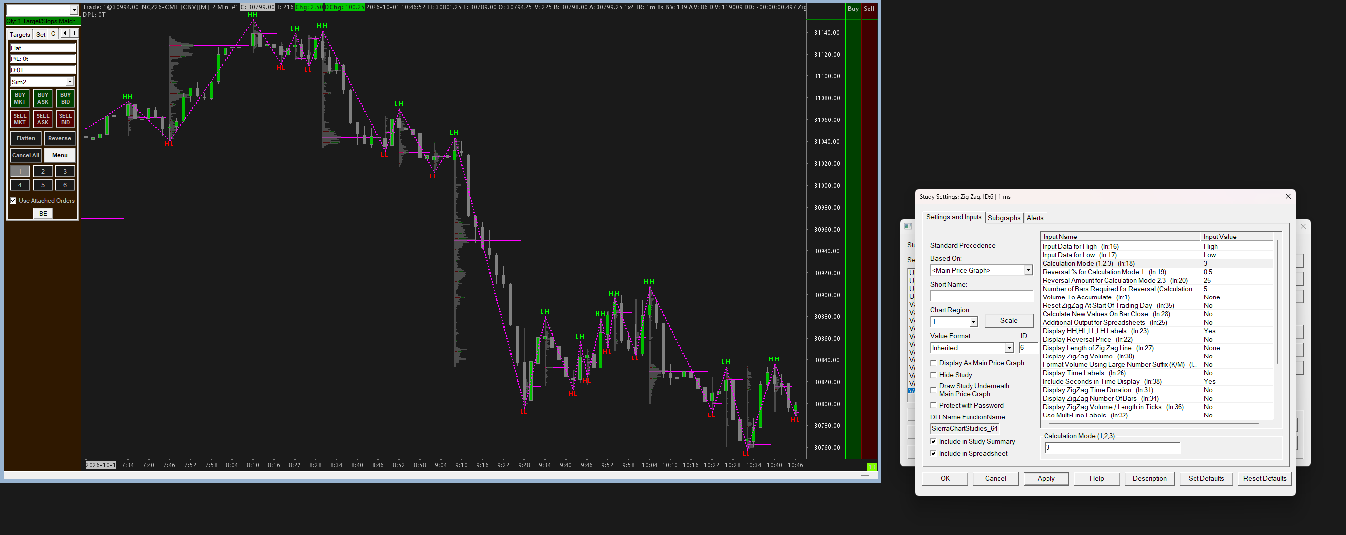

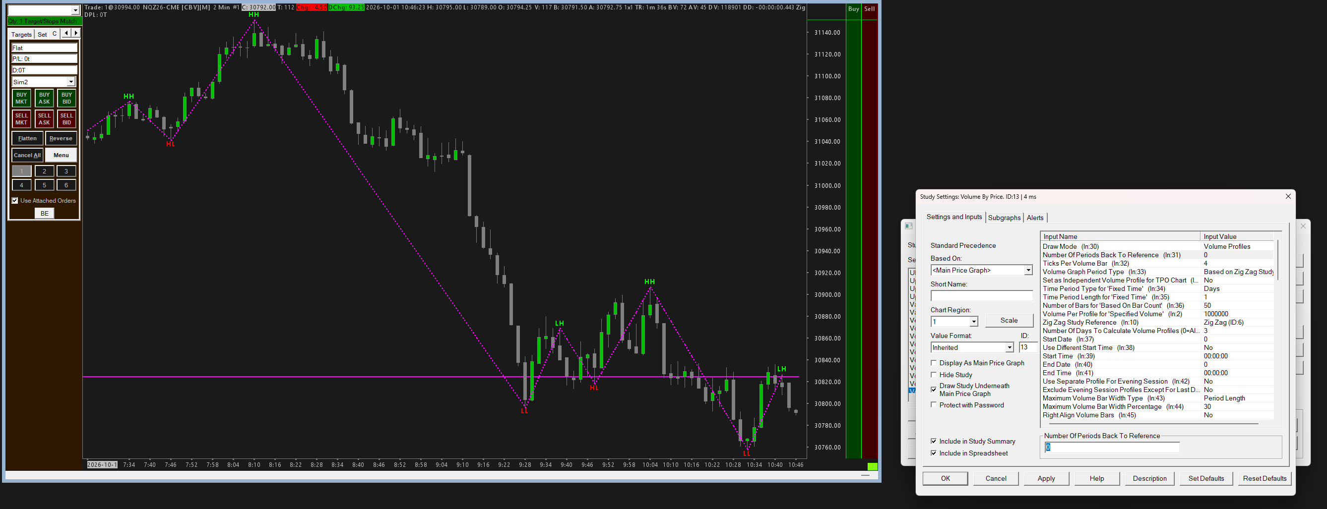

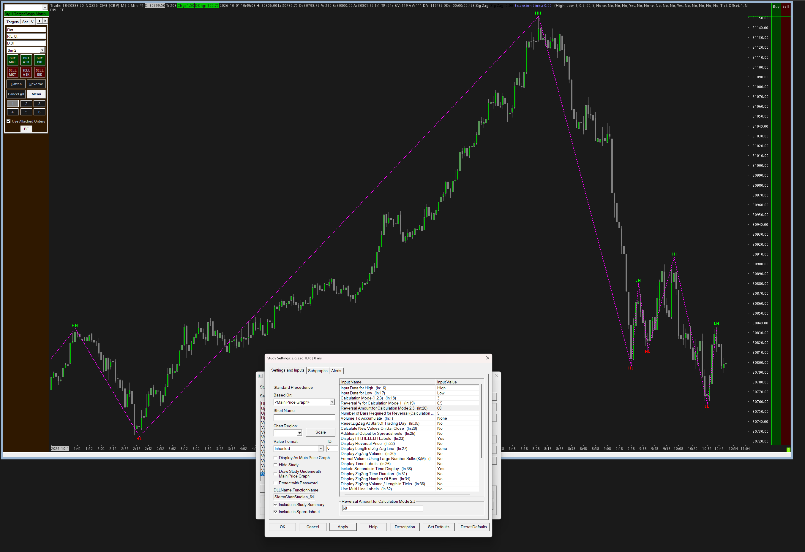

[2026-10-01 08:58:35]
File attached
imageScreenshot 2026-10-01 104857.png / V - Attached On 2026-10-01 08:58:21 UTC - Size: 242.87 KB - 22 views
imageScreenshot 2026-10-01 104911.png / V - Attached On 2026-10-01 08:58:31 UTC - Size: 209.02 KB - 23 views
[2026-10-01 14:07:54]
John - SC Support - Posts: 48127
In the most recent images you supplied, you have the "Number of Days to Calculate Volume Profiles" set to "3". Make sure this is set to "0" and let us know if you still have a problem.
When we try a Zig Zag with Calculation Mode of 3 and a Reversal Amount of 60, the Volume by Price works fine as long as the Number of Days to Calculate is set to 0.
