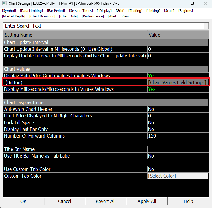

Attached is an image of where this is located. We have put a rectangle around the particular setting. The item on the right that states "Chart Values Field Settings" is a button. Select that button to get the next window that will give you the options to turn on/off the different items.
imageScreenshot 2026-08-21 102008.png / V - Attached On 2026-08-21 15:22:14 UTC - Size: 46.14 KB - 77 views

Rafalitto - Posts: 13
Ahora siiiií que lo hemos conseguido.
Muchísimas gracias por toda la ayuda.
