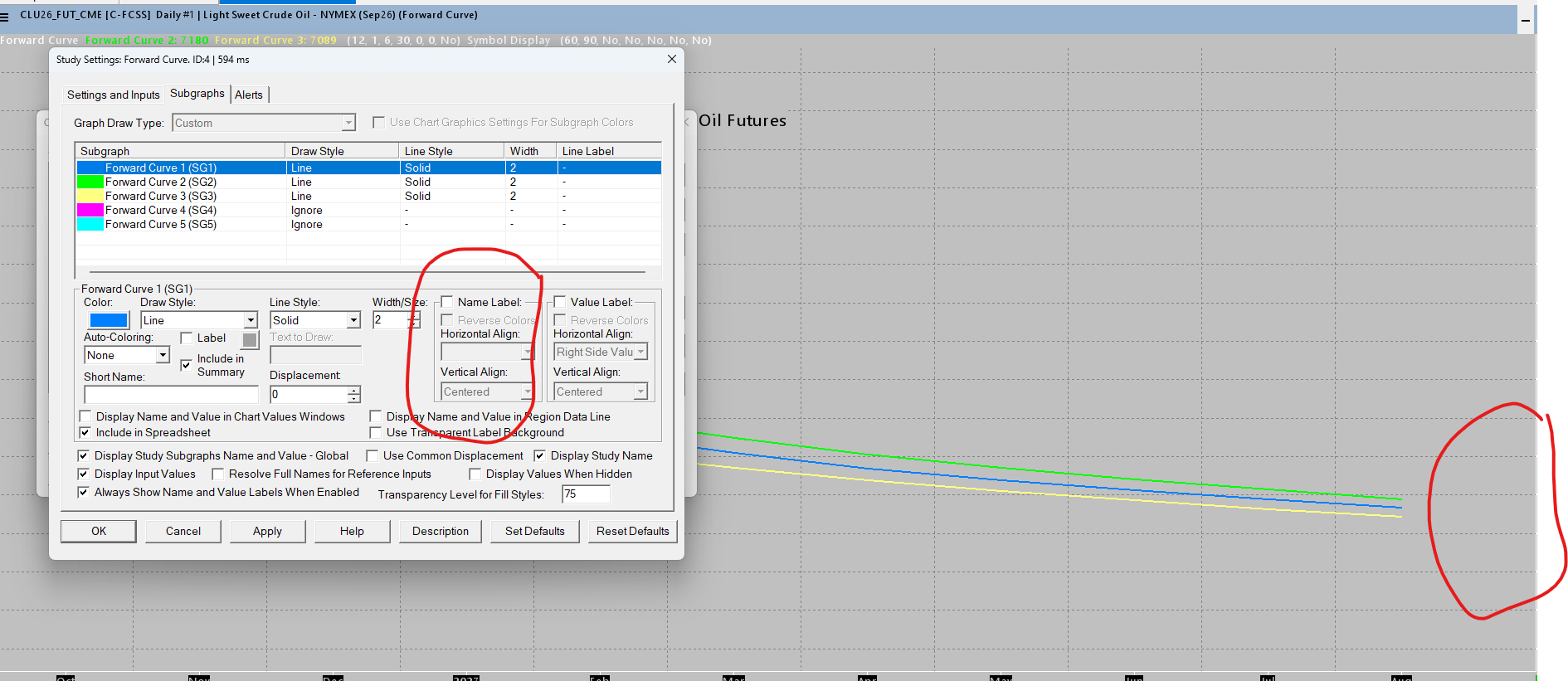

I am using the Forward Curve Study on my CLU26 chart. I am trying to get name of each subgraph line written at the end of each line. But when I check Name Label column and Horizontal Align, when I go to apply, the check disappears?
imageTermStructure 2026-08-14 091410.png / V - Attached On 2026-08-14 14:21:27 UTC - Size: 131.02 KB - 88 views
[2026-08-14 15:04:39]
We do not really recommend that study. Instead just use the Forward Curve Continuous Contract option:
Continuous Futures Contract Charts: Forward Curve Charts
To do what you want though, set this input to Yes:
DisplayDateWithForwardCurve

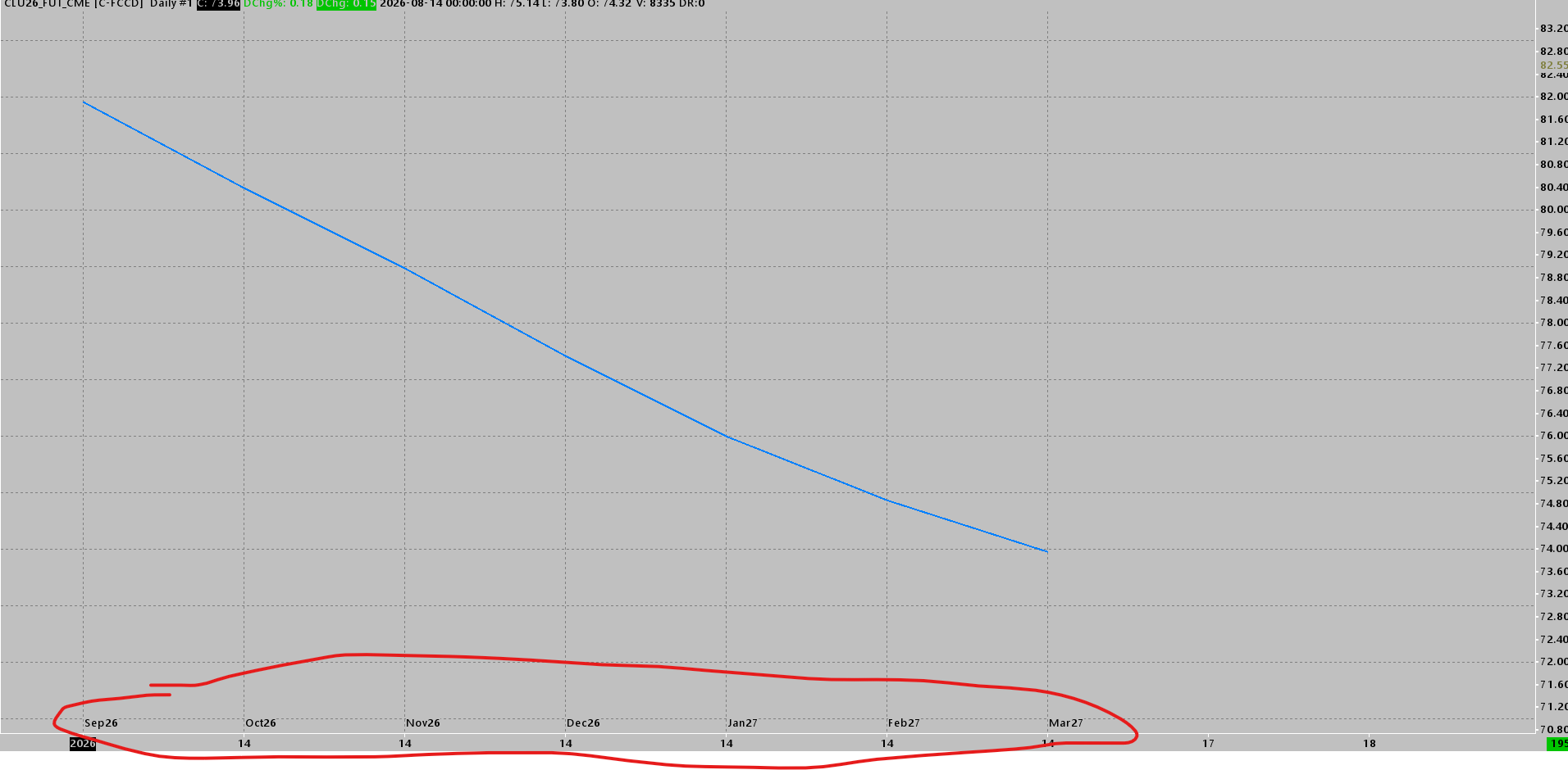

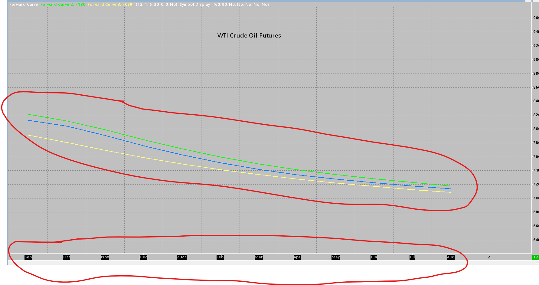

I'm not sure why you don't recommend study, but I do prefer how using study it provide mor months and past forward curves.
imageForwared Curve Contiuous 2026-08-14 133230.png / V - Attached On 2026-08-14 18:36:32 UTC - Size: 63.74 KB - 78 views
imageForwardCurveStudy 2026-08-14 132943.png / V - Attached On 2026-08-14 18:37:38 UTC - Size: 93.33 KB - 81 views
