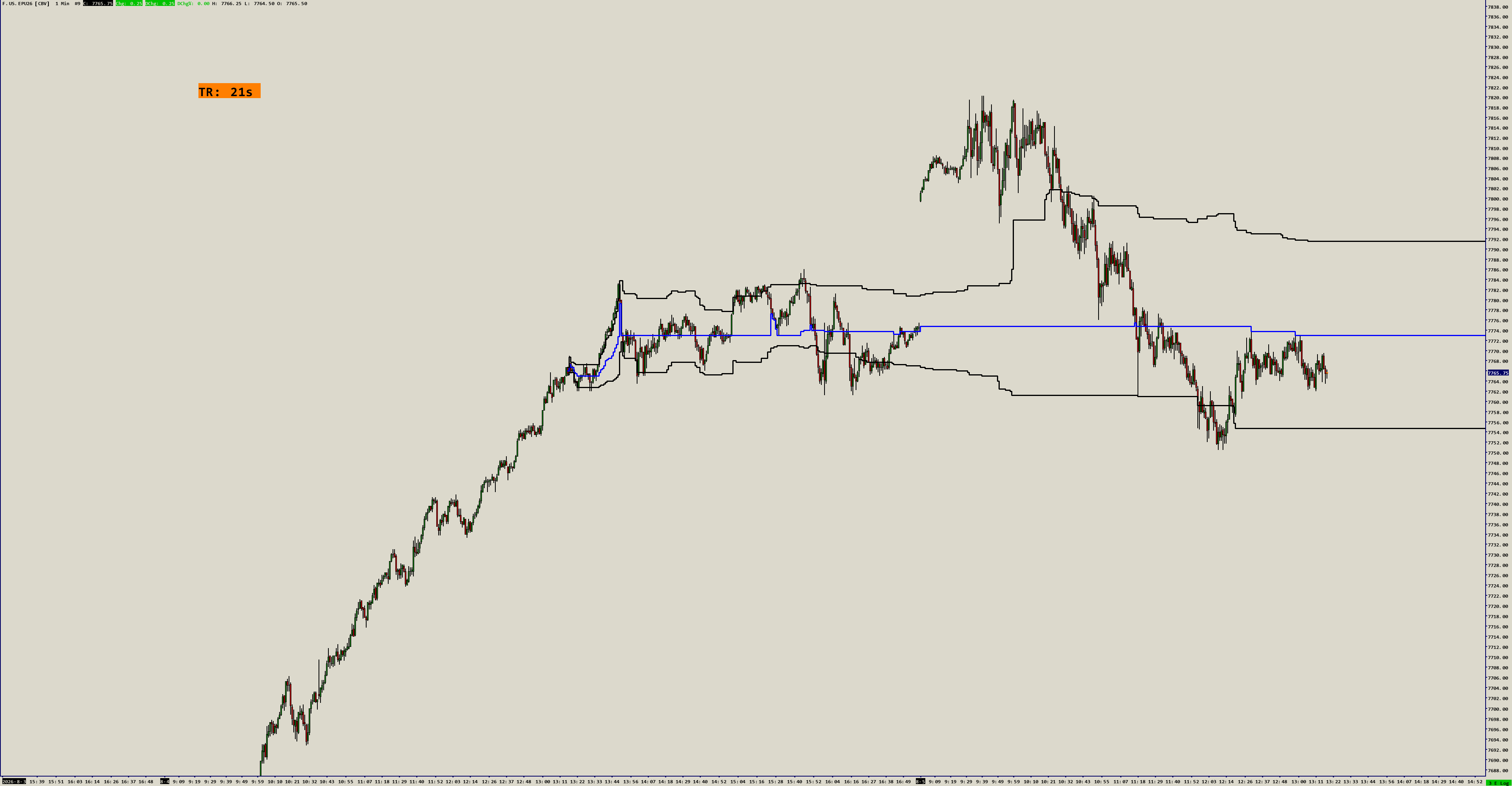

I am using the "TPO Value Area Lines" study and encountering an issue with the starting point of the lines when restricting display to the latest period.
Issue:
When "One Period Only at End of Chart" (In:11) is set to "Yes", the developing Value Area and POC lines do not start at the beginning of the current trading session (09:30 RTH open). Instead, the lines begin far back in the middle of the previous trading day (around 12:55 of the prior day).
Expected Behavior:
The lines should begin calculating and drawing strictly from the start of the current period/session (09:30) through to the end of the chart.
Current Settings:
- Time Period Type (In:3): Days
- Time Period Length (In:4): 1
- One Period Only at End of Chart (In:11): Yes
- Base on Day Session Only (In:15): No
I have attached a screenshot displaying both the study settings and the chart behavior.
Could you please advise if a specific setting adjustment is required or how to ensure the lines anchor strictly to the start of the current session?
Thank you.
imageF.US.EPU26 [CBV] 1 Min #9 2026-08-05 13_18_39.576931.png / V - Attached On 2026-08-05 17:19:30 UTC - Size: 113.46 KB - 113 views

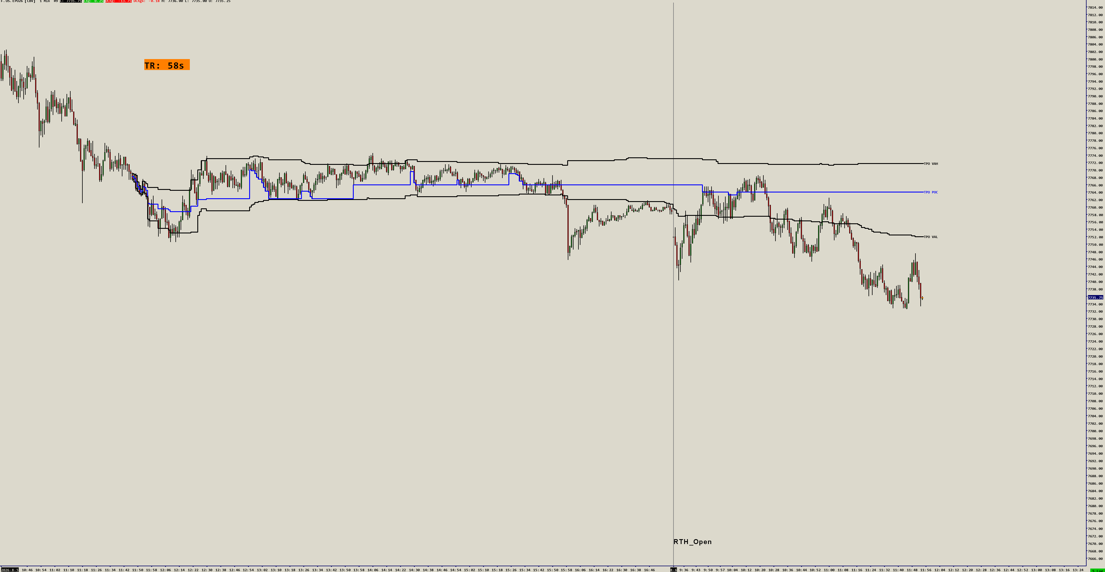

[2026-08-06 06:54:19]
DabashTrading1 - Posts: 7
Hi John,
Thank you very much for the quick response.
Unfortunately, even after setting "Base on Day Session Only" to "Yes", the issue persists. The lines are still starting from the middle of the previous trading day instead of anchoring to the start of the current session (09:30).
Could you please open a chart on your end using standard RTH session times, apply the "TPO Value Area Lines" study, and set "One Period Only at End of Chart" to "Yes"?
Please check if the lines start correctly at 09:30 on your screen, or if they anchor to the middle of the previous day as they do on mine. This would help determine if this is a software bug or a specific configuration issue on my end (such as Chart Session Times - F5).

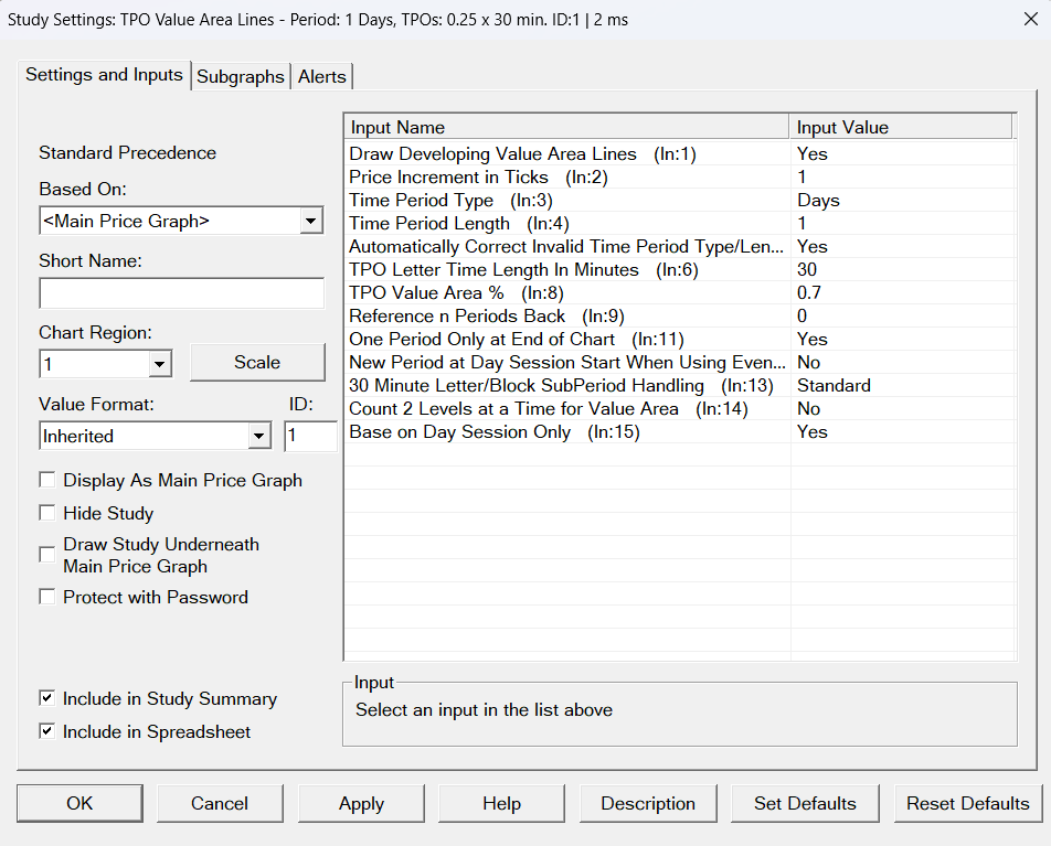

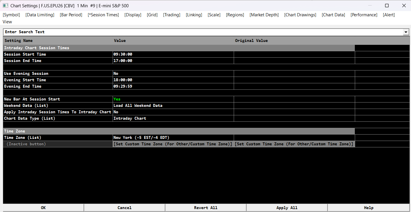

Hi John,
Here are my current Session Times (F5) and settings:
Session Start Time: 09:30:00
Session End Time: 17:00:00
Use Evening Session: No
Time Zone: New York (-5 EST / -4 EDT)
Study Setting: Base on Day Session Only = Yes
I've attached screenshots of my Chart Settings, Time Zone, and Study Settings. Could you tell me which specific setting is misconfigured here?
Thanks!
imageONE.png / V - Attached On 2026-08-06 15:56:08 UTC - Size: 47.74 KB - 92 views
imageTWO.png / V - Attached On 2026-08-06 15:56:12 UTC - Size: 68.02 KB - 86 views
imageThtee.png / V - Attached On 2026-08-06 15:56:17 UTC - Size: 132.19 KB - 95 views
[2026-08-06 16:44:06]
John - SC Support - Posts: 48480
We do not see a reason for you to be having this issue with those settings.
Please get us a copy of that chart by following these instructions:
