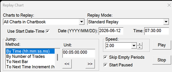

LegoMyGeggo - Posts: 8
Hi John,
Thanks for getting back to me, I attached the settings I have selected when I start my replay. Basically 1 or 2 out of the 3 windows will freeze and I'll try to just wait to see if it's still buffering data etc, but they're just frozen. However, I can move the 3rd chart that is not frozen so I'm not sure why only specific charts are freezing up.

John - SC Support - Posts: 48459
One of the items that we see is that you have the option for "Skip Empty Periods" enabled. When replaying multiple charts, this will cause the charts to become out of sync. Refer to the following:
Replaying Charts: Skip Empty Periods
Please disable that option.
The other item of note is that you are starting the replay from a set date/time. Make sure all the charts have data loaded going back to that time.
