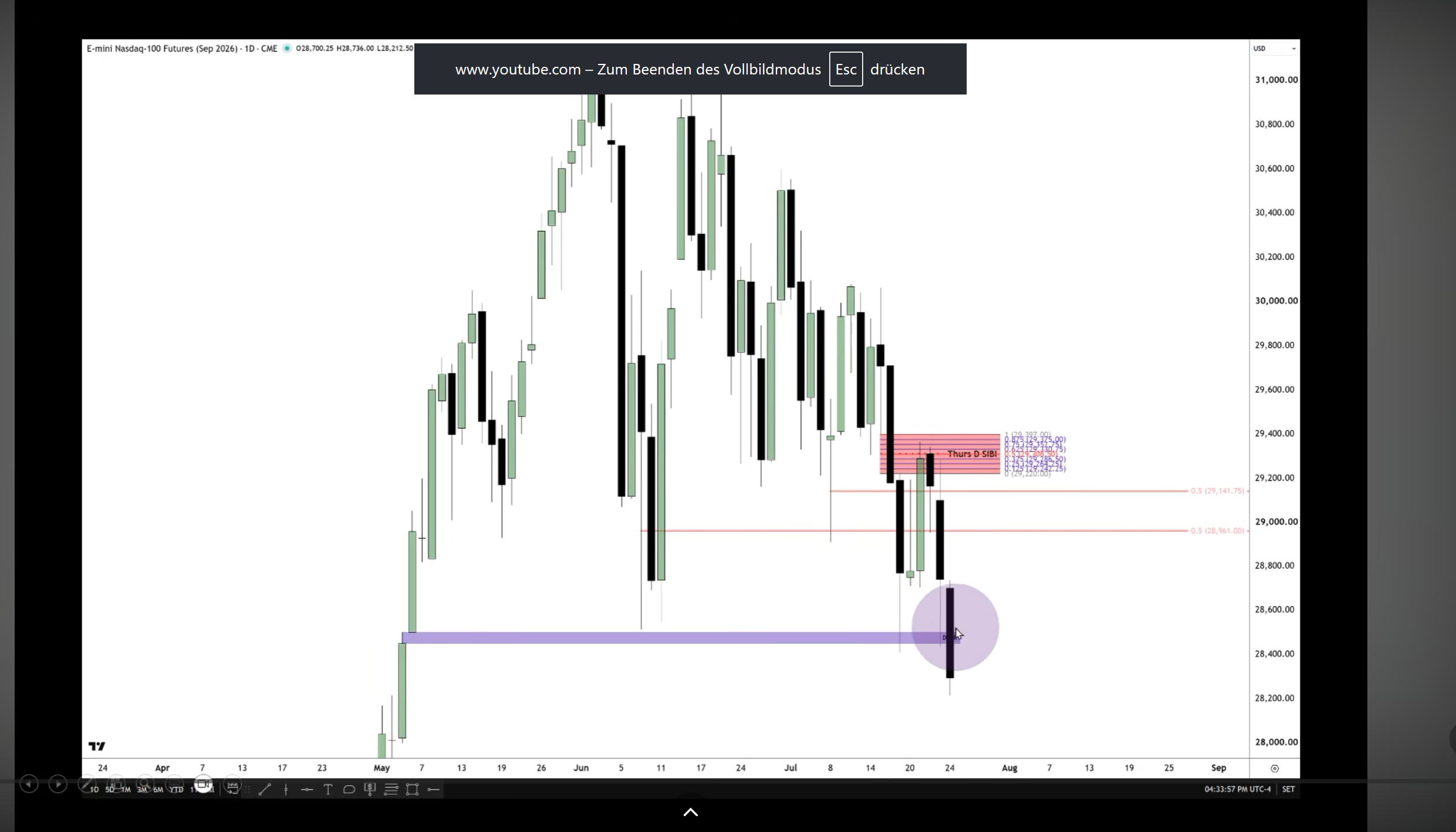

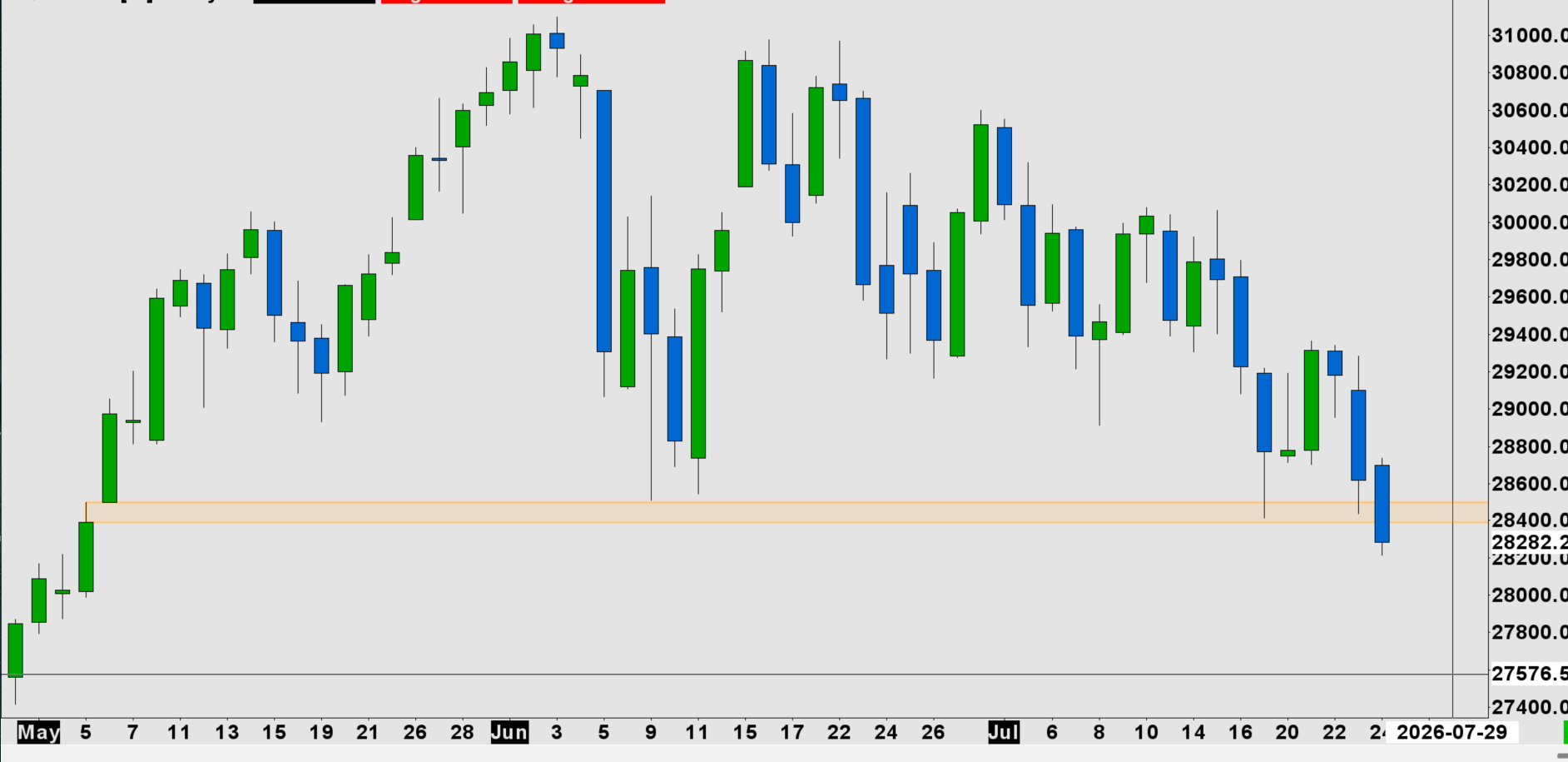

As you can see in the attached files i tryed to redraw ICT's gap from the 05-06.05 daily chart. i allready tryed around. intrady charts are completly off and historical charts without back adjustments (none) is what you see in my screenshot and that is closest i could get.
but still you can see rly clearly differneces in candels and also the gap is way bigger on my chart then on his chart. wigs stay on my chart in the gap zone and on his chart they got allready trough it at the dates 23.07 and 17.07.
i would rly like to match them bc its essential for lower time frame entrys. i hope its somehow possible.

imageICT chart.png / V - Attached On 2026-07-25 12:36:03 UTC - Size: 377.88 KB - 75 views
imageMy sierra Chart.png / V - Attached On 2026-07-25 12:36:07 UTC - Size: 142.18 KB - 85 views
[2026-07-27 15:12:50]
John - SC Support - Posts: 48317
We do not do comparisons to other systems. There are too many possible reasons for differences - including issues with the data itself.
If you are getting your data from our Denali Exchange Data Feed (we assume you are, but we can not see the top of the chart to know for certain), then the data is correct and matches the exchange.
You mentioned the "back adjustments", so that is the one place where you will have to make a personal decision on how you want your data. Refer to the following:
Continuous Futures Contract Charts: Introduction
