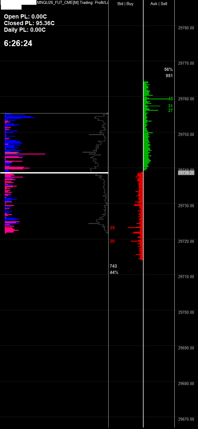

I would like remouve space on the left of "left study (blu and fuxia bars study)"
there is a sort of padding betwen the left side of chart and the left study (somthing else of 5 pixel to remouve)
thankyou very much
Andrea
https://www.sierrachart.com/image.php?Image=1784175986194.png

What study is it that is drawing those bars?
VbP - volume by price
Is that a Chart or a Trading DOM?
it is a chart (it is similar as a trading dom , but it is a chart)

This is how Sierra Chart draws that profile on the left side. It is aligning with the center of a chart bar, which is why it is slightly offset from the actual left edge.
You can mitigate this somewhat by shrinking the bar spacing (making more bars viewable). Even though you do not have bars showing, this will still affect that study. Refer to the following:
Working With Charts: Changing Bar Spacing
