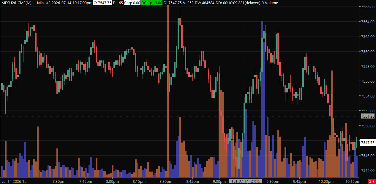

Hi Sierra Support Team,
I would like to place my Volume Bars (from Volume Study) onto Region 1, along with my chart - to save vertical space and fit more chart space in (no need for a full Region 2 for Volume Bars).
I have got close - however, the tallest VolumeBar takes up 100% of the height of Region 1.
https://www.sierrachart.com/image.php?Image=1784039579155.png
Am I able to compress this to say 30% of Region 1's vertical height?
- Changing the "Scale Padding Percentage" under Scale Settings to max (99.8) had no effect
Date Time Of Last Edit: 2026-07-14 14:37:56

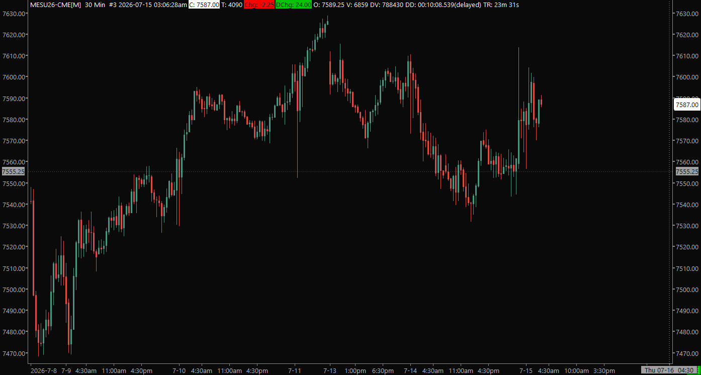

Hi John,
I have gone ahead and implemented the changes that you have suggested - but am still struggling to achieve the desired outcome.
1) Starting from a new blank intraday chart - I have changed "Use Left Side Scale" to YES under [Chart Settings] > [Scale]

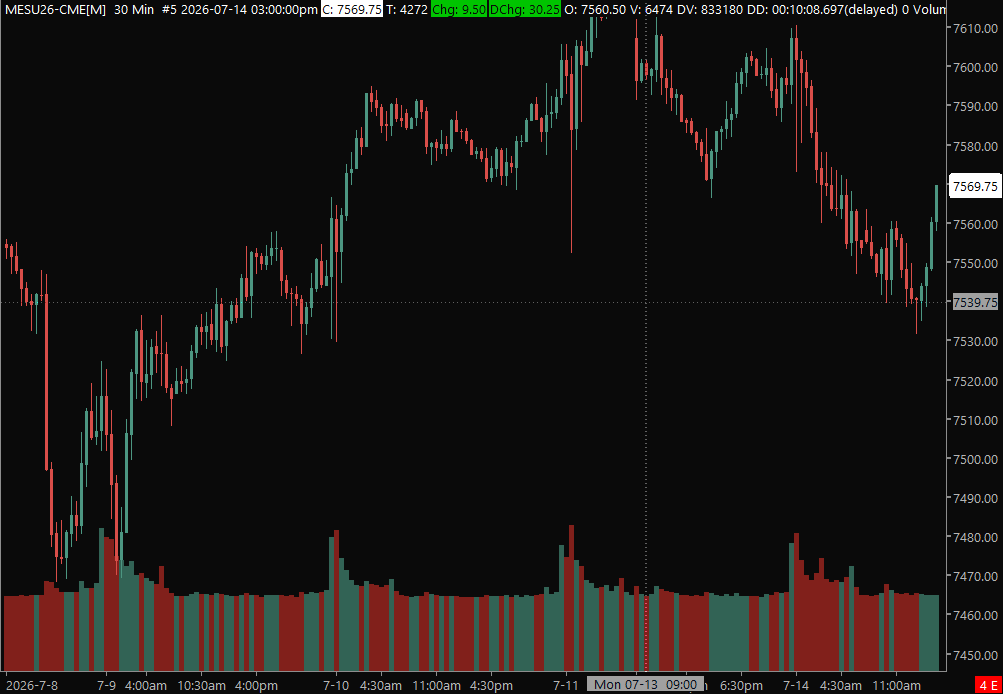

3) Used my mouse to drag the left-axis to the desired height of the chart, and manually dragged to re-base at 0
https://www.sierrachart.com/image.php?Image=1784049860333.png
So far so good!
4) From here is where I'm struggling . When you say "Remove the Left-Side Scale" - how is that done?
By assuming you mean go into [Chart Settings] > [Scale] > Change [Use Left Side Scale] now to NO - then the result is as the other user has noted: when I drag the chart using the Hand tool - the Volume bars become distorted:
https://www.sierrachart.com/image.php?Image=1784052825902.png
Noting that I have left [Studies] > [Volume] > [Settings] > [Scale] > Remained Ticked in "Use in Left Side Scale". And Remained "Independent".
What am I missing here? I feel like we are so close, but just not quite there yet!

This is quite interesting, as I did find what is occurring.
It turns out that I just happened to have a chart with the Main Price Graph set to "Independent", which was the test chart I was working with. Turns out that this is the last piece to the puzzle. So both the Main Price Graph and the Volume study need to be set to "Independent" in order to have the Volume study not adjust with the Main Price Graph.
But, even with it set this way, we do see that when you "Reset" the scales for the Main Price Graph, the Volume study will also reset and fill the screen. You can partially remediate this by setting the "Default Padding Percentage" for the Volume Study to a value such as 60 or 70. But, when you reset, this will help to keep the bars at a certain height, but the center of the scale will move up such that 0 is in the center of the window.
Therefore, in the end, there is no perfect solution. The best option is to use a separate Region.

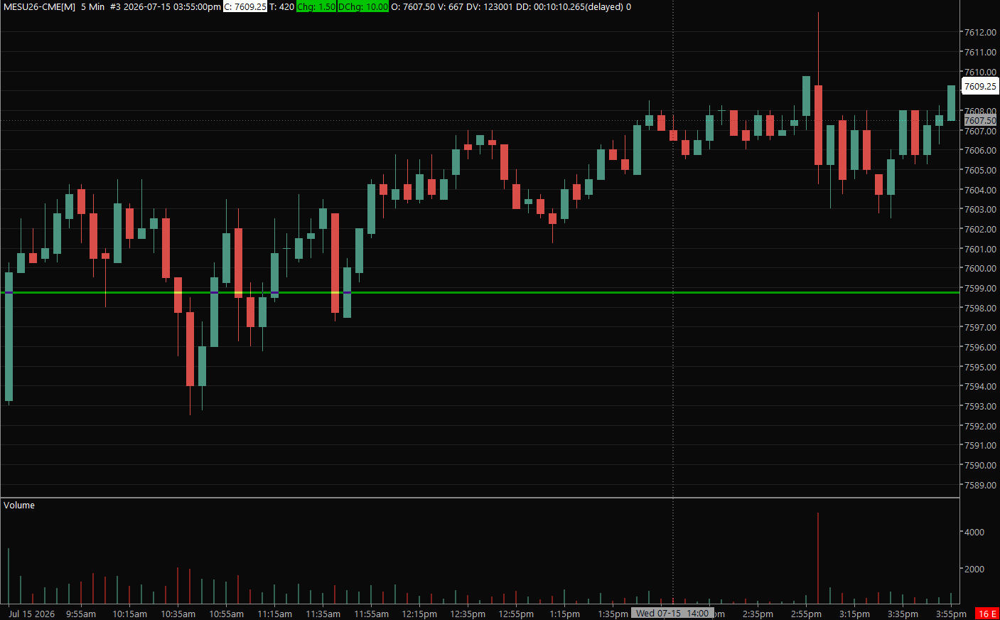

However, in the meantime, can you please help me with something else:

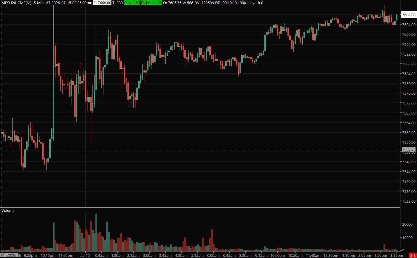

Is there a way to format the volume bars in the Volume Study - so that the rectangular bars are separated by a tiny bit of space, like I have in the below image:
https://www.sierrachart.com/image.php?Image=178411277798.png

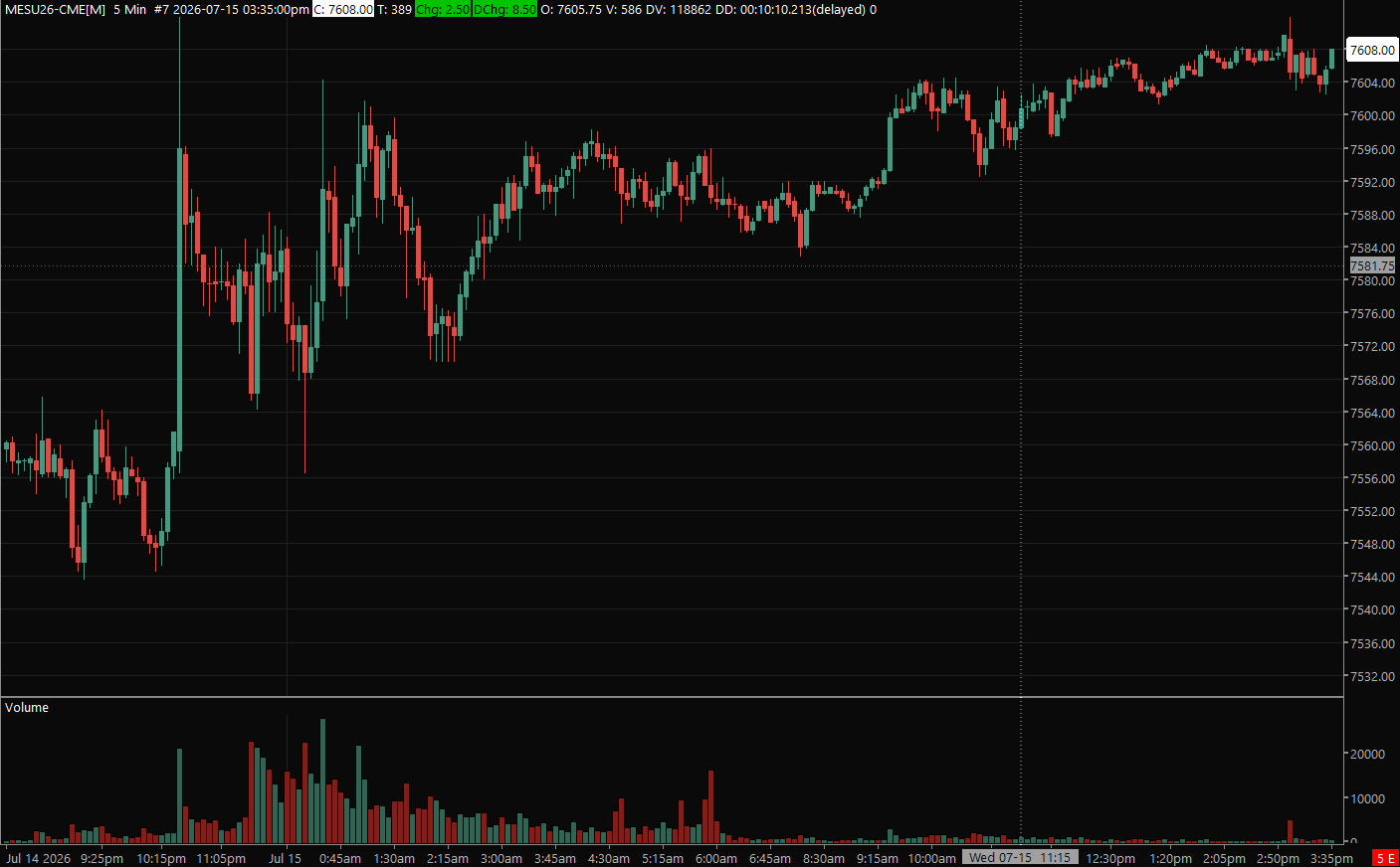

Without it, it looks like this (which is not desirable):
https://www.sierrachart.com/image.php?Image=178411492577.png
Currently I am superimposing two Volume studies - 1) one for the rectangular red/green volume bars (Draw style = Fill Rectangle Bottom), and 2) a separate Volume study with Draw Style = Box Bottom Centre (black) as the border around the bars (to create the illusion of that separation between the bars).
Can I do this with just one Volume Study?

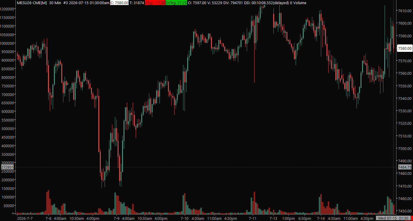

PS. I shifted away from Draw Style = Bar, because the bars were too thin, and the gaps between them were too wide when zoomed in, see screenshot below:
https://www.sierrachart.com/image.php?Image=1784115179105.png
- I am instead trying to go for a look where the volume bars fills the width of the corresponding candle (no matter how zoomed in/out), whilst also having a tiny gap in between them to show separation of adjacent volume bars.
Date Time Of Last Edit: 2026-07-15 11:34:50

John - SC Support - Posts: 48239
There is not a way to do this with the Volume study itself.
What you are doing is a good solution for this.
