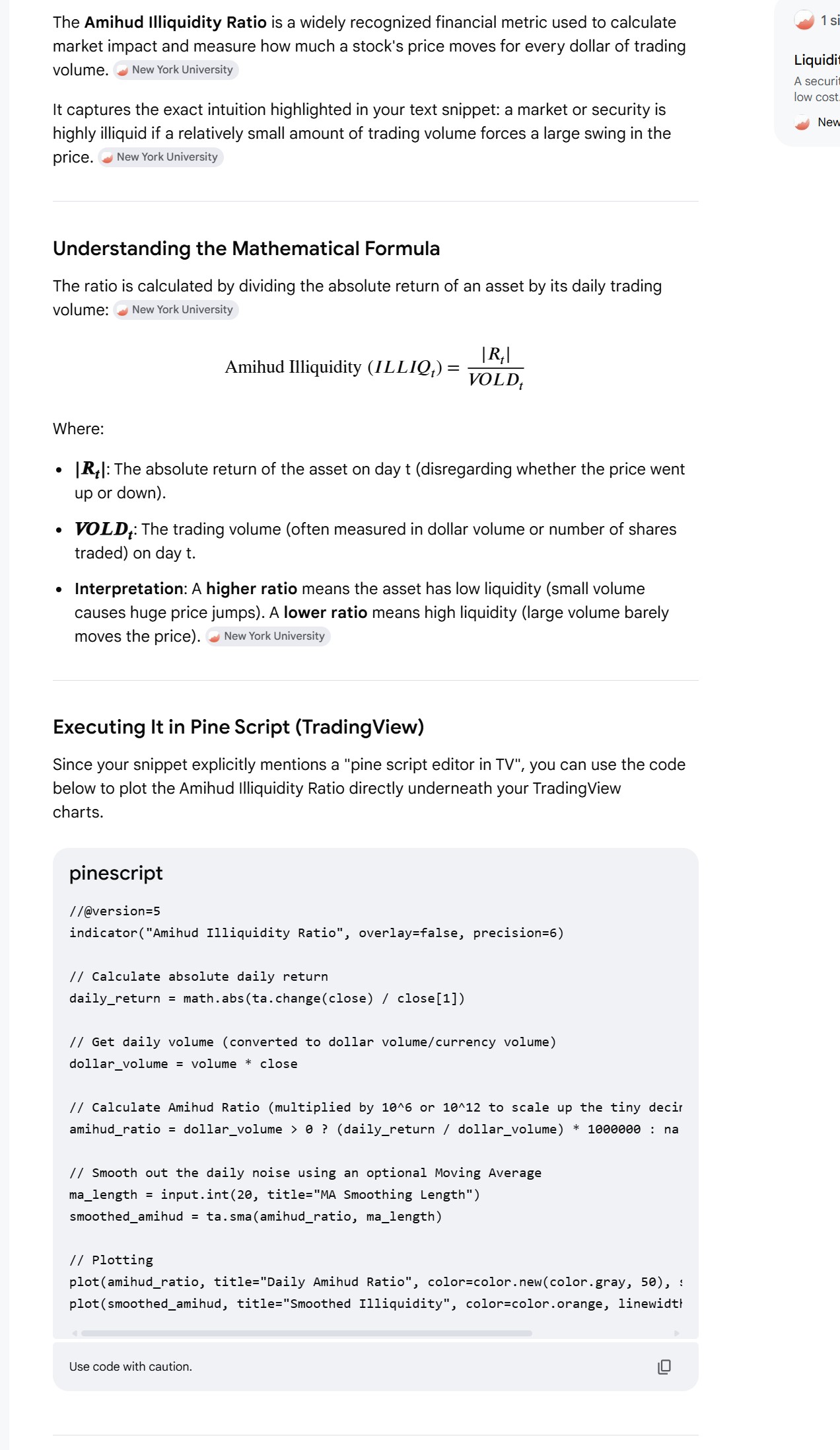

Dear John, or anyone who could answer
Is there anything like this on SC? Would it be hard to turn this TradingView script into something usable on SC
thank you anyone
imageamihud.jpg / V - Attached On 2026-06-28 18:52:21 UTC - Size: 355.22 KB - 108 views

We do not think we have a study that does this directly. But we do have over 500 studies, so it's possible something might exist that we are just not familiar with. We recommend looking through the list of studies or doing a search and see if something turns up on our site. The list of studies is here:
Technical Studies Reference
But you could create this from a few existing studies. You just need to get the open for the day and the current close to get the return of the asset for the day. Then you need the volume up to that point, which could be gotten from the Cumulative Daily Volume study.
