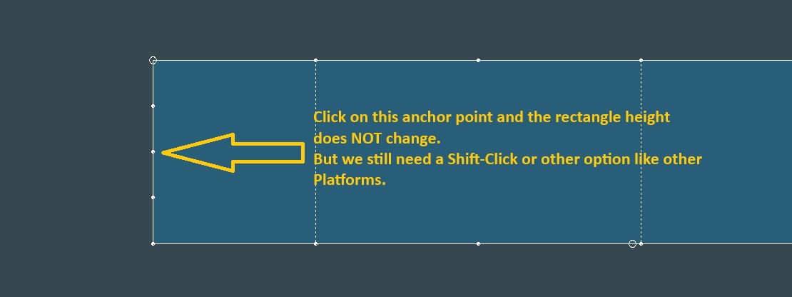

User708541 - Posts: 209
See the attached image for how to size a rectangle without changing the height.
imageClick here for rectangle sizing.jpg / V - Attached On 2026-06-17 17:02:21 UTC - Size: 48.39 KB - 126 views
[2026-06-17 17:26:38]
John - SC Support - Posts: 48408
What User708541 states will work. We had forgotten that you can select the rectangle and select those points. You do have to have your Drawing Tool set to "Pointer", "Crosshair" or "Hand", and first left-click in the rectangle on the left 1/3 or right 1/3, then you can grab an edge and drag it.

User92573 - Posts: 622
Thank you both but neither solution works.
Whether selecting with left click pointer etc, or shift + click the rectangle will still re-size.
Granted if you have a rectangle with a centre dot i.e., 3,5,7 etc dots, but not with an even number.
In most window programs User708541 is correct and using shift will also create a straight line from a sloping line. Really useful.
Unfortunately, in Sierra, this doesn't work.
Keeping my fingers crossed for a feature update to mirror this operation.
Date Time Of Last Edit: 2026-08-03 17:34:15
imageSierra Chart Rectangle.png / V - Attached On 2026-08-03 17:34:08 UTC - Size: 775 B - 53 views
[2026-08-03 21:24:51]
We are not understanding this. With a Rectangle/Extending Rectangle, if you have the "Pointer", "Crosshairs", or "Hand" tool selected along with the setting for "Tool >> Tool Settings >> General >> Support Left Click to Select Chart Drawings" set to "Yes", then you can select the rectangle and grab one of the points on the "edge" and then change just that edge.
We do not see how the number of points that displays on the edge has anything to do with how this functions.
How is this not working for you?
With the "Line" tool active, hold down the "Ctrl" (Control) button to force the line to be horizontal or vertical (i.e. it will only allow for 0, 90, 180, and 270 degree locations).
