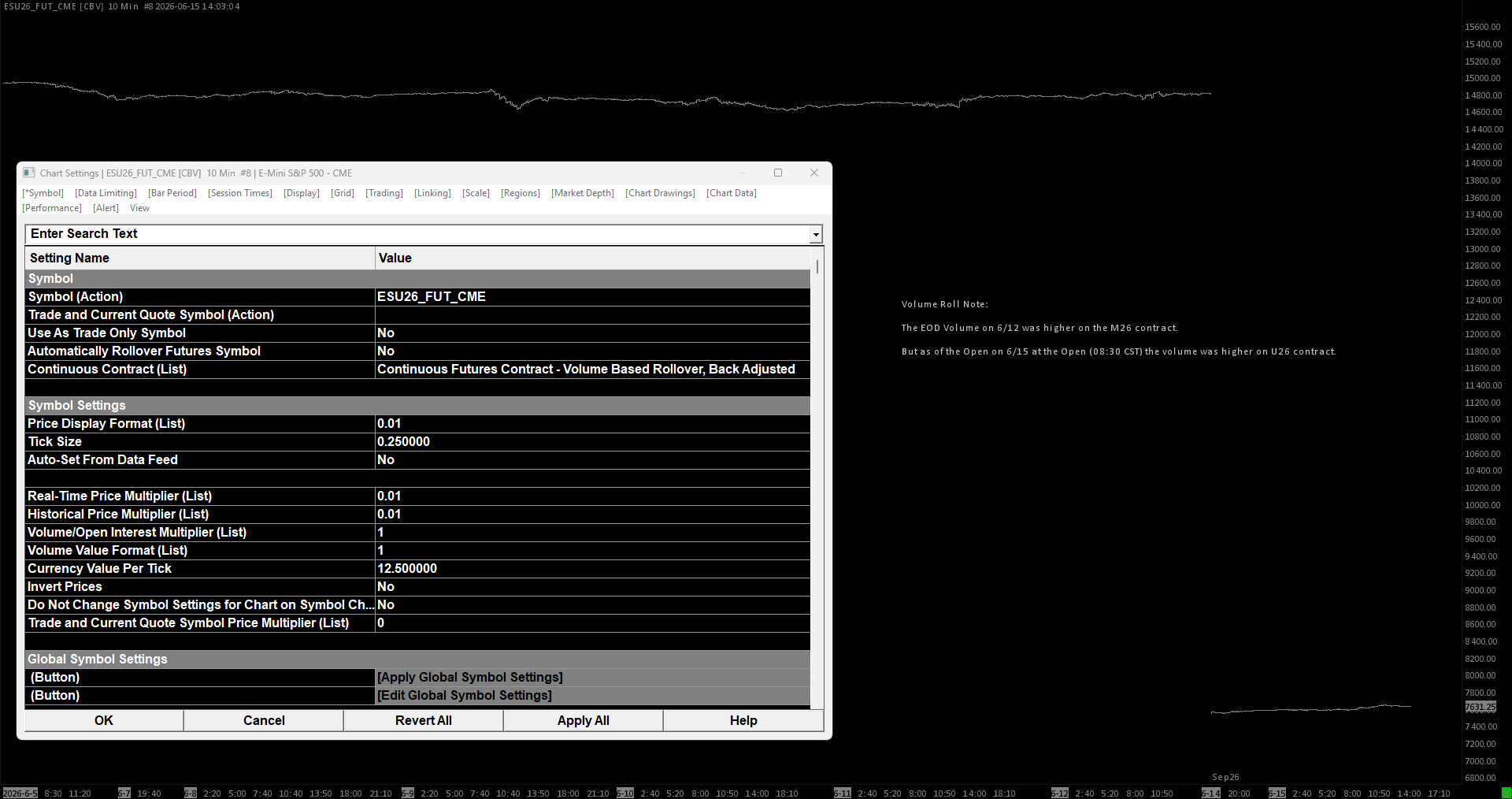

[2026-06-16 17:11:04]
kvcornie - Posts: 56
Sorry for late response, I thought I posted yesterday. Still having issue today. Please see screenshot.
https://www.sierrachart.com/image.php?Image=1781550186574.png
[2026-06-16 20:03:49]
John - SC Support - Posts: 48461
Please follow these instructions to delete all the data in the chart and redownload:
[2026-06-17 13:42:29]
This worked, thanks!
Based on my experience with these steps, it might be helpful to mention up front that this process should be completed in the main DTC Server instance of Sierra Chart.
It didn’t occur to me initially, and I first did this in the instance where the issue was occurring, which didn’t resolve the problem. Once I repeated the process in the main instance and did the final "Delete All Data and Download," the issue was fixed.
I did see the note about instances in Section 7, but I still didn't make the connection at that point. This was definitely a rookie mistake on my part, but adding that clarification near the beginning might help others avoid the same mistake.
Thanks again!
