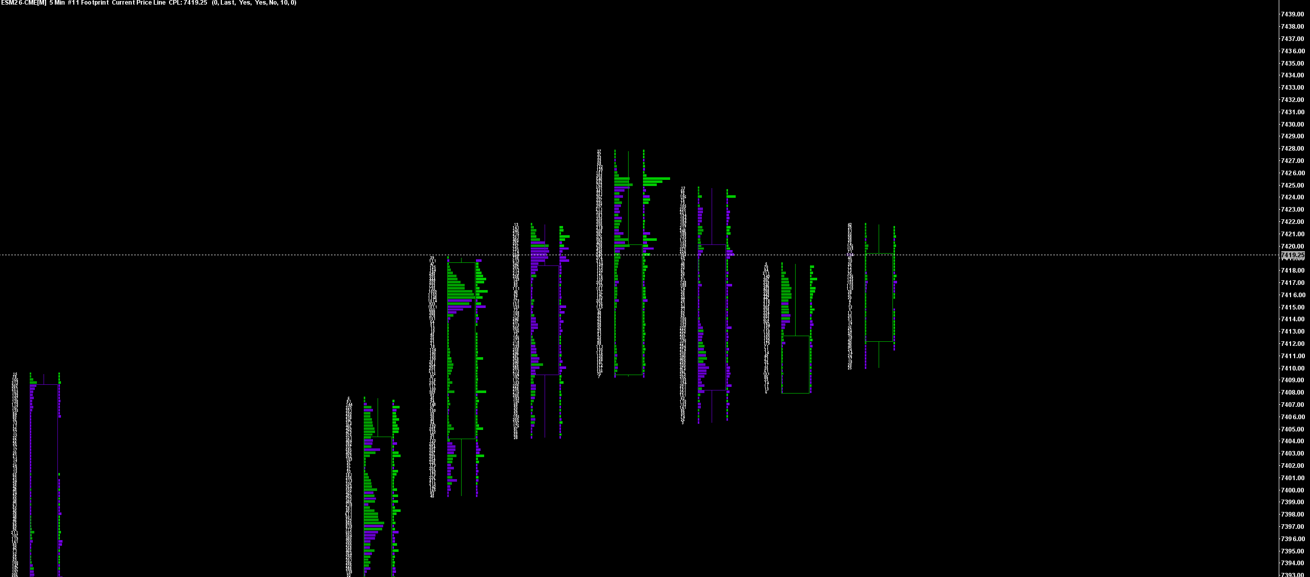

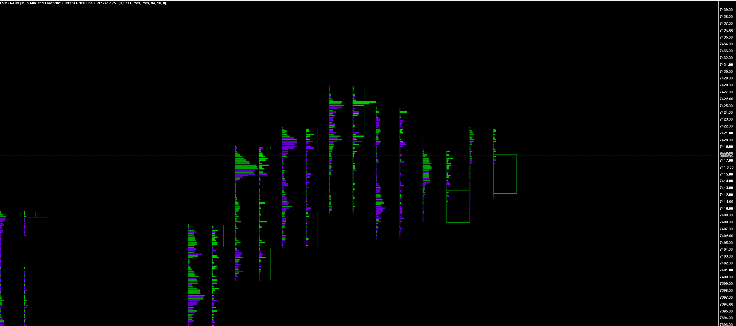

Hi! I'm finding a problem with the footprint chart. I would like to have a 5 minute candlestick chart with inside the candle or on it's side the delta profile and the volume profile. The best solution i found is using the footprint study, but when i try to set it up it is displayed incorrectly. When i set the text to on, for example with volume, everything is understandable and easy to read, but when i remove it the bars look strange because the candlestick get on the delta profile instead of the volume profile.
See the files to understand more. I also wanted to say thanks to the sierra's support, it's the fastest and the best among all.

If we are understanding your issue, then the problem is where you have the candle outline being displayed. You must have it set to be in "Column 2". So when you have Column 1 showing the text, the candlestick is drawn in the middle column. But when you remove the text from Column 1, everything shifts, so the candle stick is now being drawn on the second column that is displayed.
To fix this, if you are not displaying the text, then change the display of the candlestick to be in "Column 1". Refer to the following:
Numbers Bars: Place Open Marker / Boxes In
