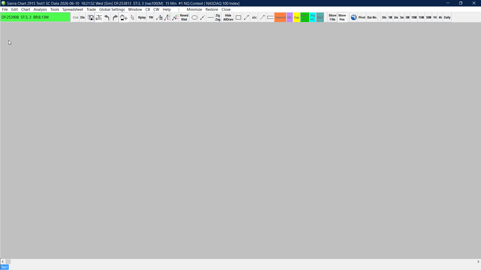

[2026-06-10 17:31:22]
amirN - Posts: 171
I am at a loss here. I have removed all studies and set the chart to automatic. Still nothing. If I change the symbol to anything else again nothing is displayed (not even the candles). I am uploading the modified chart plus a picture of what I see (needless to say it is displayed correctly in version 2904).

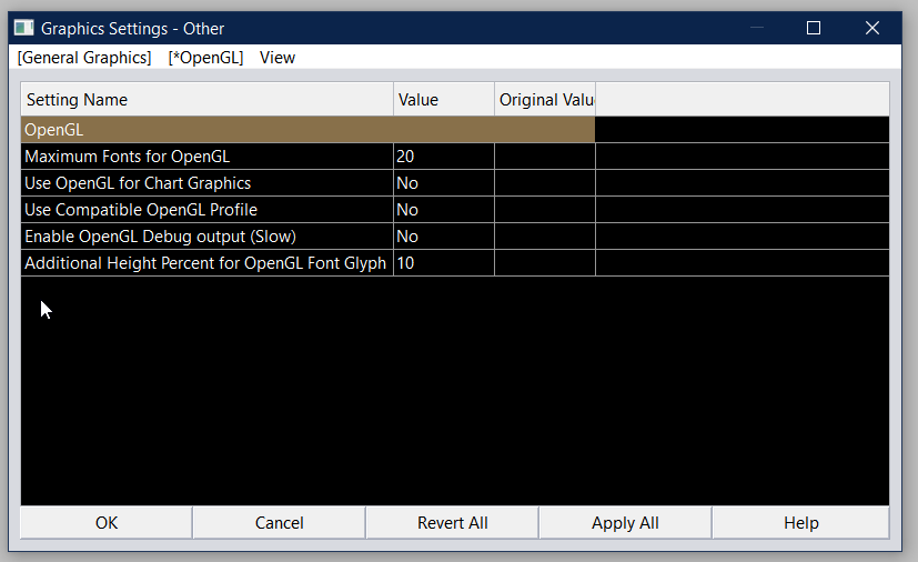

[2026-06-10 18:32:27]
Sierra_Chart Engineering - Posts: 25390
Do you have OpenGL enabled do you know?
Refer to:
Graphics Settings: Use OpenGL for Chart Graphics
Disable OpenGL and restart Sierra Chart.
[2026-06-10 18:42:54]
amirN - Posts: 171
I don't think so. As a last resort, I have copied the entire sierrachart directory into another drive and then upgraded the second copy to 2915. Therefore, I suppose all the settings should have remained the same. But here is a picture of that menu.
I have to stress the problem is only with this chart, as all my other charts are displayed correctly. There is something in this chart that is upsetting the new Sierrachart and prevents correct display.

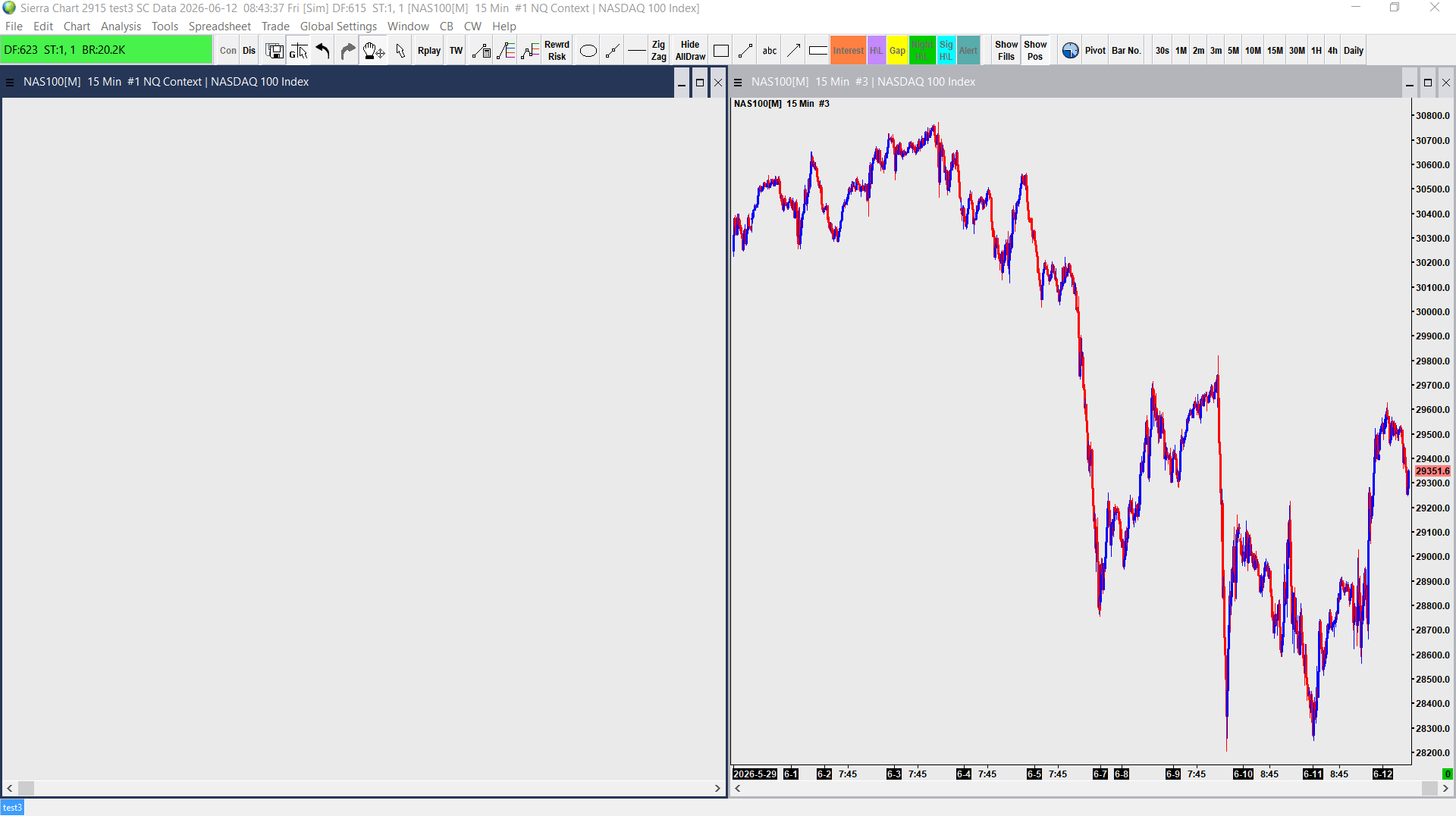

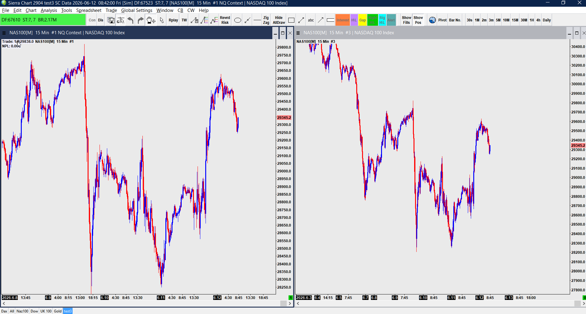

[2026-06-12 07:49:44]
amirN - Posts: 171
I have opened another chart in that chartbook pointing to the same symbol. Both charts have no studies and no drawing. same time zone and session time. I am attaching the chart book and the display in both version 2904 and 2915. As can be seen the problematic chart (the left one) is not displayed in 2915.
Date Time Of Last Edit: 2026-06-12 07:50:21

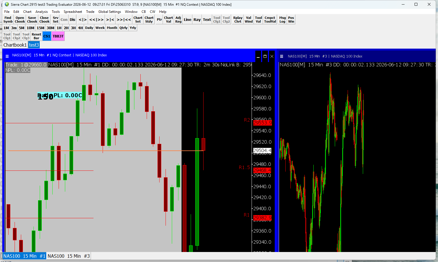

[2026-06-12 14:30:09]
We are not able to see any issue with that chart. Attached is exactly what we see when we open the latest chartbook you supplied, which shows the chart just fine.
Since we are not able to reproduce this, we do not have anything we can do to "resolve" this issue. Since this is one chart you are having an issue with, you will just have to redo the chart.
imageSierra_Chart_MainWindow_2026-06-12 09_27_30.505.png / V - Attached On 2026-06-12 14:30:04 UTC - Size: 85.25 KB - 160 views
