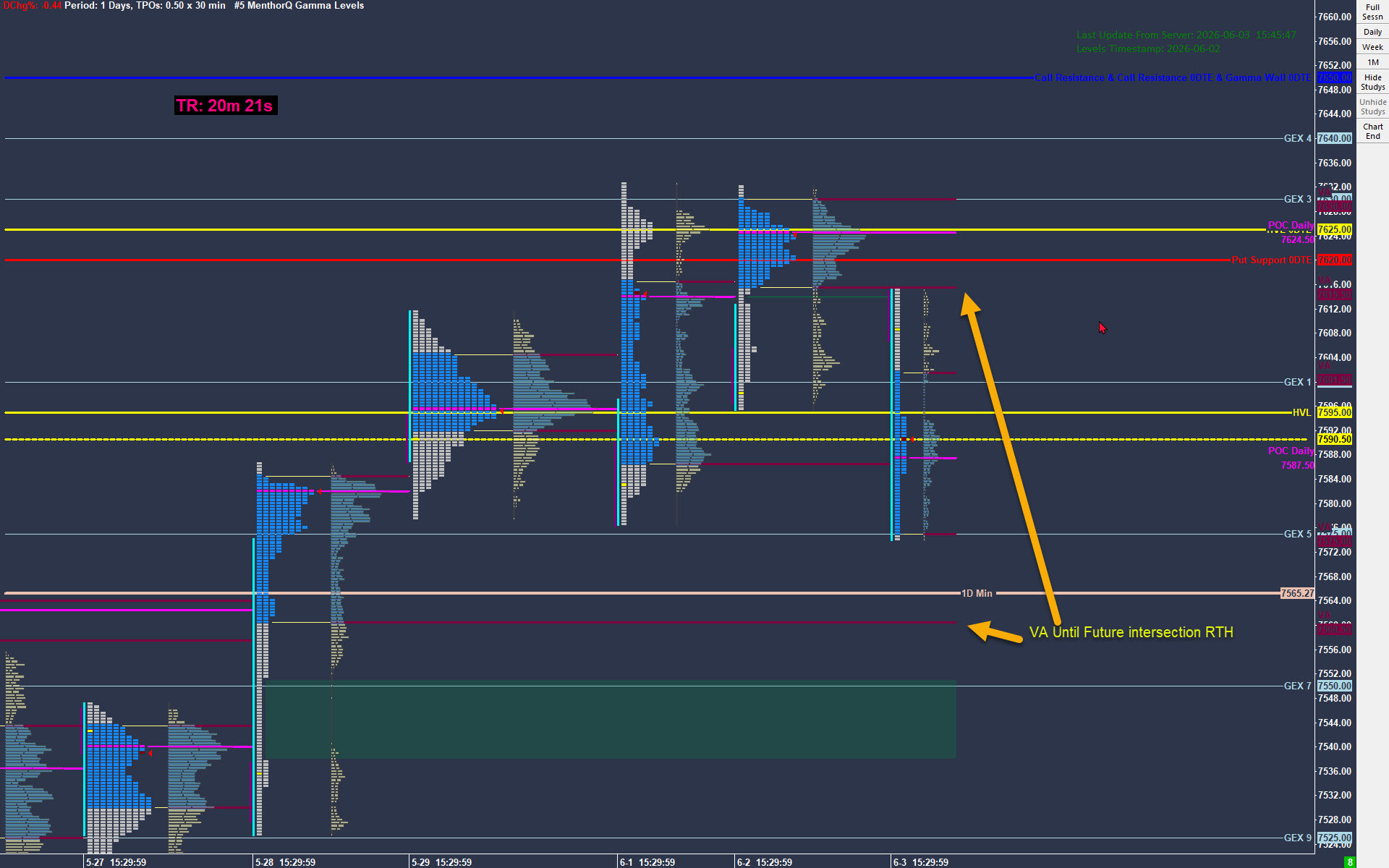

I would like the Until Future Intersection VA and POCs for the RTH to be displayed on the 1-minute chart—for the last few days, weeks, and months.
I’ve been plotting these manually so far, but it takes a lot of time. Is there a way to automate this?
Thank you very much for your help.

image2026-06-03_16-50-52.jpg / V - Attached On 2026-06-03 15:01:17 UTC - Size: 215.32 KB - 116 views
image2026-06-03_16-51-08.jpg / V - Attached On 2026-06-03 15:01:40 UTC - Size: 531.25 KB - 148 views

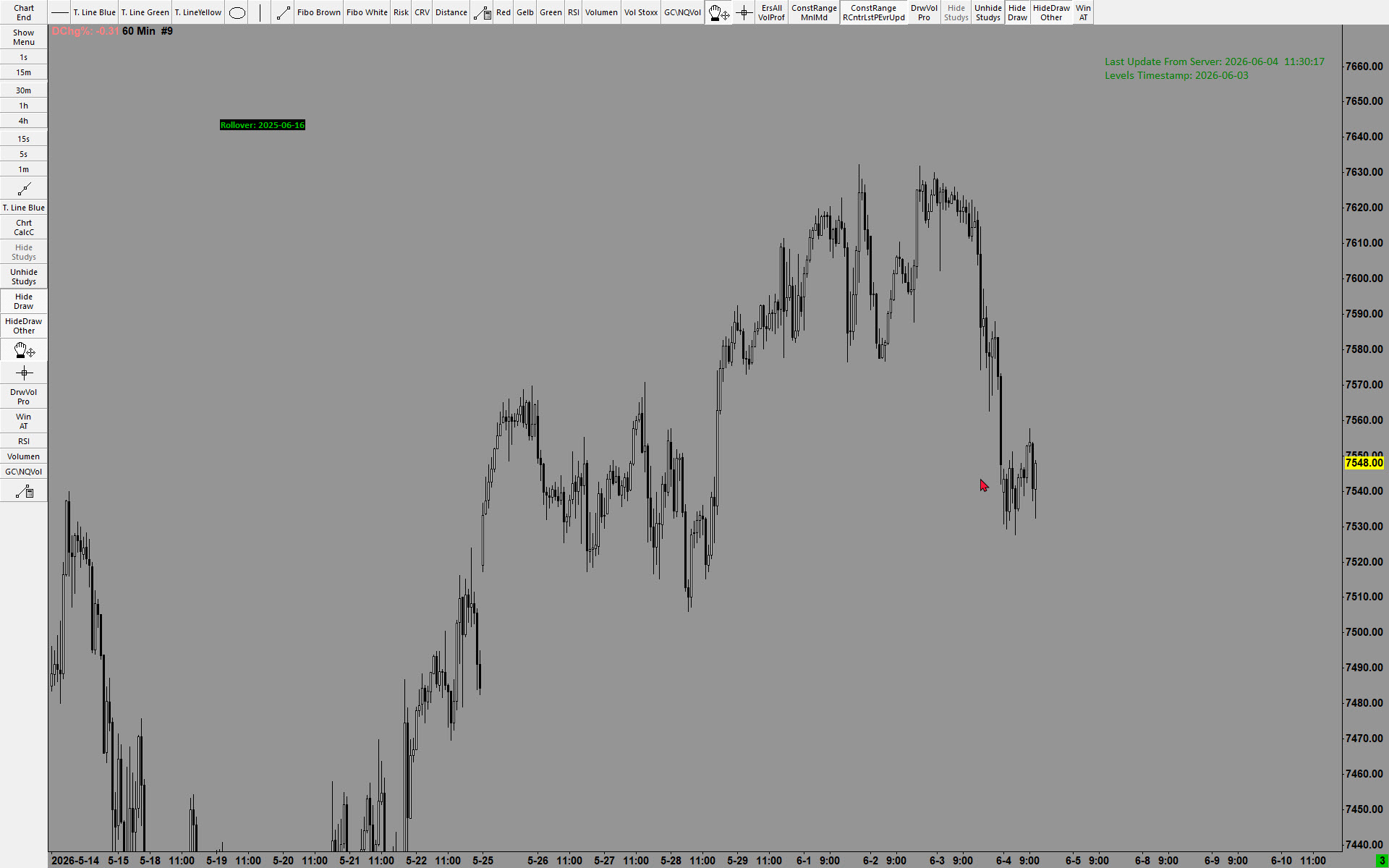

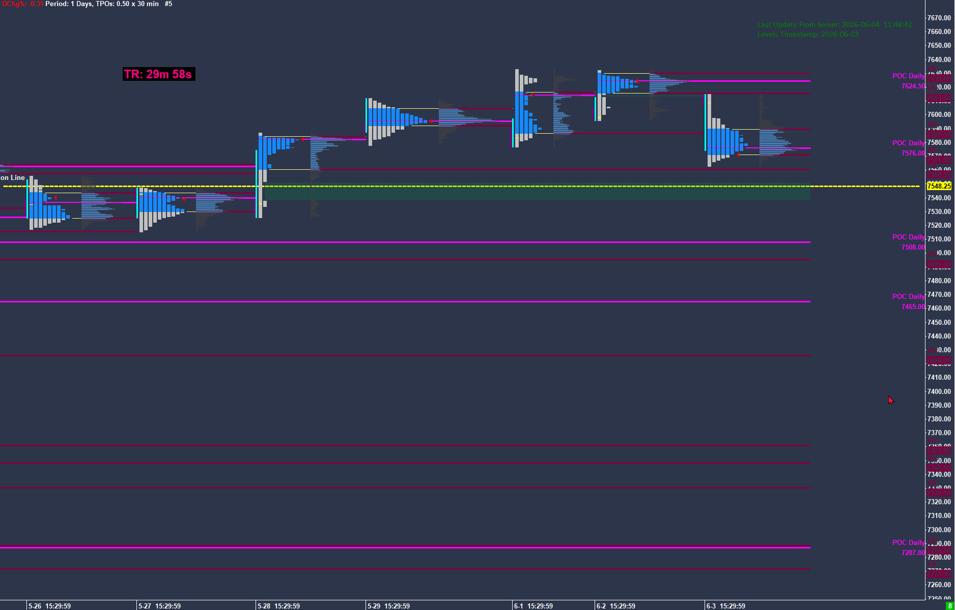

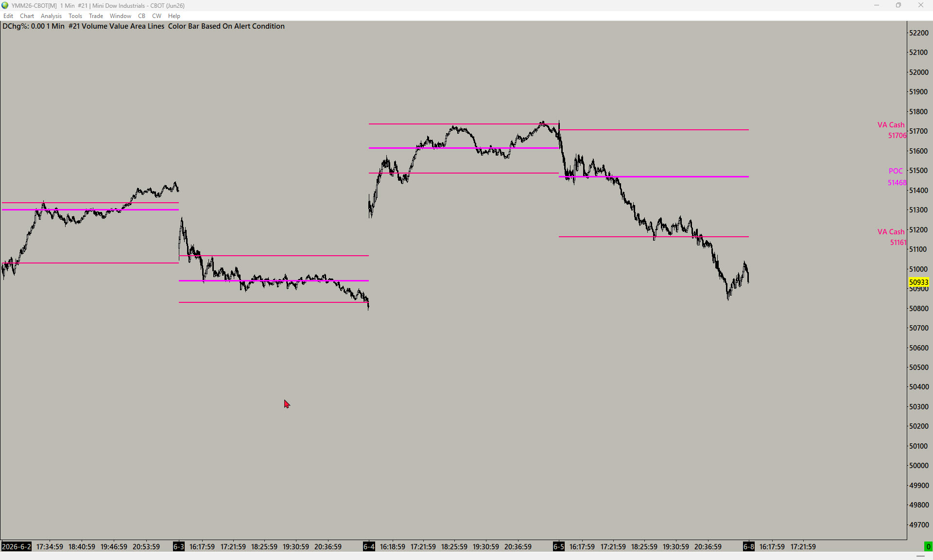

I would like RTH to display the “Lines Until Interception” for
VA and POC from the last few days, weeks, and months. I am only interested in the lines, not the profile.
See the TPO chart for an example. These lines should be visible on the 60-minute and 1-minute charts in RTH.
Please note that the 24-hour chart should continue to be used.
image2026-06-04_11-51-26.jpg / V - Attached On 2026-06-04 09:51:41 UTC - Size: 228.39 KB - 98 views

[2026-06-04 14:29:11]
If you want to see the Value Area and POC lines without the profiles for just the RTH session but displayed on 24 hour chart, and you want to have those lines extend until future intersection, then you would need to do the following for this.
- Open a new chart for the same symbol and set it to only use the RTH session.
- Add the "Volume Value Area Lines" study to that chart.
- Use the "Study/Price Overlay" study to overlay the "Volume Value Area Lines" study from the RTH only chart to your 24 hour chart.
- Use the "Color Bar Based on Alert Condition" to generate the extension lines for the overlaid study (see specific information in link given below).
Refer to the following:
https://www.sierrachart.com/index.php?page=doc/StudiesReference.php&ID=209#top
Study/Price Overlay Study
Color Bar Based on Alert Condition: Creating Extension Lines for Another Study

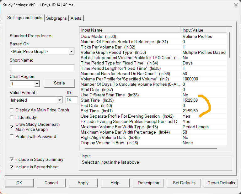

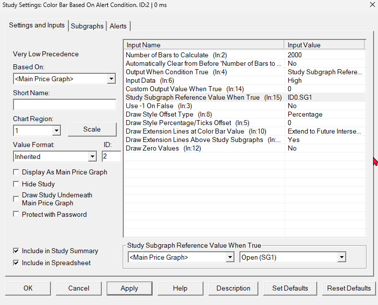

Leider funktioniert die Linienerweiterung Intersection nicht. Welche Einstelung muss ich durchführen? Ich habe alle Möglichkeiten ausprobiert.

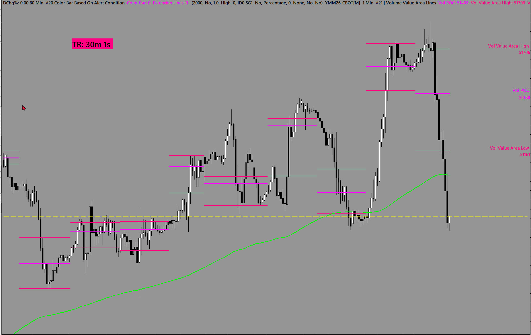

image2026-06-07_18-19-21.jpg / V - Attached On 2026-06-07 16:23:05 UTC - Size: 207.69 KB - 169 views
image2026-06-07_18-19-30.jpg / V - Attached On 2026-06-07 16:23:09 UTC - Size: 169.54 KB - 166 views
image122.jpg / V - Attached On 2026-06-07 16:23:36 UTC - Size: 198.67 KB - 165 views
[2026-06-08 15:02:36]
In the "Color Bar Based on Alert Condition" did you enter an Alert Formula of "=1", per the last step at this link:

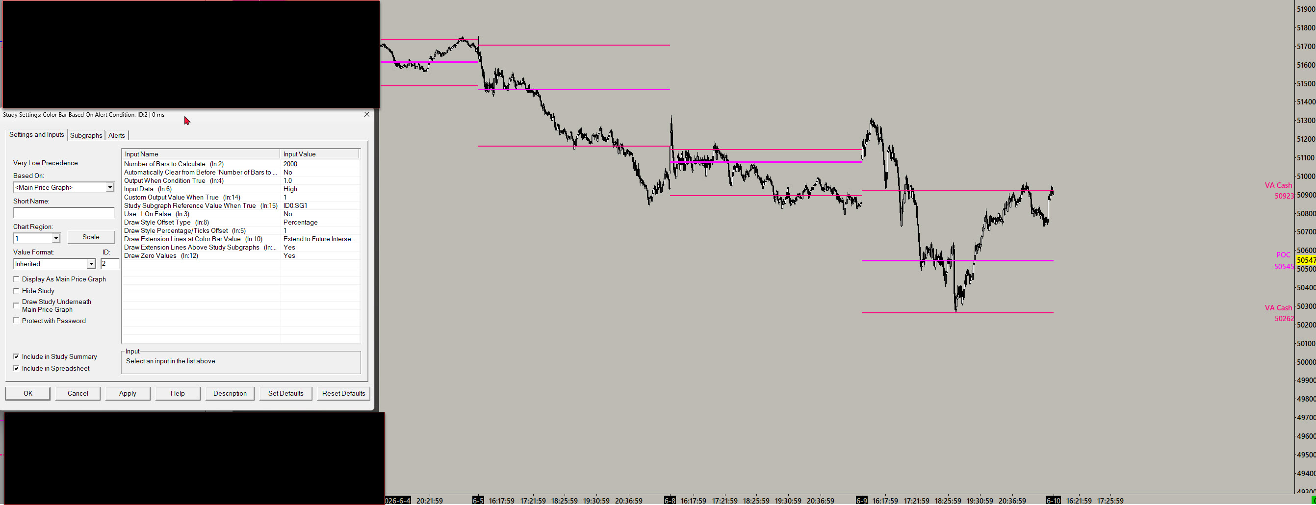

Hallo

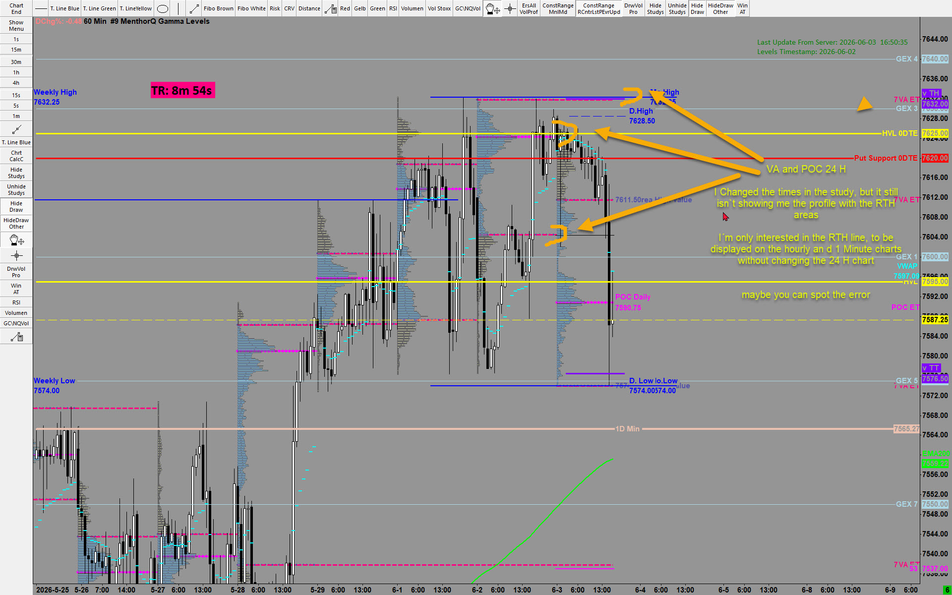

Also anbei die Einstellungen. Irgendwie funktioniert es nicht.
image2026-06-10_12-14-48.jpg / V - Attached On 2026-06-10 10:16:12 UTC - Size: 360.66 KB - 102 views
[2026-06-10 14:46:53]
In the Alert tab of the Color Bar Based on Alert Condition, did you enter "=1" in the "Alert Condition" area?

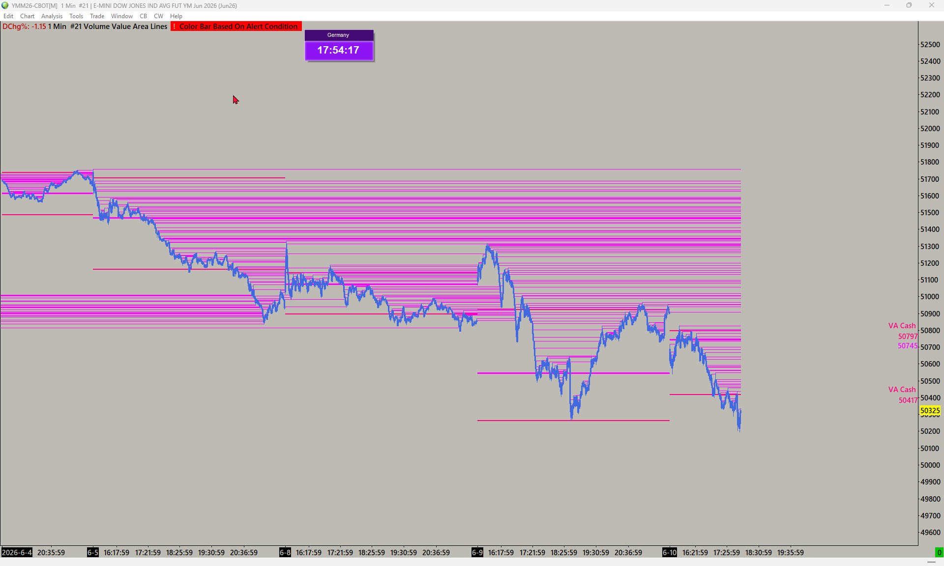

[2026-06-10 15:56:56]
User437588 - Posts: 92
Hallo
Ja das habe ich nun eingestellt. Jetzt sieht der Chart so aus, dennoch werden die VA nicht verlängert.
image2026-06-10_17-54-19.jpg / V - Attached On 2026-06-10 15:56:47 UTC - Size: 429.66 KB - 141 views
[2026-06-10 18:16:43]
You would need a separate "Color Bar Based on Alert Condition" study for each specific subgraph you want to extend. This means you would need a total of 3 coppies of the study for the "Value Area High", "Value Area Low" and "Point of Control".
