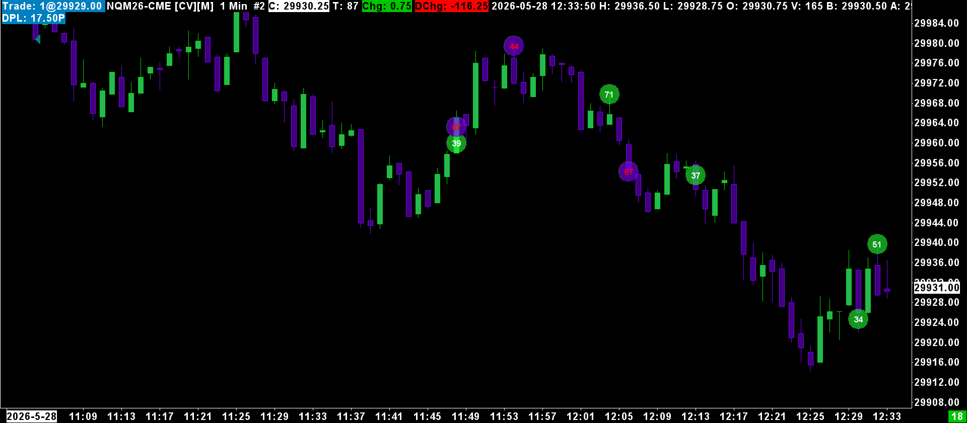

It happened to me several times that when I am watching the actual price in the chart, and a Large Volume Trade marker appears, if I reload and recalculate the chart almost every marker dissapears.

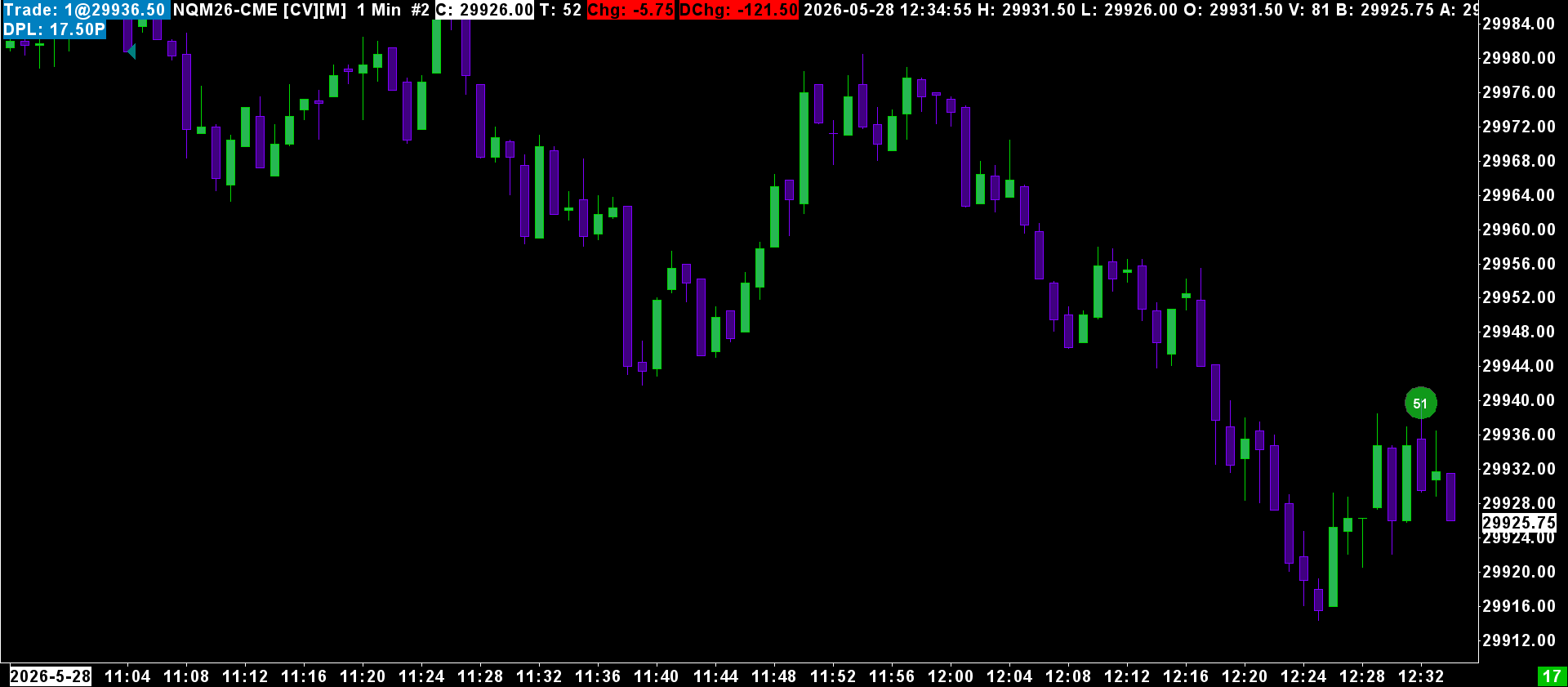

So I made a test making a duplicate of the chartbook. The two of them showed the large volume trade markers that you can see in the first image, but when I reload and recalculate the second chartbook the almost all the markers dissapear.
I tested it several times and it happens every single time.
The combining method I am using is Combine Trades With The Same Price and Type (Bid/Ask), I have the Intraday Storage Data in 1 tick and I am not using the Automatic Combining of Price Levels for Markers.
The only thing different than the normal is that I have a duplicate of the study showing only numbers and no bubbles, to have transparent bubbles with numbers. But I tried it without the duplicate study and the result is still the same.
https://www.sierrachart.com/image.php?Image=1779965043665.png
https://www.sierrachart.com/image.php?Image=1779965108356.png

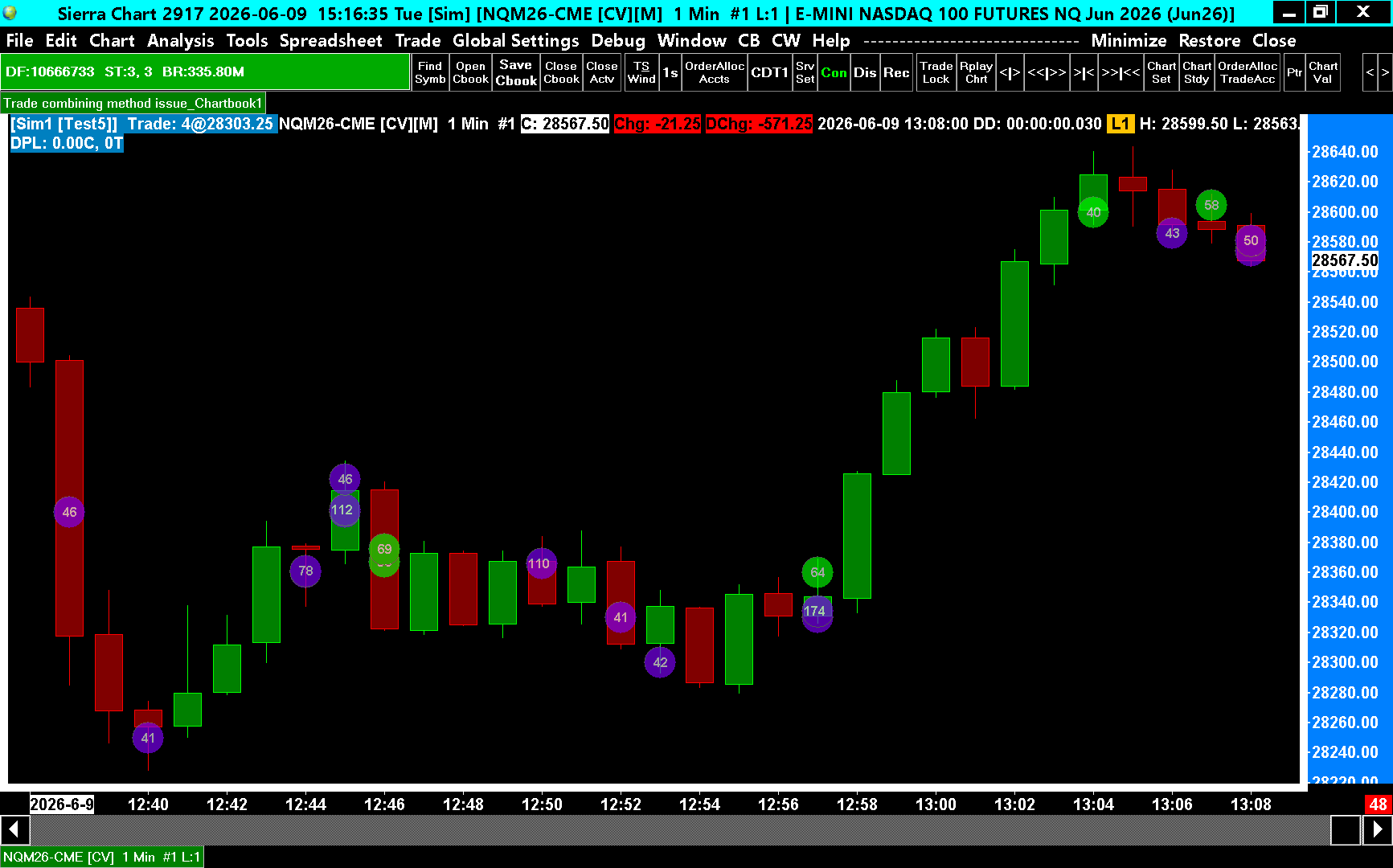

We definitely cannot reproduce this. When we reloaded the chart after several hours, the Large Volume Trade Indicator markers were identical.
Attached is what we saw before we reloaded the chart and all markers were completely identical including the quantity after the reload.
The times at the bottom are US Eastern time.
You really should not be having any problem with this.
imageChart_2026-06-09_151635.png / V - Attached On 2026-06-10 18:47:28 UTC - Size: 41.89 KB - 99 views
