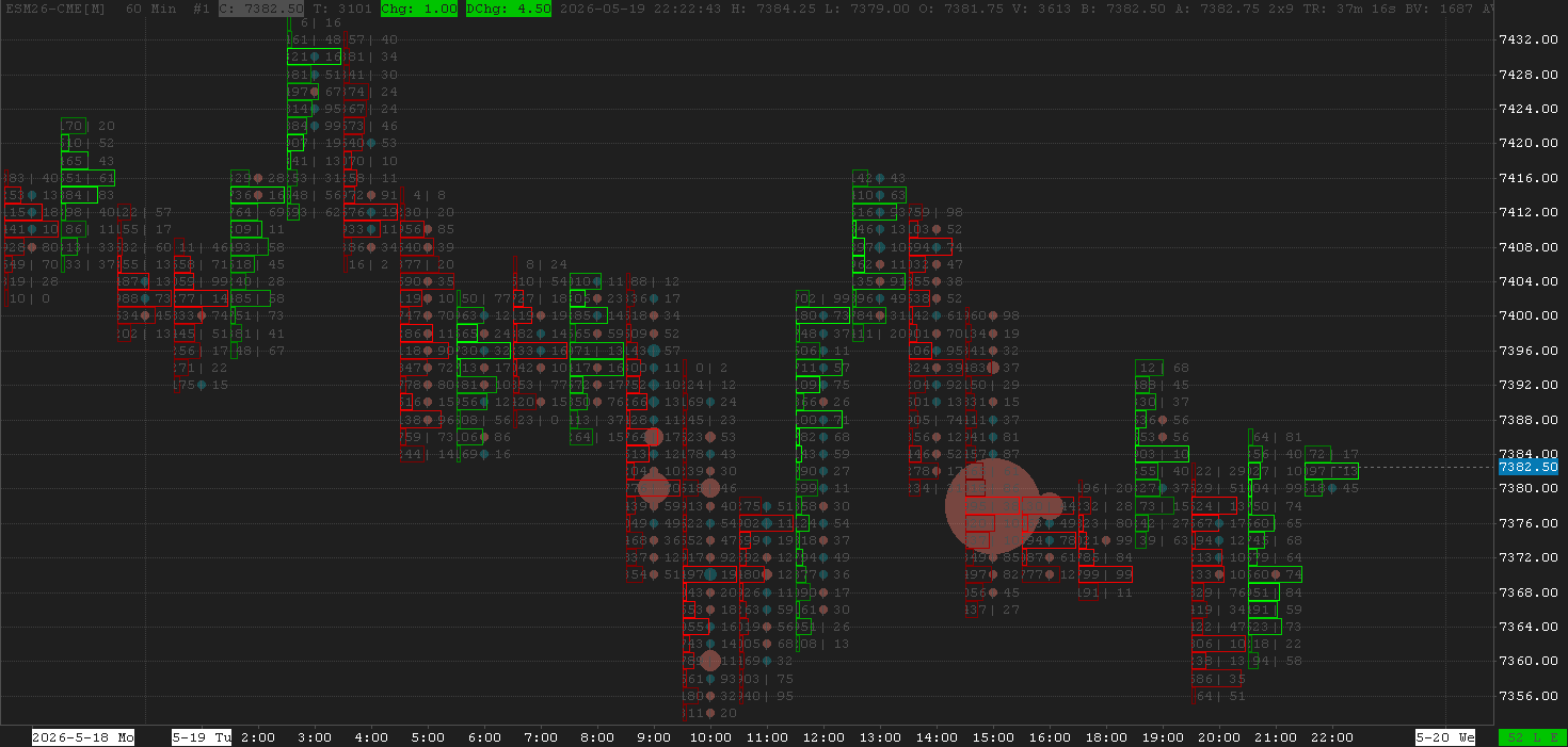

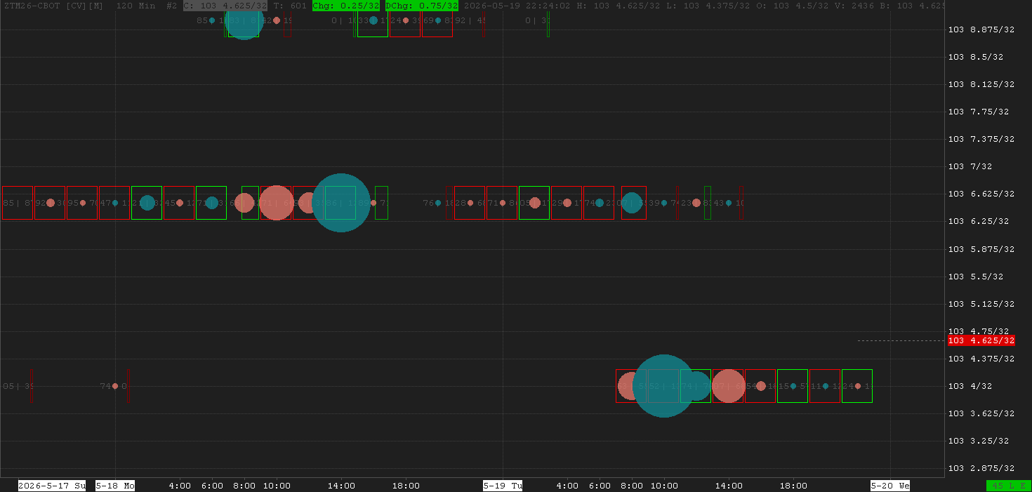

I am having an issue where the Numbers Bars study does not display the Volume Profile bar normally on ZT, ZF, ZN, and QG. The same Numbers Bars settings display correctly on ES. However, when I use the same settings on ZT, the chart does not display the volume profile bars normally. please see attached screenshot

The only issue we see is scaling. You need to adjust the scale so that you can view the various price levels closer together. Refer to the following:
Numbers Bars: Scaling a Numbers Bars Chart
Also, these are not heavily traded symbols, so you will see differences in how much information there is between these and ES.
