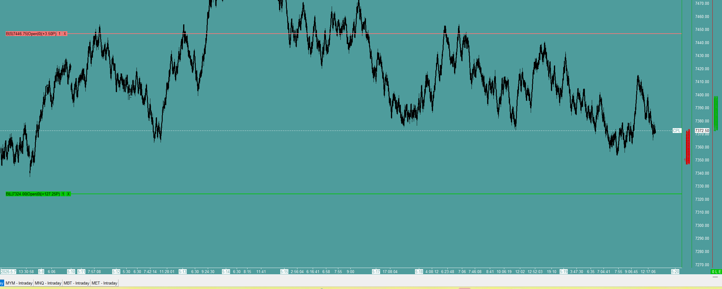

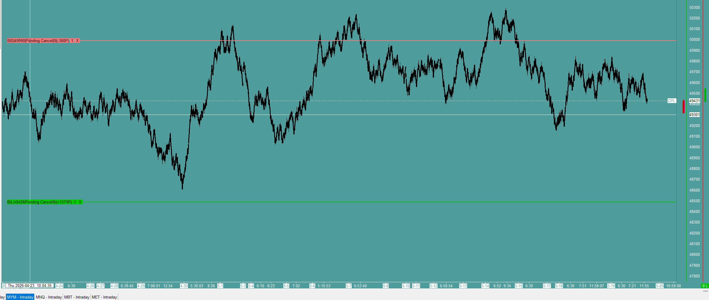

I am using Sierra Chart as my platform to trade with Apteros prop firm. This firm allows you to swing trade overnight into the weekends. I have been experiencing issues with my orders after I close them when holding a position over the weekend.
The problem I have is that I flatten my positions on Sunday at the market open. It then leaves my OCO orders (profit target and stop loss) open. There were a few instances this had happened and I reached out to Apteros support where they had manually closed for me. When I go to my Rithmic Pro orders and manually try to cancel/delete myself, the orders are not pulled. I have tried to use all means to remove these orders on the charts but cant seem to.

Can you let me know what you think the issue might be here? With the open orders hanging, it reduces my position limits meaning I have set it at 5 contracts for MES but with the open orders I can only open 3 contracts because it recognizes those open orders as 2 contracts.

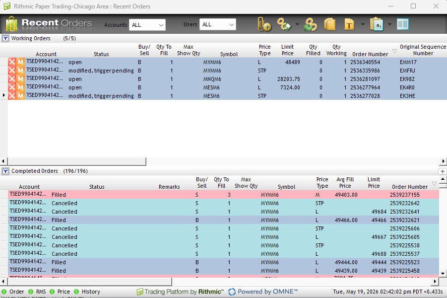

imageRithmic Working Open orders.png / V - Attached On 2026-05-19 21:42:50 UTC - Size: 92.64 KB - 123 views

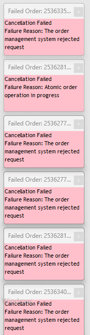

I added the error messages I receive on Rithmic Pro here.

The issue is that Rithmic did not report back properly that those orders were closed. This is not a Sierra Chart issue, the issue lies squarely with Rithmic, as they own the interface between Sierra Chart and Rithmic, and this is a known issue.
The errors you are getting on the Rithmic side are due to the fact that you are sending a Cancel order to Rithmic, but those orders no longer exist on their system.

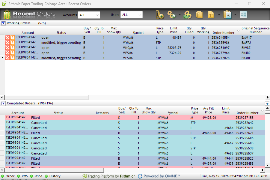

Oxcap - Posts: 81
I reached out to Apteros to have them removed which they did. Therefore, it is no longer showing on my charts nor Rithmic working orders.
I attached a screenshot that provides some details. Does this work?
I am connecting to Rithmic Direct - DTC using the server Rithmic Paper Trading - Chicago Area - Non Aggregated
Account in Rithmic : TSED99041426207
imageRithmic Working Open orders.png / V - Attached On 2026-05-20 19:15:44 UTC - Size: 92.64 KB - 125 views

Oxcap - Posts: 81
I attached a picture that provides IDs of the open orders. Can you use that information to forward to Rithmic to troubleshoot?
