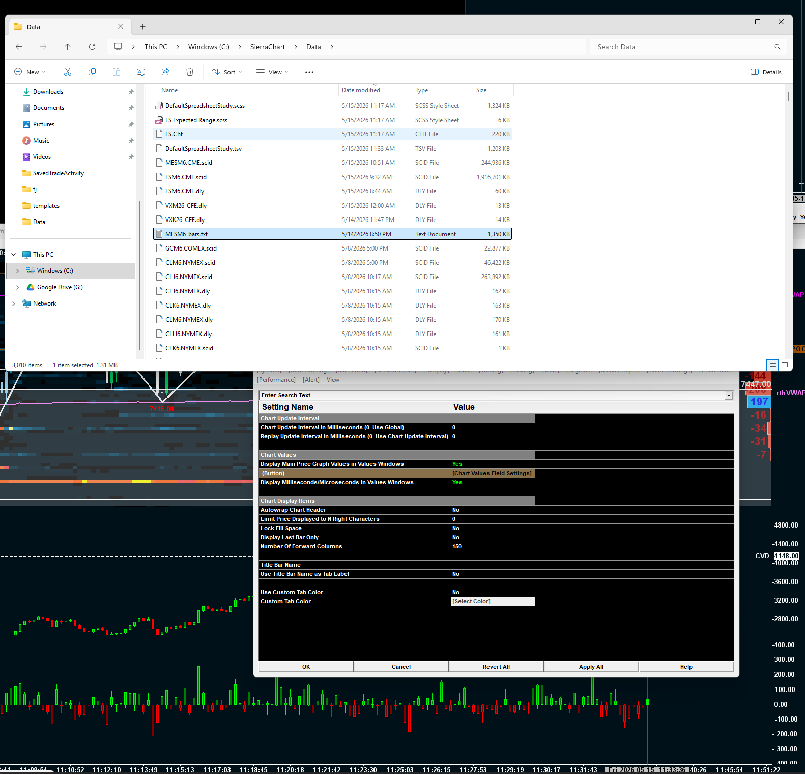

coachted - Posts: 545
ok so i have a chart that is now set to the tick data as per your instrution along wiht the update interval setting and the txt file from write bar and study data to file is not updating..please see image
imageScreenshot 2026-05-15 113343.png / V - Attached On 2026-05-15 15:34:16 UTC - Size: 185.99 KB - 116 views
[2026-05-15 15:41:12]
Sierra_Chart Engineering - Posts: 25491
You have the Chart Update Interval set to 0. Set it to the time interval that you want to have the file updated.
The screenshot you provided, does not tell us at all, whether the file is updating or not. That would be something that you would never be able to show in a screenshot. And there is no reason why that study is not working properly. It is going to be updating the file.

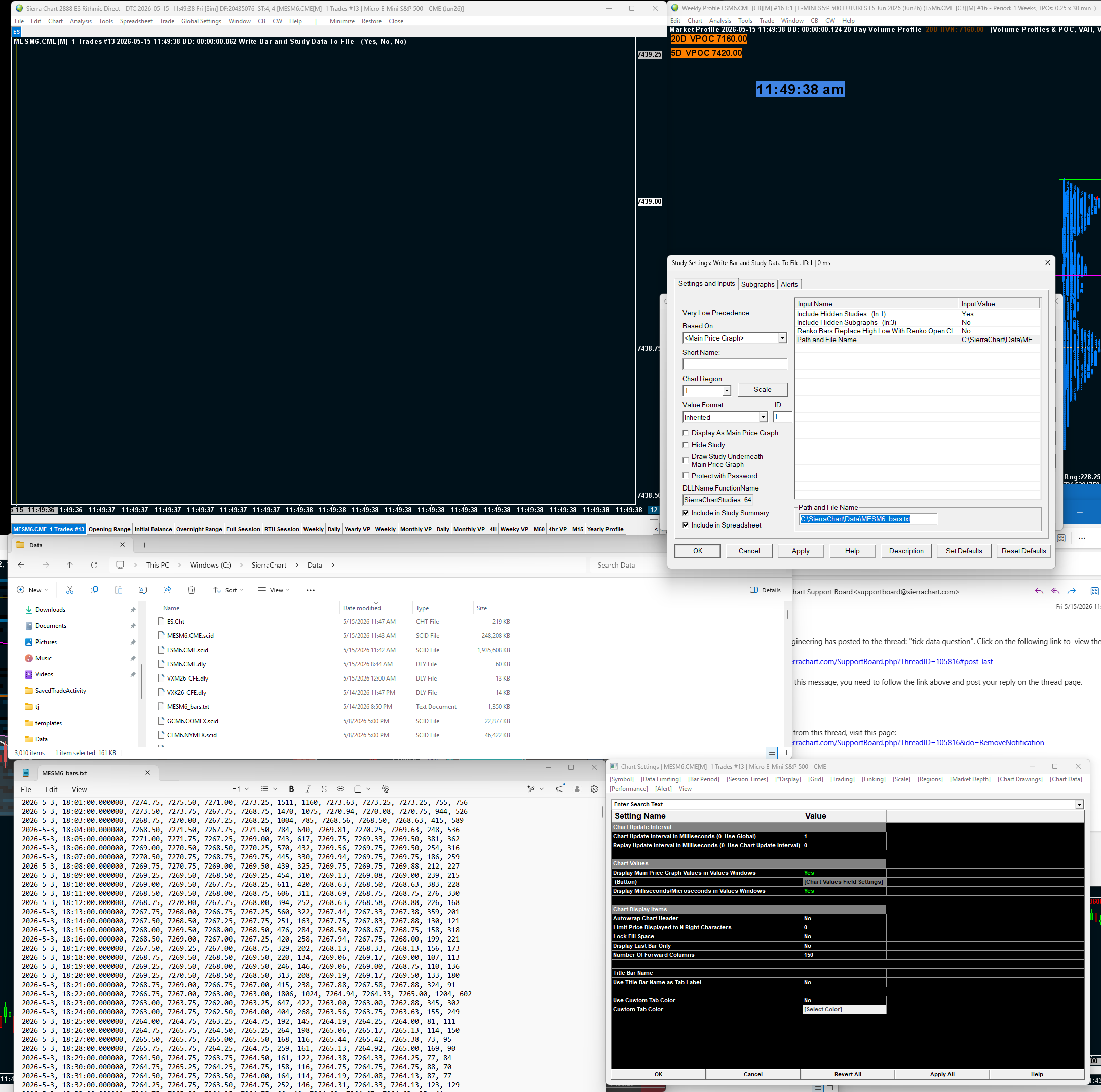

[2026-05-15 15:51:21]
sorry for any confusion here....so here is a picture showing the chart updating, the study with path and a file name, the data file with a MESM6 Bar.txt file which shows date modified as 5/14/2026 @ 8:50 pm, a notepad showing 1 minute data ...the chart shows 1 trade in the tool bar...and finally the update interval setting...
From our perspective and position we do not know what the issue is. We cannot troubleshoot this. The other thing is you did not scroll to the bottom of that text file. So what you are showing us does not mean much of anything.
And it is not something that is really within the scope of our support to help with something like this.
