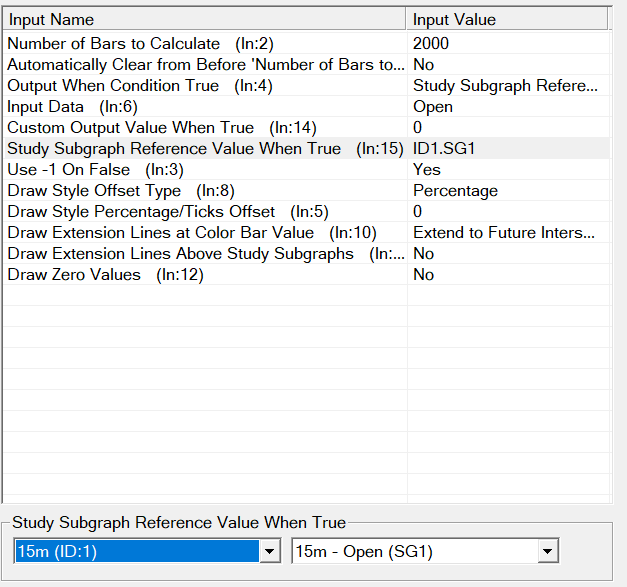

[2026-05-14 18:37:54]
tokauo - Posts: 56
Yes I did. I have attached screen shots.
Thanks you
imageSnímek obrazovky 2026-05-14 203549.png / V - Attached On 2026-05-14 18:37:05 UTC - Size: 37.73 KB - 180 views
imageSnímek obrazovky 2026-05-14 203559.png / V - Attached On 2026-05-14 18:37:11 UTC - Size: 28.54 KB - 189 views

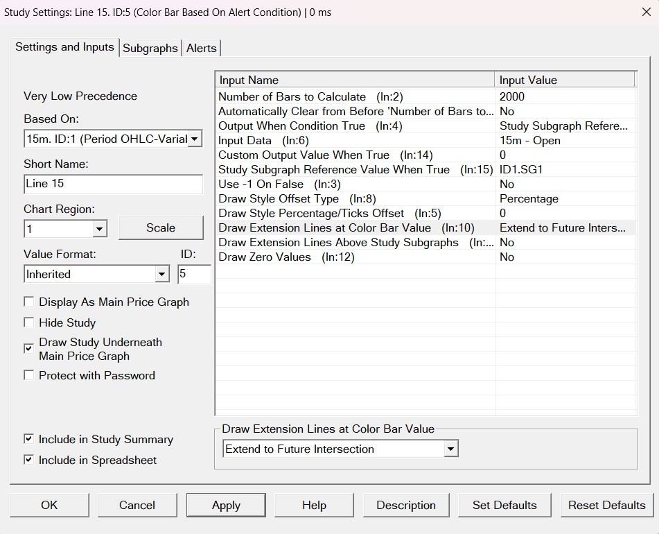

[2026-05-14 19:44:12]
We need to see the entire settings window for the "Color Bar Based On Alert Condition". Not just the Inputs section. Please get us another image that shows the whole window.
[2026-05-14 20:11:13]
tokauo - Posts: 56
Here it is. Thanks you
imageSnímek obrazovky 2026-05-14 220922.png / V - Attached On 2026-05-14 20:11:05 UTC - Size: 70.05 KB - 193 views
[2026-05-14 20:17:31]
You have the "Based On" set to the "Period OHLC", which is why you are getting what you are. You need to set that to "<Main Price Graph>" as it states in the item for "Based On" at the following link:
Color Bar Based on Alert Condition: Creating Extension Lines for Another Study

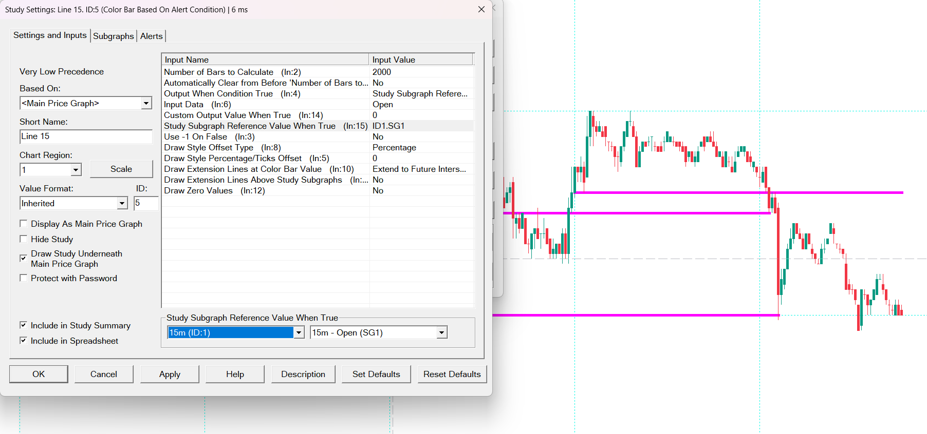

[2026-05-14 20:34:31]
tokauo - Posts: 56
This is how I had it set up initially.
I've made another screen shot with this settings (and with chart) - it is still waiting for another OHLC "Time Period Length" has began and it is crossed...
Am I doing something else wrong?
Thanks you
imageSnímek obrazovky 2026-05-14 222642.png / V - Attached On 2026-05-14 20:30:55 UTC - Size: 103.61 KB - 159 views
[2026-05-14 20:48:11]
You are kind of correct in your conclusion, but not exactly. The issue is that the "Extension Lines" are starting from the end of where the "Period OHLC" is drawing the line. So if that "Period OHLC" line goes across those bars, then the extension line is not going to take those into account - it is only going to stop when it comes across a bar beyond that time period.
What exactly are you wanting to accomplish with this? What is the base information you are looking for that you want to "extend until future intersection"?
Are you just wanting the "Opens" for every 15 minutes? or do you really want the entire OHLC information every 15 minutes? Or something else?
