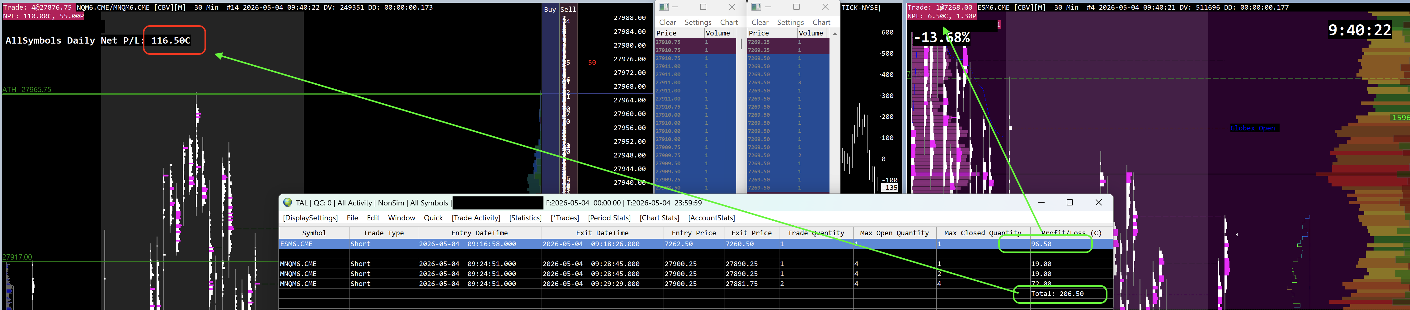

[2026-05-04 14:48:08]
wiivanil - Posts: 14
My chart NPL is incorrect but the Trade Activity Log is correct.
What should I check?
Thank you
Ivan
imageScreenshot 2026-05-04 alle 16.40.22.png / V - Attached On 2026-05-04 14:46:17 UTC - Size: 413.45 KB - 148 views
[2026-05-04 17:48:04]
Please go through the items at the following link:
Help With Daily Profit/Loss Value: Simplified Steps to Solve Incorrect Daily Profit/Loss
[2026-05-05 05:40:53]
I've checked and to me everything is set correctly. Did you see the image attached to the first post?
The trade activity log is correct, only the charts is off.
I've also installed a new Sierra Chart and try on that installation. Something is not right.

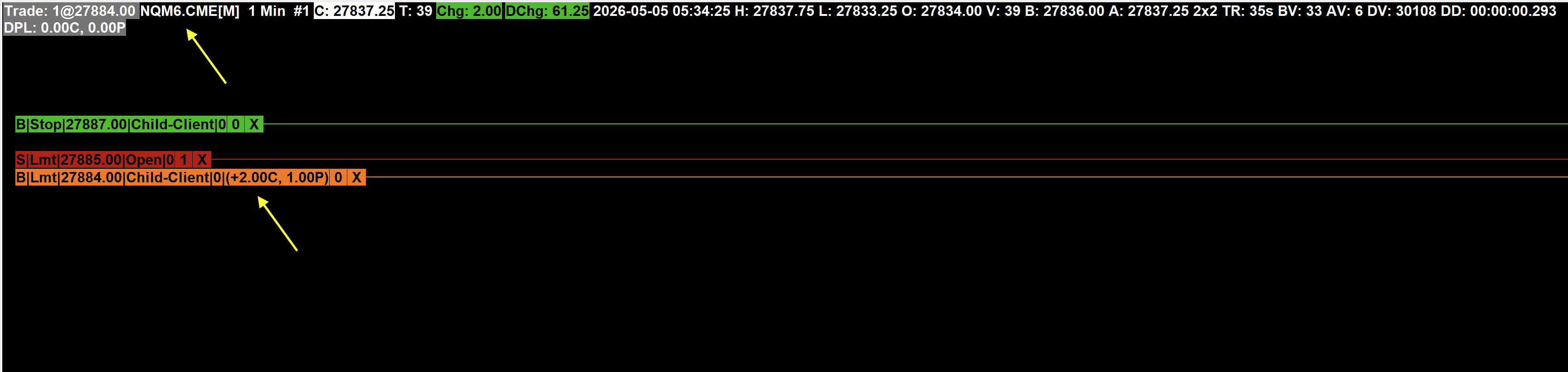

I've opened a chart with a micro symbol, than changed the symbol to mini contract.
The attached order P/L when modifying keep showing the micro value. See attached image.
Thank you
imageScreenshot 2026-05-05 alle 07.34.25.png / V - Attached On 2026-05-05 05:39:07 UTC - Size: 104.21 KB - 162 views
[2026-05-05 14:49:26]
For that chart, check the settting for "Chart >> Chart Settings >> Symbol >> Currency Value per Tick". It looks like this is not set correctly.
