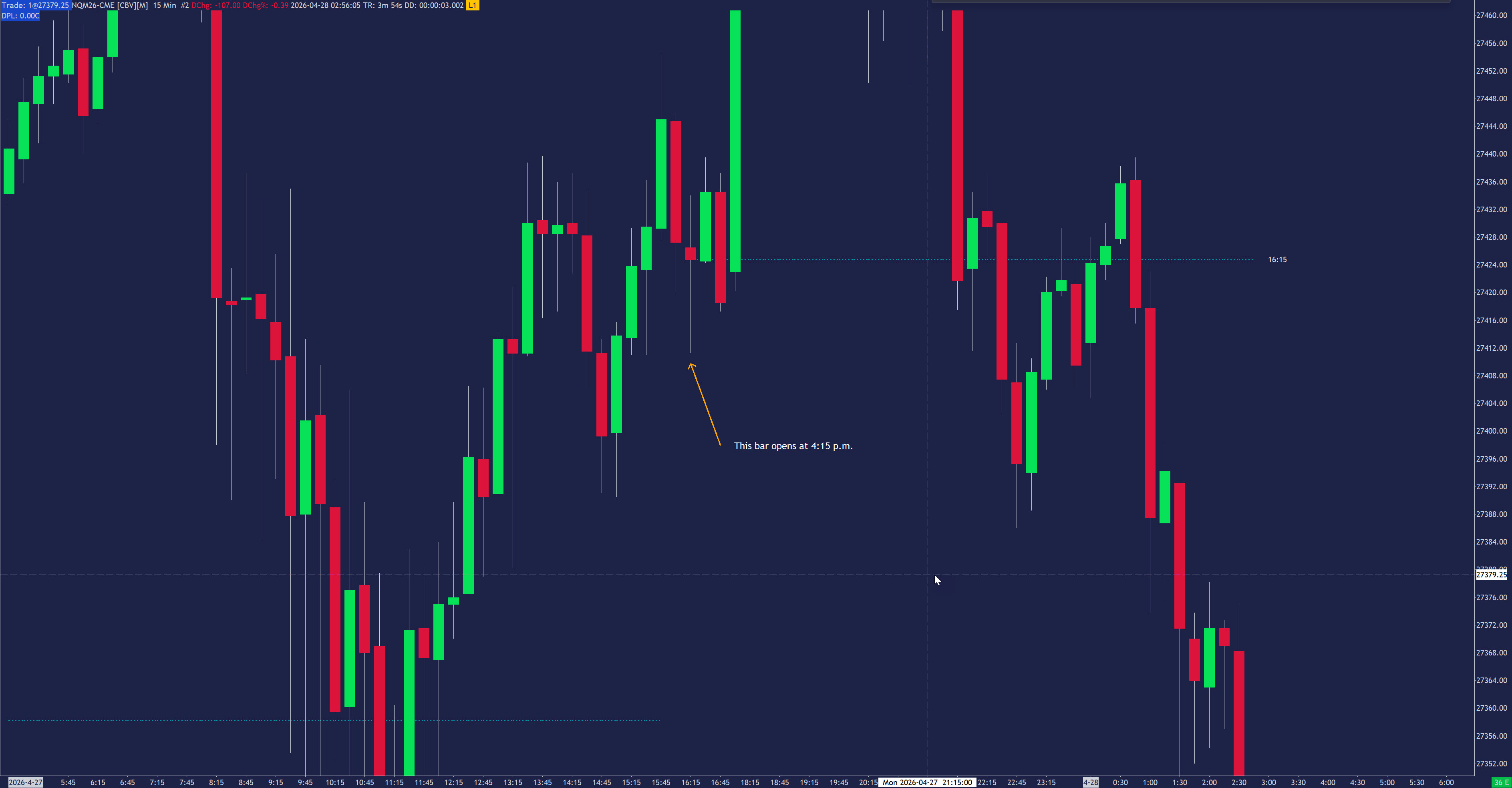

I’m trying to get a line to appear on the chart that marks the market closing price at 4:15 PM. I want the line to be drawn from the bar's closing price at 4:15 PM, regardless of whether I’m currently on a 15-minute, 5-minute, or 1-minute chart.

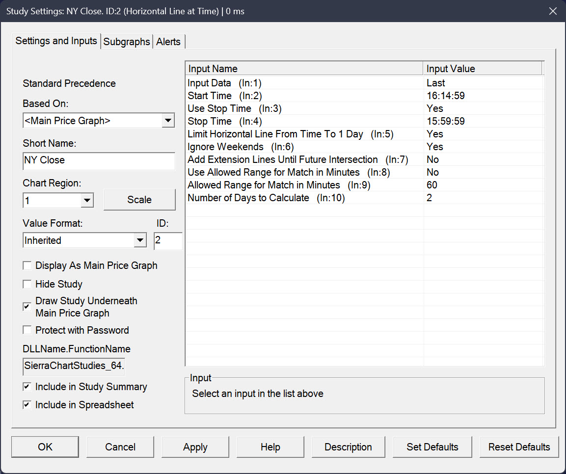

I’m using the Horizontal Line at Time study, but I can’t get it to display the closing price the way I want. My settings are shown in the screenshot.
I set the price to Last and the start time to 4:14:59 PM.
However, based on my settings, the study always displays the closing price of the first bar following 4:15 PM. This means that on the 1-minute chart, it shows the closing price at 16:16; on the 5-minute chart at 16:20; and on the 15-minute chart at 16:30.
Could you please advise me on how to set this up correctly so that the study displays the market closing price at 4:15 PM? Thank you

[2026-04-28 14:39:02]
Sierra_Chart Engineering - Posts: 25489
Use the attached Study Collection. This is the closest we can configure for what you want.
Instructions:
How to Use an Advanced Custom Study or a Study Collection
attachmentHLAT.StdyCollct - Attached On 2026-04-28 14:29:45 UTC - Size: 16.61 KB - 139 views
[2026-04-28 16:48:00]
Daniel - Backtesting.club - Posts: 177
Thank you for the proposed solution.
I know that this study can be set to open at 4:15 PM. But that is usually not the exact closing price.
I also wanted to display the closing price at 5:00 PM (4:59:59 PM) on the chart. In this case, the proposed solution won’t work at all, because once the market opens at 6:00 PM, the price will most likely be somewhere else entirely.
Is there another solution that could display the actual closing prices?
[2026-04-28 18:38:38]
Attached is another study collection that will do what you are wanting. It is setup to display the Close of a bar that contains a time of 15:14:59, so you may need to change the exact time for which you want to have the line drawn. The time is defined in the "Spreadsheet Formula" study that is hidden. It is also setup to only display the line if the time falls within yesterday or today, so you will not get a bunch of lines from previous days.
Use what we have done in this study collection to add other lines as you want.
attachmentLineAtTime.StdyCollct - Attached On 2026-04-28 18:37:46 UTC - Size: 32.26 KB - 129 views
